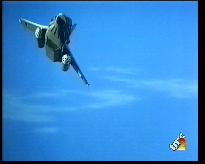

original SD frame (vdub, DAR 4:3 not respected!)
[Attachment 58857 - Click to enlarge]

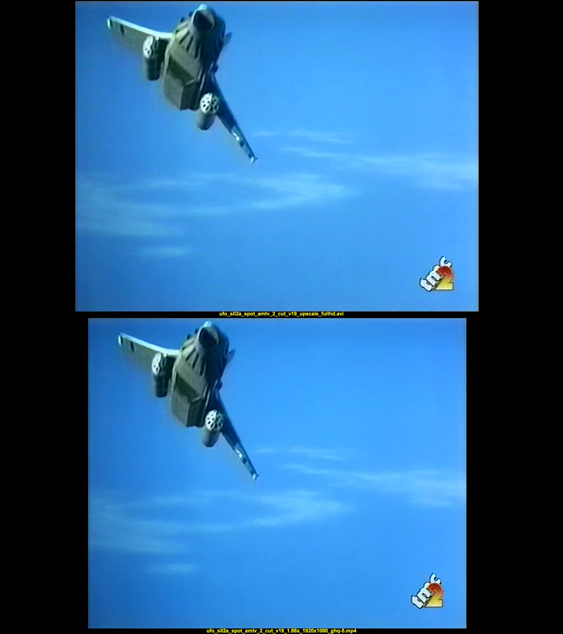

vdub upscale comparison, Topaz on the bottom
[Attachment 58854 - Click to enlarge]

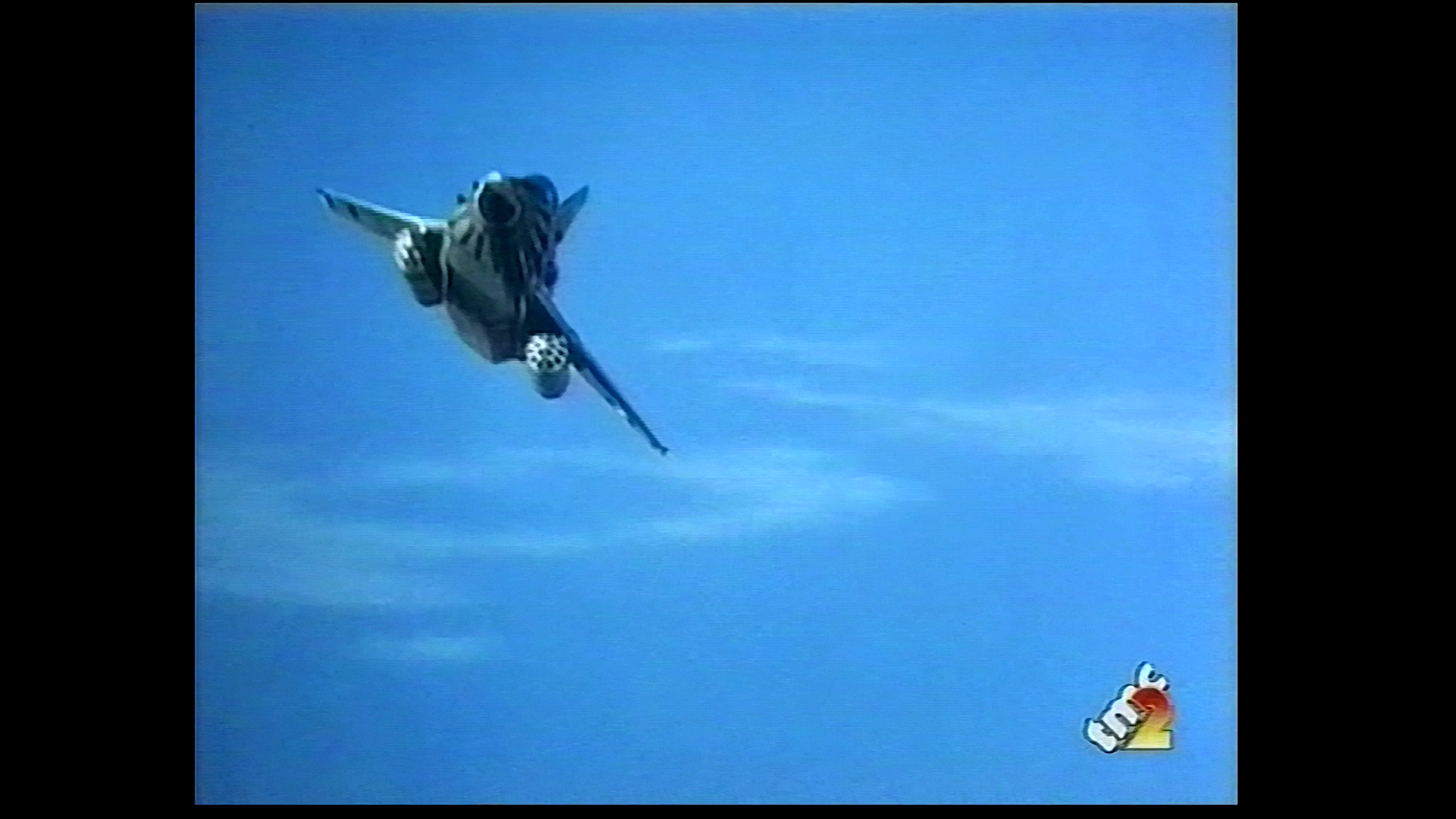

vlc upscale nnedi3_rpow2 + borders
[Attachment 58855 - Click to enlarge]

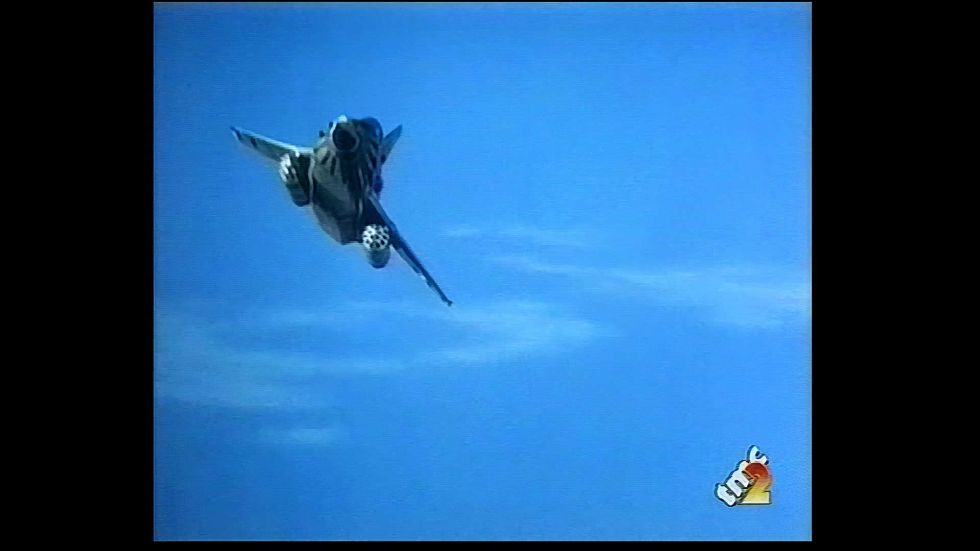

vlc upscale Topaz Video Enhance AI

Topaz is probably not taking the DAR of the source file into account, while you are so doing in the AVS script
I think you are right: Topaz probably tries to read the DAR in the input file. But the input file is an avi generated from HuffYUV capture + AviSynth + Vdub, so the input DAR info is simply missing, and Topaz assumes something else than 4:3 or has a strange 16:9 or whatever else default.
My mistake. I will try to add the DAR info to help Topaz...Last edited by lollo; 14th May 2021 at 04:50.
Update:
from Topaz developer: "The AI processing can’t handle non-square pixels so we have to use the aspect ratio in the metadata to convert to a different resolution with square pixels." Together with the missing DAR info in the input file, this can explain the problem.
Solved forcing DAR on input file; I used ffmpeg -i <file>.avi -aspect 4:3 -c copy <file>_dar.avi

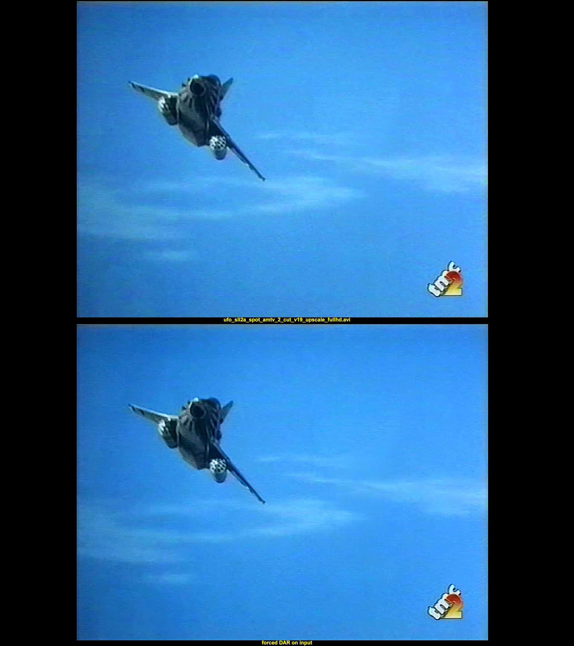

[Attachment 58870 - Click to enlarge]Last edited by lollo; 15th May 2021 at 04:42.
