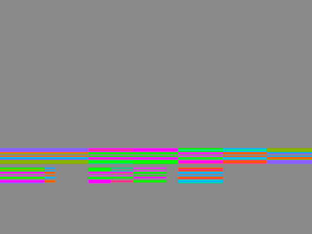

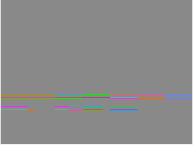

  15. Thank you for your comments.
    Originally Posted by Skiller View Post
    I'm still on classic AVS 2.6.0 so that could potentially be a cause for discrepancies, but if it is I would be baffled as to why there would have been changes in regards to such behavior in color space conversions.
    There has been a long discussion on v 2.58 .... 2.6.0 and chroma placement/format conversion issues here:
    https://forum.doom9.org/showthread.php?t=147629
    I don't know what has been changed or fixed in the meantime. There are chances though.
    You misunderstood me there and I hope the above script emphasizes my point: If you do the conversion from YUY2 to YV12 on field separated video – no matter if you are using interlaced=true or false – the result is incorrect YV12 chroma (that is if the script above produces colored stripes for you as well).
    I see. Now this is what I am getting with your script, for interlace='false' or 'true':
    [Attachment 58978 - Click to enlarge]
    [Attachment 58979 - Click to enlarge]
