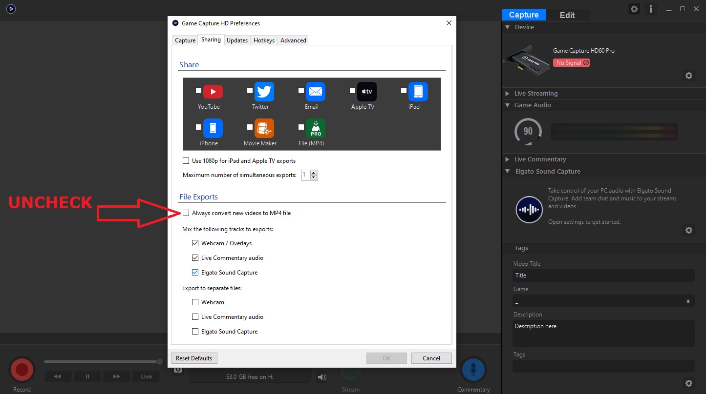

  2. Elgato's own software only saves to very poorly compressed MP4 so I don't want to use that.
    Not correct my friend. Click the very top gear icon next to the i (information) icon.
    With dialog box Game Capture HD Preferences open > click the Sharing tab.
    Uncheck box. Click ok.
    [Attachment 58815 - Click to enlarge]
    The resultant TS (Transport Stream) file produced will be in sync.

  4. Originally Posted by codehound View Post
    Thank you, however I think there's some confusion with ambiguous labelling from Elgato. Mine's a standard-definition RCA-to-USB one labeled "Elgato Video Capture", not the Game Capture HD device. It had its own software that only supports MP4 and no option for raw video, quite different to the one you have shown. Are the software interchangeable perhaps, and if so does it capture raw video?
