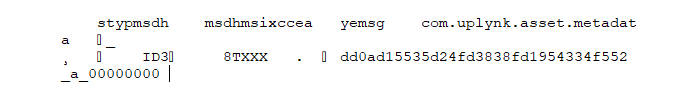

  9. I have to be doing something really wrong, or i am using an old version of MP4Decryt (1.4 Bento V1.6). No matter how i do it, the file gets smaller, and get the following
    [Attachment 58816 - Click to enlarge]
    here is the CMD i am using, the m4f is the format from the DL, but does not matter if i give it a mp4, does the same thing:
    mp4decrypt --key c00ee58fed524d41849c0a0c01488f6b:cf8f5a4225a75ca05b0441eee4e303f9 M.m4f DV.m4f
    it is like the decryptor hits an EOF too soon, since it only has the meta header, or what looks like it anyhow.
