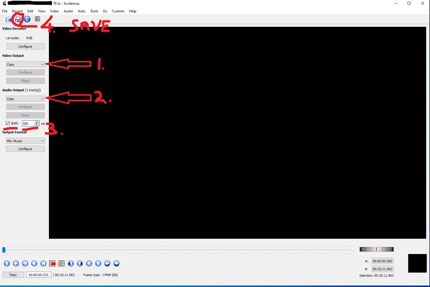

For a video file you have downloaded, if the audio is out of synch at the same rate from start to finish.I have a question. If I have a couple of links to m3u8's and when I go to download the video, the audio is out of sync or late. Is there a reason for this? The original stream is fine, video seems to have no glitches, just a problem with the sound being off. Just curious if anyone has run into this or know how to fix?
If you aren't confident with Ffmpeg from the command line you can fix audio synch issues in Avidemux (free app)
Load video by using the Open function or drag n' drop Video in question into the window.
1. Select Copy Video
2. Select Copy audio
3. Tick the Shift Box. Depending if audio is before or after lip movement - enter positive or negative value here (with a minus sign if negative). Value is in milliseconds so 1000ms = 1 second
4. SAVE
Experiment till you get it correct.
[Attachment 58812 - Click to enlarge] -
