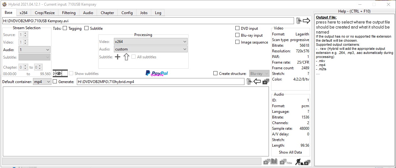

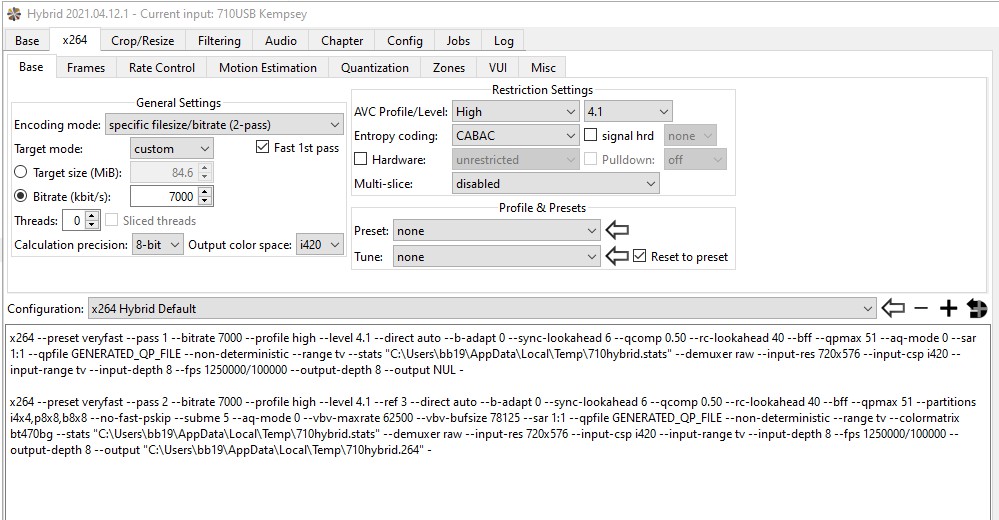

    Using Hybrid version 2021.04.12.1
    My video (a LAGS interlaced AVI from a Vdub VHS capture) is coming out Interlaced. It seems as though QTGMC isn't running, because my processing speed is much faster than I expected. I'm getting around 25fps processing time whereas I was expecting around 5fps at the most.
    Mediainfo is saying my Hybrid output is progressive but opening it in VDub definitely shows it's interlaced, and applying a deinterlace filter removes the jaggies.
    Here are my settings:
    [Attachment 58789 - Click to enlarge]
    [Attachment 58790 - Click to enlarge]
    [Attachment 58791 - Click to enlarge]

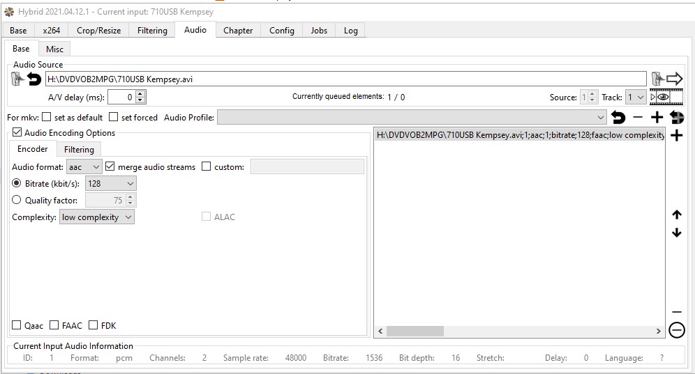

    My VHS capture audio is PCM so I had to set the audio to "Custom" on the Base page, then this on the audio tab:
    [Attachment 58792 - Click to enlarge]
    Output is Interlaced. Any corrections to what I've set would be gratefully accepted.

    You will see in image 58791 the input and output frame rate is the same. Output should be twice the input for bobbing.

    On the Deinterlacing tab, bottom right, one must set "Avisynth" from the "Support:" dropdown (the defualt is Vapoursynth)
    and then back up to top left, choose "QTGMC (Avisynth)" from the dropdown.
    Then it works.
    Also, I set the field order on the Filtering tab (top right): my VHS AVIs were being analysed as Progressive ("Input scan type:") when in fact they are TFF (I assume everybody else's VHS captures are as well), which I set in the drop-down below.
    Thanks for getting me going with this though; I really struggle with Avisynth. The image quality is great but there is an ugly colourisation which I'll post about in a new thread.
    That ties in with the scan type issue above; leave it on Progressive and you'll get 25 with bob. Change it to TFF you'll get 50 with Bob.
