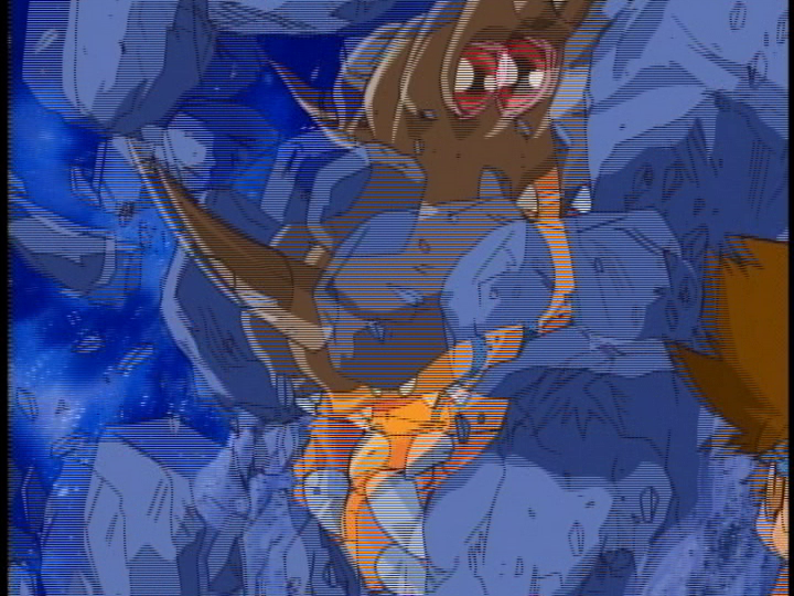

  11. I first use MediaInfo to see if the video is interlaced or progressive. I've read this can sometimes be false and to rely on your eyes to really know. What I do is looking at fast movements in a video and pausing and going through the frames one at a time. It's often immediately obvious.
    An example:
    [Attachment 58787 - Click to enlarge]
    Hope I'm doing it correctly?
    As others have mentioned, interlaced video and telecined films are not the same and have to be processed differently.

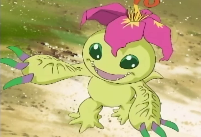

    I've used the QTGMC filter for the first time yesterday. The difference compared to yadifmod2 is incredible:
    Here a basic test example:
    yadifmod2
    [Attachment 58801 - Click to enlarge]
    QTGMC
    [Attachment 58802 - Click to enlarge]
    Thank you, jagabo, for recommending it to me

    I took a look at it, used Avidemux to re-wrap it to program stream Mpeg so I can use DGindex.
    There is still some minor combing visible after tfm().tdecimate(), eg. frame 101
    Overall the video quality seems poor, fuzzy and soft
