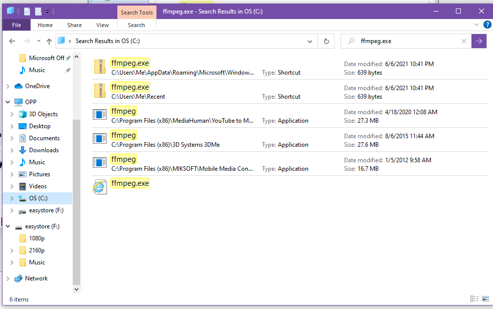

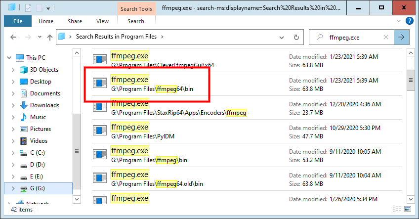

  18. I highly doubt "g:\program files\ffmpeg64\bin\ffmpeg.exe" is where ffmpeg.exe is on your computer. Edit the batch file, change that to the right location, and save.
  19. You are speaking to someone who is at best help desk tech. i do not know scripts nor codes. So you have to be specific. Is the path supposed to be C://ffmpeg.exe or C://users/Desktop/ffmpeg.exe
  20. I don't know where you installed ffmpeg so I can't tell you the full path to the program. You can search for it with Explorer. Assuming it's on drive C: -- select that drive in Explorer and search with CTRL+F (find). Type in ffmpeg.exe and press ENTER. You'll see something like:
    [Attachment 59312 - Click to enlarge]
    I searched drive G: because that's where I have it installed. That drive also has many other programs that use their own private copies of the program. I highlighted the one I used in my sample batch file.
  21. Please type in notepad exactly what it should say and I will erase and paste.

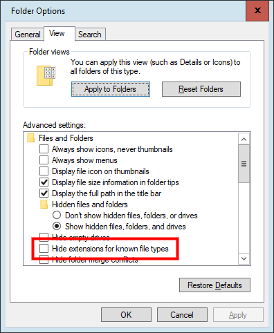

  22. First, I highly recommend you turn off Explorer's Hide Extensions For Known File Types option. From Explorer select View -> Options then disable that item:
    [Attachment 59326 - Click to enlarge]
    You'll now be able to see the extensions of all your files -- one of the most critical things to see about files.
    It doesn't look like you installed ffmpeg. But you have three programs that include versions of ffmpeg.exe. Two of them are only showing partial paths, ...MediaHuman... and ...MIKSOFT... But the third one shows the full path "C:\Program Files (x86)\3D Systems 3DMe\ffmpeg.exe". The file size is pretty small so it's not a full build (ffmpeg is a vary complex program with many functions -- some builds only include some of the features). It's probably enough for trimming out a segment of an MKV file.
    So you did not tell me what to type in Notepad if what I have is sufficient.
    I have file types on the folder view as a column if that makes sense. I changed it though.

  25. If I don't understand what to type in notepad than I can not go forward. Obviously I don't. So type it again exactly how notepad should look simple as cut and paste. Don't expect me to know where to edit the code in notepad. As well if you want to look at the file, it's up to you. I can almost guarantee you there is nothing wrong with it. I'm not into learning new things to send you the file or writing codes in CMD. I'm not that computer literate.
  26. Code:
    "C:\Program Files (x86)\3D Systems 3DMe\ffmpeg.exe" -i %1 -ss 00:00:00.000 -to 00:05:00.00 -map 0 -c copy "Trimmed.mkv"
    pause
  27. Originally Posted by jagabo View Post
    pause
    Cool. It's worked.
