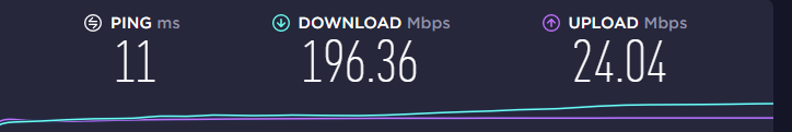

  6. It's hitting higher peaks on different speed tests but coming back down and recording that as speed. My tv just lost connection twice I think this is a bad router, or it needs to be set up different. It is too intermittent. I still don't get the Kodi bit rate problems though.
    [Attachment 59071 - Click to enlarge]
  7. Originally Posted by forsure View Post
    Those numbers look good. There doesn't seem to be any reason why you would have problems. Maybe the router is bad or set up incorrectly, as you surmised.
    I used a program called Speed Test WiFi Analyzer Analiti on the Chromecast (from the Google Play Store). If you scroll down the list of options on the left you'll find iperf3 client and server. I used the command line version of iperf3 on Windows. I'm sure you can find a GUI version somewhere.
    You run one in server mode (start this one first) the other in client mode. Enter the server's IP address in the client version so it knows which server to connect to. The client will then connect to the server and start the WiFi speed test.
    I recommend you run iperf3 on the Chromecast in server mode. It will show you the Chromecast's IP address, something like 192.168.1.2. Then go to the Windows computer and start iperf3 in client mode. For the command line version you would type "iperf3 -c 192.168.1.2" -- use the IP address of your Chromecast.
  8. Originally Posted by jagabo View Post
    That seems complicated. What am I testing again, that the speed test ran by Chromecast to router did not tell me? That screen shot in previous post, is pc to router.
