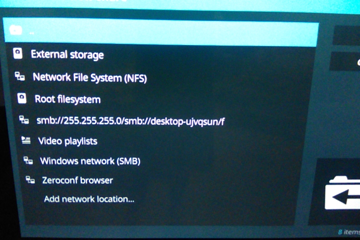

    What KODI version do you have? I don't see it like that.. It asked me for server address (like an ip number and path? Ok I will try to manually add.
    I typed smb://Desktop-Ujvqsun/f
    I don't hit ok until after I entered username/pass. It said incorrect parameters. I think you have older version. I am trying to install older version, it wont download the add on for Downloader app to search internet to dl old version on CGTV.
    Ok was able to install older version. it loads the same way. Add network/ server address/ server path/ user name/password. I typed 10.0.0.208 in first field, smb...in server path and it said "invalid argument"
    Now I am getting error connection timed out I changed my server address to mac address rather than ipv4 address. I can send you a photo of what mine looks like if yours looks different.

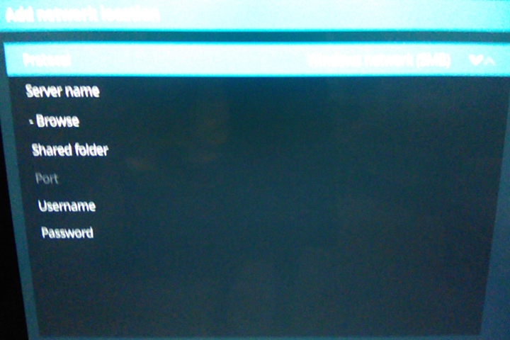

    I just reset and setup an old Android TV device I had sitting on a shelf. To access videos in Kodi all I had to do was go to Videos -> Files -> Add Videos. Then manually enter smb://servername/sharename (use your server and share name) and select OK. It asked for a username and password -- use the username and password you use in Windows. After that it allows you to scrub for metadata or not. And then you can access files via Videos -> Files -> sharename. Alternatively, you can add smb://servername only. Then you can select all the shares on that server with Videos -> Files -> servername.
    This is what I see it asks for server name and then server path or shared folder, then user name and password. Dont you have to enter an address for server name. It just told me a different error message ( i forgot) on the new ip address used? Which numbers do I use if I have to according to this? How many times do I type in smb:// in 1st column or second or both?Image

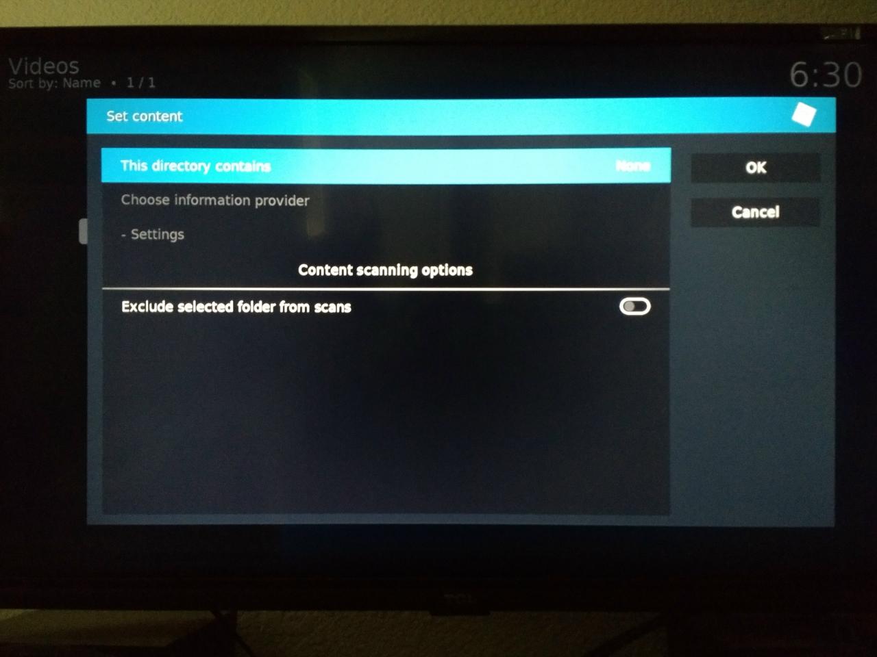

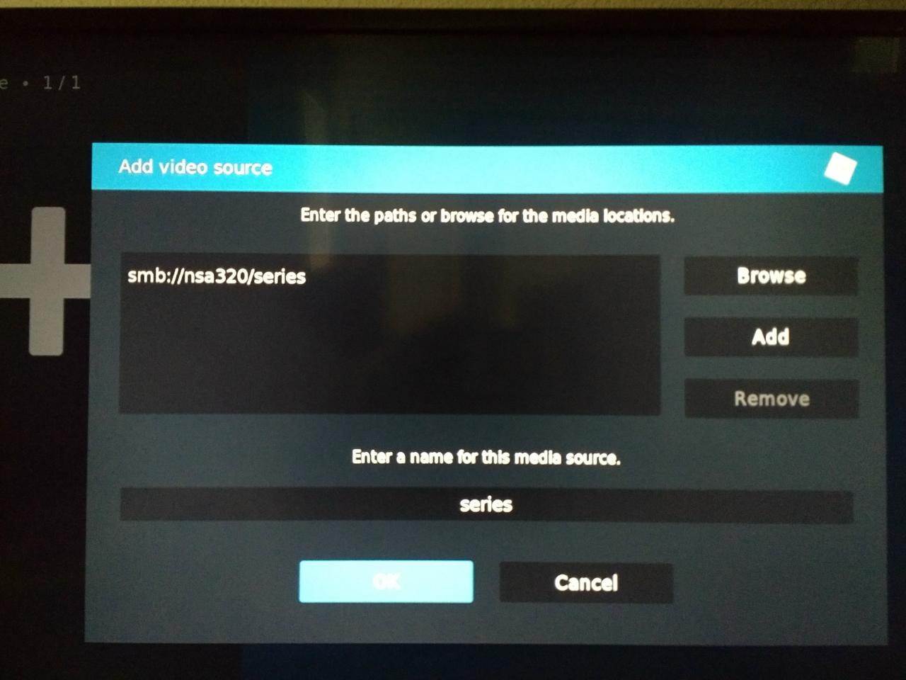

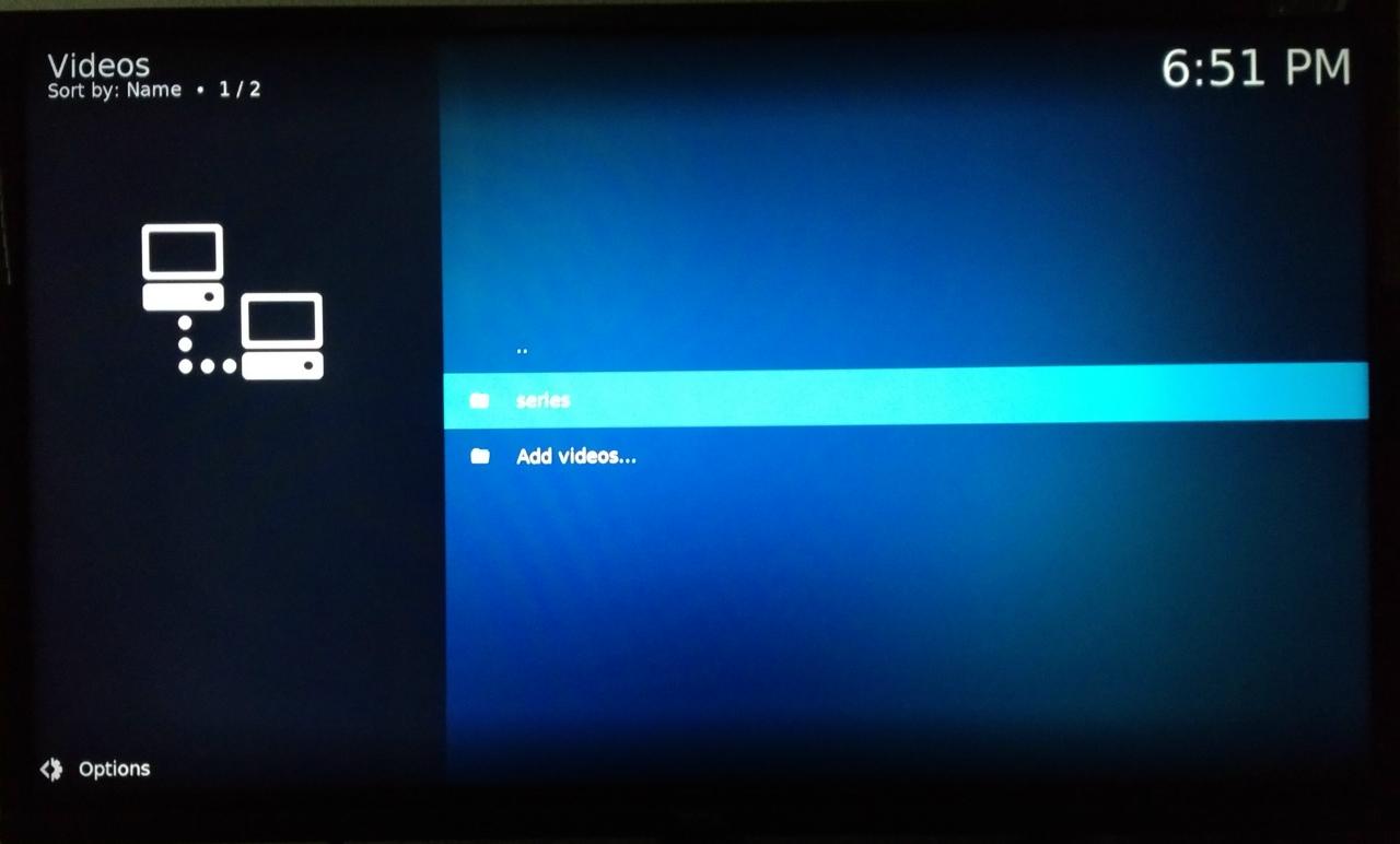

  11. Here's what I get after Videos -> Files -> Add Videos:
    [Attachment 58940 - Click to enlarge]
    I'm pretty sure after pressing OK on that dialog I get the username/password dialog. It didn't ask here because it remembers the username/password from accessing the server earlier. After pressing OK I get:
    [Attachment 58941 - Click to enlarge]
    If you leave it at This Directory Contains -- None it will not look for metadata when you press OK (and it will not take long to complete). Then back at Videos -> Files... you get:
    [Attachment 58942 - Click to enlarge]
    And from there you can browse the share.
    These photos were of from the old Android TV device and an old version of Kodi. But the dialogs haven't changed much, if at all.

    I can not get that far with assigned folder only empty folder , remember it said that screen with content for movie info, it did not ask for password, flashed screen about will take a while and did nothing, so it must not be connected to any drive to, it does not show progress bar in right corner only clock. It does not display path info after smb://. Don't you see where it asks me for server name and shared folder, that is the only way to manually add and then it asks for user name / password. I can see shared folder, but there is nothing in there and no continued path just smb://
    Ok I added the path from the choice that says windows smb rather than add network, and still got error message. I got error operation not permitted. The path was in selection of add windows (SMB)rather than add network. It was typed as path is in shared folder except for smb:// DESKTOP-UJVQSUN/2160P OR I have used the drive "/f" instead of folder (2160p). It still will not take it. This has been all day headache. not easy at all.
