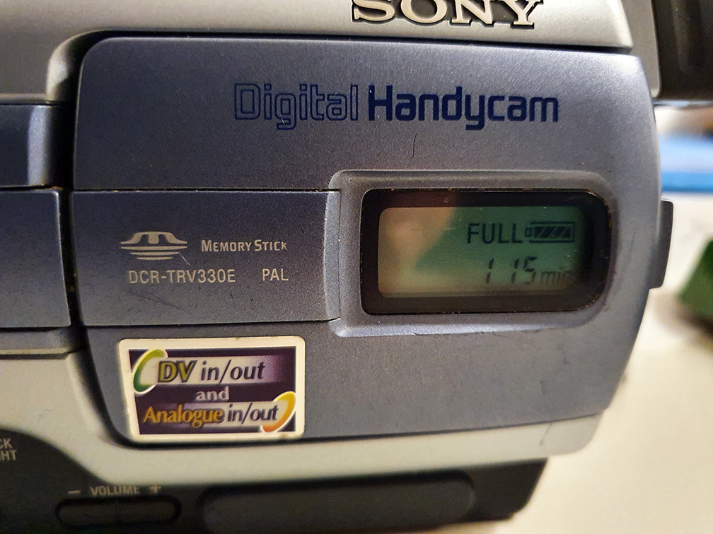

    Have bought Sony DCR-TRV 330E camcorder to transfer old Sony Video8 tapes to PC.
    Installed PCI E ieee1394 card to connect camcorder via "i.link" to computer. However, camera is not visible to computer nor to video capture software, ScenalyserLive, WinDV 123, VirtualDub.

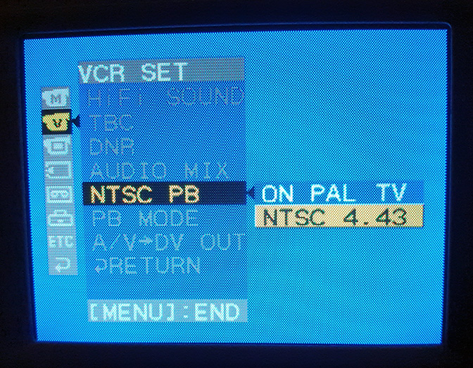

    On the NTSC question, in the menu of the camera there is an "NTSC PB" heading which gives a choice of setting either to "ON PAL TV" or "NTSC 4.43" The camera is set to the "ON PAL TV" setting. I think this is the default setting.
    The camera is a PAL one bought second hand here recently. My Video8 tapes were made in a Handycam bought in the USA in 1990.
    Hope this helps to clarify. Unfortunately, I doubt this is the source of the problem here.

    I also doubt that is the issue but even if and when you get the card to work you will come across the following.
    Playback of NTSC tapes (which you have) on a PAL player/camera (which you have) is an analog feature. I may be wrong with this and a user manual might confirm but NTSC playback is not supported for DV playback - it certainly does not work with my Canopus ADVC which expects either a pure NTSC or pure PAL source.
    And NTSC 4.43 is also not a pure NTSC system
    Now you can still use the camera but will have to transfer the video in analog/composite mode with a capture device that supports PAL60 such as a Hauppauge USB-Live2.
