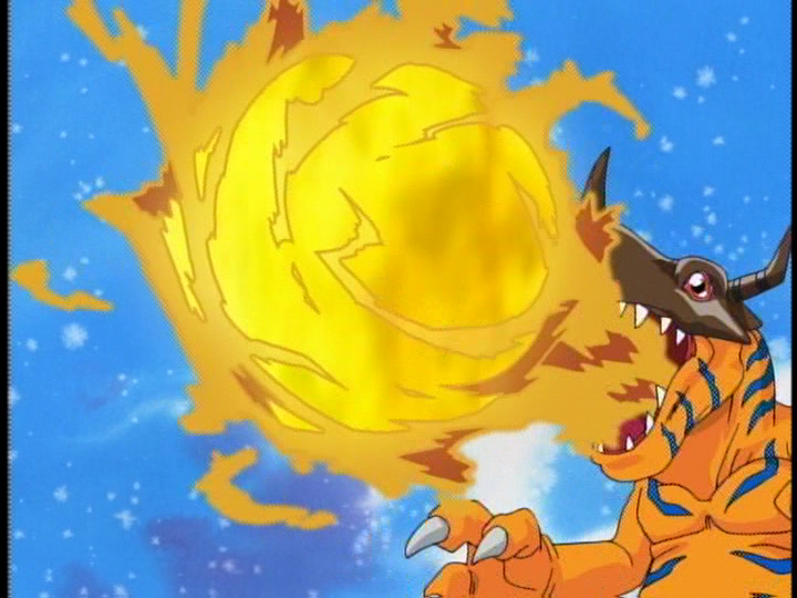

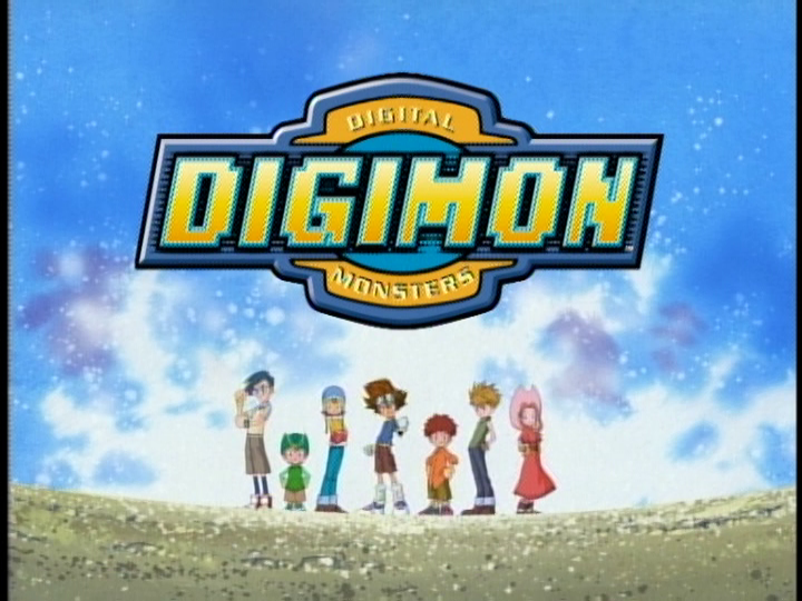

I recently got Digimon on DVD and this is what results I get playing it in a video player:
[Attachment 58732 - Click to enlarge]
[Attachment 58733 - Click to enlarge]
I'm talking about the strange artifacts in the Digimon logo in the first photo and around the fireball in the second photo.
Tried de-interlacing with handbrake, but the result stays similar. I'm new to this, so I have no idea what this is called and how to solve it. If anyone can help me, I would greatly appreciate it.
Thanks in advance.
Results 1 to 21 of 21
It's called Dotcrawl. Its origin is from luma/chroma crosstalk on composite video. There are avisynth filters to suppress it, but it may be tough.

Use the 'S-Video' or 'Component' connection if you have it instead of 'Composite', as luma and chroma are separate in S-Video or 'Compoment' connections.
It may however be that the Dotcrawl is already burned in the DVD source from a poor transfer.Last edited by Sharc; 5th May 2021 at 12:01.

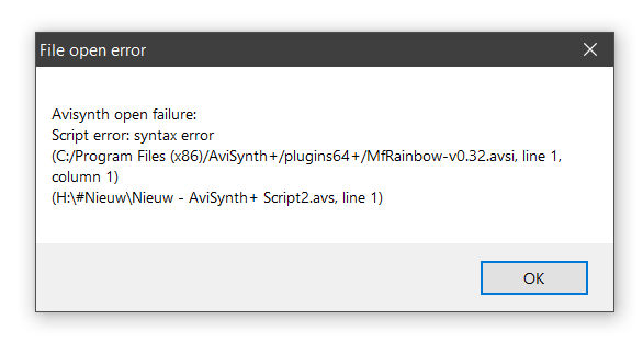

I managed to get a checkmate filter working, as well as a de-interlacing filter. The de-rainbow filter doesn't work though.
To explain:
I tried the following filters:
DeRainbow
DFMDeRainbow
RainbowSmooth
These all give a syntax error, as shown in the photo below.

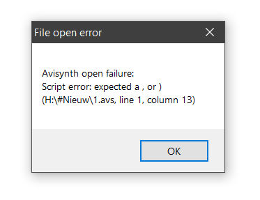

This is what I used for DeRainbow, to test the filter out:
DirectShowSource("H:\#Nieuw\Digimon Digital Monsters - S01E01 (001) - And So It Begins....mkv")
DFMDeRainbow(maskthresh=10, mask=false, interlaced=false)
When I do that, I get the following error:
[Attachment 58758 - Click to enlarge]
Apologies for being a moron. Can't seem to figure out what I'm doing wrong. If someone would be so kind to help me, I would greatly appreciate it. Thank you. -
Did you install the support filters that DeRainbow() etc. require? You can see the requirements on the pages you linked to. For example, DeRainbow requires masktools2, MipSmooth, and MSharpen.
Yes, getting all the required filters set up can be a PITA. -
Is that # as part of the folder name valid ?
I thought that using # on a line commented out every else on the line. So in that scenario the filename is not read. -

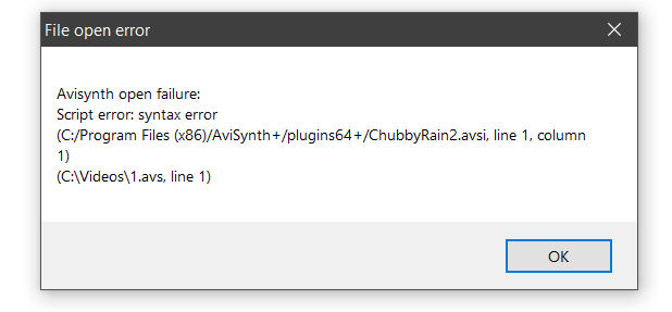

I tried this script:
LoadPlugin(C:\Program Files (x86)\AviSynth+\plugins64+\Bifrost.dll)
LoadPlugin(C:\Program Files (x86)\AviSynth+\plugins64+\CNR2_x64.dll)
LoadPlugin(C:\Program Files (x86)\AviSynth+\plugins64+\masktools2.dll)
Import(C:\Program Files (x86)\AviSynth+\plugins64+\ChubbyRain2.avsi)
DirectShowSource("H:\Digimon Digital Monsters - S01E01 (001) - And So It Begins....mkv")
ChubbyRain2(th=10, radius=10, show=false, sft=10, interlaced=true)
This gives me the following error:
[Attachment 58760 - Click to enlarge]
No idea what this means. Tried google to find a solution, but can't find anything
Edit: I put the file in a different folder, without a # in it's path. Same result, the above error. -

I added the parenthesis, now I get a different error:
LoadPlugin("C:\Program Files (x86)\AviSynth+\plugins64+\Bifrost.dll")
LoadPlugin("C:\Program Files (x86)\AviSynth+\plugins64+\CNR2_x64.dll")
LoadPlugin("C:\Program Files (x86)\AviSynth+\plugins64+\masktools2.dll")
Import("C:\Program Files (x86)\AviSynth+\plugins64+\ChubbyRain2.avsi")
DirectShowSource("C:\Videos\Digimon Digital Monsters S01E01.mkv")
ChubbyRain2(th=10, radius=10, show=false, sft=10, interlaced=false)
ChubbyRain2 is also in red in AvsPmod. Very strange. Almost like it's in the wrong folder. I tried them all.

Is there something wrong with ChubbyRain2.avsi ?
Post the script here -
Dll files in the plugins folders should load automatically. You don't need to manually load them. Same with AVSI file, they should import automatically. There are some people that have problems with that (probably something wrong in the Registry).
AVSI files are plain text. Open ChubbyRain2.avsi in notepad. Does it look correct?
Code:# http://avisynth.nl/index.php/ChubbyRain2 function ChubbyRain2(clip c, int "th", int "radius", bool "show", int "sft", bool "interlaced") { #based on Mug Funky's ChubbyRain th = default(th,10) radius = default(radius,10) show = default(show,false) sft = default (sft, 10) interlaced = default(interlaced, false) c = interlaced==true? c.separatefields() : c u = c.utoy() v = c.vtoy() uc = u.mt_convolution(horizontal="1",vertical="1 -2 1",Y=3,U=0,V=0) vc = v.mt_convolution(horizontal="1",vertical="1 -2 1",Y=3,U=0,V=0) cc = c.mt_convolution(horizontal="1",vertical="1 2 1",Y=2,U=3,V=3).bifrost(interlaced=false).cnr2().temporalsoften(radius,0,sft,2,2) rainbow = mt_lutxy(uc,vc,Yexpr=string("x y + "+string(th)+" > 256 0 ?")).pointresize(c.width,c.height).mt_expand(y=3,u=-128,v=-128)#.blur(1.5) overlay(c,cc,mask=rainbow) output = show==true? rainbow : interlaced==true? last.weave() : last return output } -
No, mine has the following code
WeirdCode:<!DOCTYPE HTML PUBLIC "-//IETF//DTD HTML 2.0//EN"> <html><head> <title>404 Not Found</title> </head><body> <h1>Not Found</h1> <p>The requested URL /images/ChubbyRain2.avsi was not found on this server.</p> </body></html>
It clearly does not like that first line wherever you store the script.

That's an html error page -- there was an error when you tried to save the script with your browser.
You can copy/paste from the code block in post #13. Note that importing an AVS or AVSI script is the same as copying text from that file and pasting it into main script. -

Thank you all for your wonderful help and support.
I copied the code of the avsi files on the website to a txt file and changed it to avsi afterwards. This worked! Yay!
The ChubbyRain2 filter is working now!

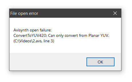

I tried using LSMASH and video works, but I don't get any sound with the following script:
Tried adding LWLibavAudioSource and pointing to the same file, but that gives an error:Code:LWlibavVideoSource("C:\Videos\Digimon Digital Monsters S01E01.mkv") ConverttoYv12() ChubbyRain2(th=2, radius=2, show=false, sft=2, interlaced=false) CheckMate(thr=25, max=25, tthr2=10) yadifmod2(order=1, field=1, mode=1)
[Attachment 58766 - Click to enlarge]
Am I doing something wrong? Thank you. -
LWlibavVideoSource() only gives you video. If you want audio too use LWlibavAudioSource():
Without knowing more about your source it's hard to say exactly what the problem is. Instead of ConvertToYV12() try forcing YV12 output from the video decoder:Code:a = LWlibavAudioSource("C:\Videos\Digimon Digital Monsters S01E01.mkv") # get the audio v = LWlibavVideoSource("C:\Videos\Digimon Digital Monsters S01E01.mkv") #get the video AudioDub(v,a) # join them together ConverttoYv12() ChubbyRain2(th=2, radius=2, show=false, sft=2, interlaced=false) CheckMate(thr=25, max=25, tthr2=10) yadifmod2(order=1, field=1, mode=1)
Code:v = LWlibavVideoSource("C:\Videos\Digimon Digital Monsters S01E01.mkv", format="YV12") #get the video -
