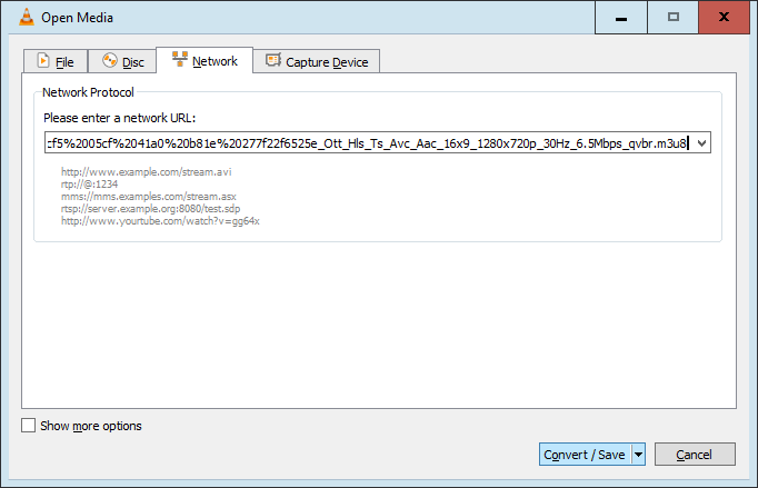

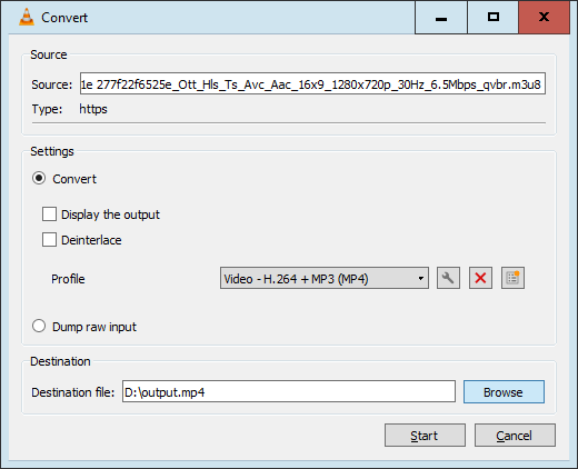

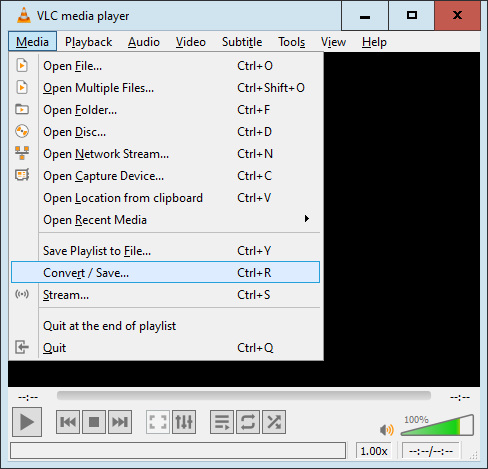

  22. I guess the Mac version of VLC is different than the Windows version. Media -> Convert/Save on the Windows version:
    [Attachment 58737 - Click to enlarge]
    [Attachment 58738 - Click to enlarge]
    [Attachment 58739 - Click to enlarge]
    Click on the little wrench on the Profile line and set Encapsulation to MOV/MP4 (or whatever container you want), Vidoeo Codec to Copy, Audio Codec to Copy. Than back the Convert dialog press the Start button.
