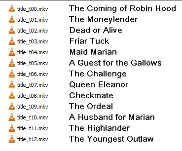

    I ripped my 11 disk "Adventures of Robin Hood" collection using MakeMkv.
    There are 13 files in each folder (each folder is a disk) and I want to rename all 143 files to the episode names which I have in a text file.
    Problem is, I can't come up with a batch file (or any of the renamer programs) which will use the text file list to rename the source file.
    This shows what I'm trying to do: renaming the .mkv file to the episode name.
    [Attachment 58727 - Click to enlarge]
