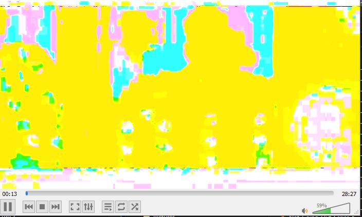

This is driving me nuts.
I have downloaded items from player with get_iplayer all works fine.
But the resultant file doesn't play correctly in VLC, it plays fine in both WMP and 'Films &TV'

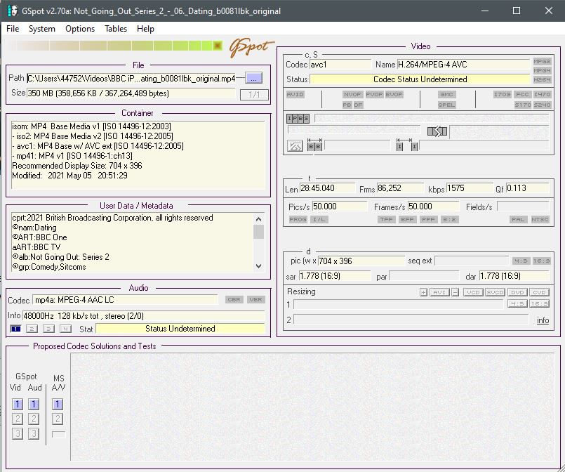

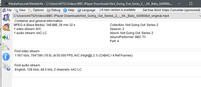

I have used both G-spot and MediaInfo to try and work out if I am missing a codec. Driving me nuts googling fo the codec i think it is, to not apparently be able to find it anywhere.
Please can someone help - Thanks in advance

multiple files, all same issue
sample full mediainfo
General
Complete name : C:\Users\44752\Videos\BBC iPlayer Downloads\Not Going Out\Not_Going_Out_-_07._The_House_b03nhmwb_original.mp4
Format : MPEG-4
Format profile : Base Media
Codec ID : isom (isom/iso2/avc1/mp41)
File size : 528 MiB
Duration : 43 min 57 s
Overall bit rate : 1 679 kb/s
Collection : Not Going Out
Season : 1
Album : Not Going Out
Album/Performer : BBC TV
Part : 7
Part/Position : 1
Track name : The House
Track name/Position : 7
Grouping : Comedy,Sitcoms
Performer : BBC One
Composer : BBC iPlayer
Genre : Comedy
ContentType : TV Show
Recorded date : UTC 2013-12-24 22:00:00
Tagged date : UTC 2021-05-04 20:38:04
Copyright : 2021 British Broadcasting Corporation, all rights reserved
Cover : Yes
Video
Format : AVC
Format profile : High@L3.1
Format settings : CABAC / 4 Ref Frames
Format settings, CABAC : Yes
Format settings, Reference frames : 4 frames
Codec ID : avc1
Bit rate : 1 543 kb/s
Width : 704 pixels
Height : 396 pixels
Display aspect ratio : 16:9
Frame rate mode : Constant
Frame rate : 50.000 FPS
Color space : YUV
Chroma subsampling : 4:2:0
Bit depth : 8 bits
Scan type : Progressive
Bits/(Pixel*Frame) : 0.111
Stream size : 485 MiB (92%)
Color range : Limited
Color primaries : BT.709
Transfer characteristics : BT.709
Matrix coefficients : BT.709
Codec configuration box : avcC
Audio
Format : AAC LC
Format/Info : Advanced Audio Codec Low Complexity
Codec ID : mp4a-40-2
Bit rate mode : Variable
Bit rate : 128 kb/s
Maximum bit rate : 144 kb/s
Channel(s) : 2 channels
Channel layout : L R
Sampling rate : 48.0 kHz
Frame rate : 46.875 FPS (1024 SPF)
Compression mode : Lossy
Stream size : 40.2 MiB (8%)
Language : English
Default : Yes
Alternate group : 1 -
Have you tried it in mpc-hc ? VLC can be a little strange at times.

MPC-HC also works, proving to me it isn't the file, but is instead VLC.
i shall see if de-install and re-installing VLC will work (though this wont be the first time I've tried this) and if it doesn't ill have to just watch on something other than VLC.
thanks again.
