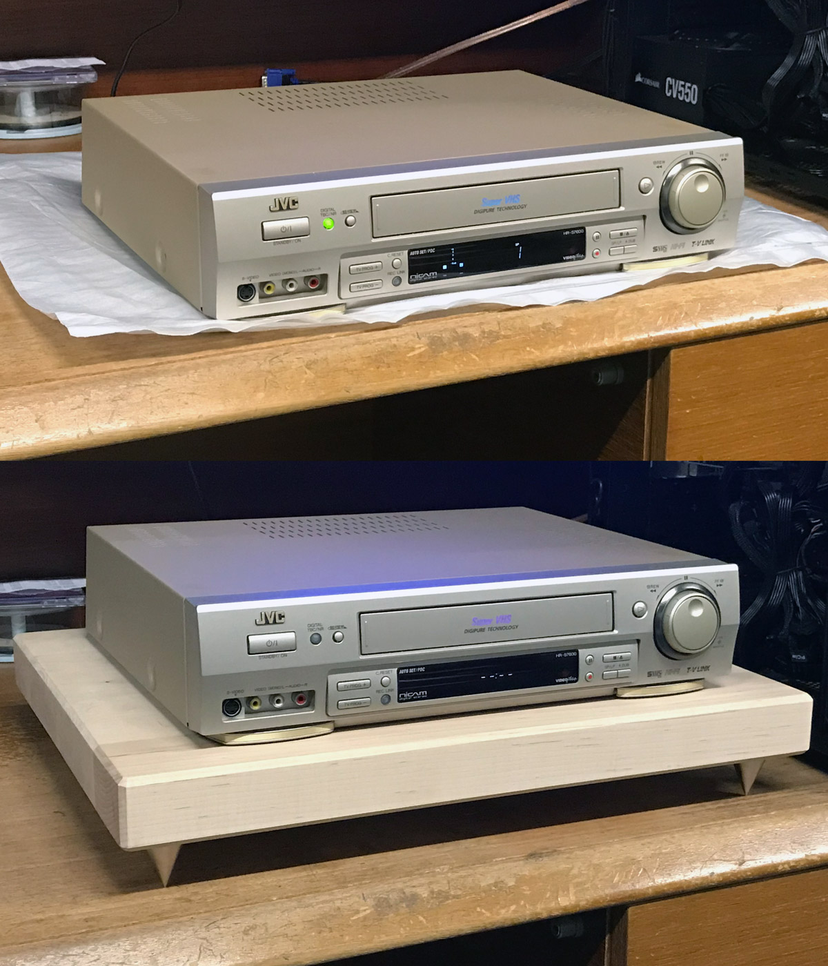

    As one of my other crazy hobbies is high end audio, I had on hand a 2" maple spiked isolation platform, which is highly regarded among analog turntable fanatics. I did another TBC-ON capture with the VCR sitting on this platform, and now all that jitter is totally gone.
    See the results for yourself. I spliced together 4 bad jittery scenes, total of 45 seconds. And repeated it from 3 different captures all with TBC ON.

    jvc-tbc-(isolation-platform) - This is the final capture done with the VCR on the isolation platform. All jitter gone. (B.E.S.T/Video Calibration is turned off in this capture).
    I know this is only 1 example, and the isolation fix may not work in all cases, but this points to the JVC TBC circuit being highly susceptible to mechanical induced chassis vibration. My workbench desk is sturdy as it is now, but real isolation is obviously required. I have not even begun to investigate the effect on putting isolation under the VCR itself. You could use footers or even go insane with something like Stillpoints, which I own for my audio system.
    I am new to all this VCR capture thing, but thought you all may get something from this test, because I have not come across any threads of people investigating the effects of mechanical vibration and TBC, or of isolation platforms and VCR's in general.

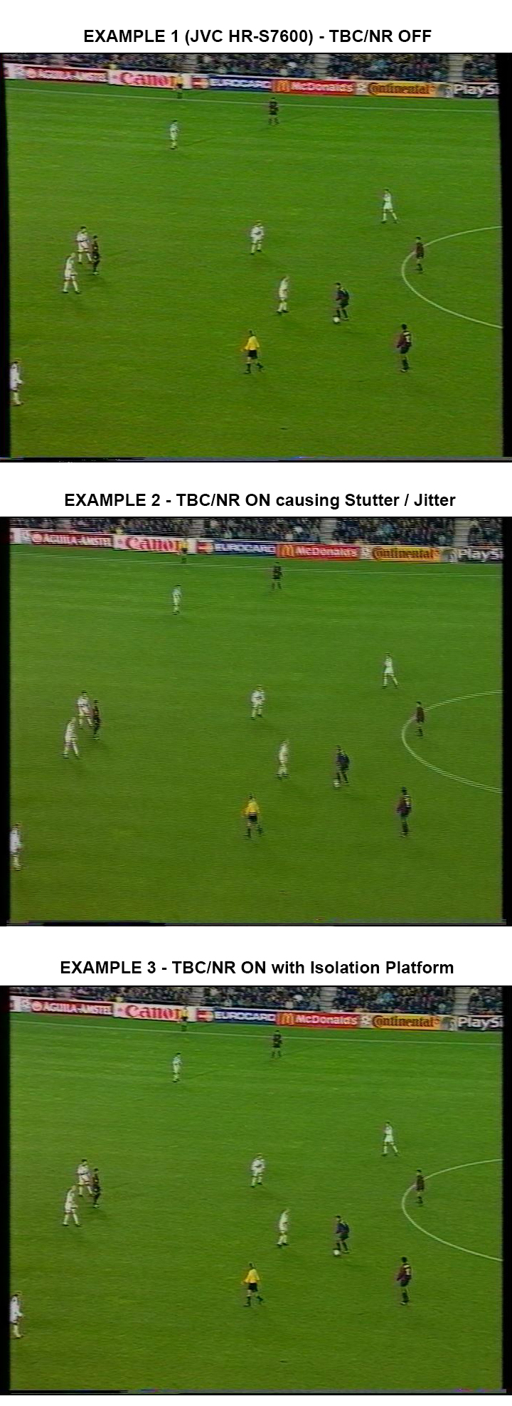

  2. I think this also could explains why the higher end JVC models are reported to handle jitter better, because the chassis is more substantial and damped on the 9600/9700 and SRW5 models ?
    Here is an exact frame comparison. All settings here were EDIT mode and nothing else turned on.
    The top frame is from TBC OFF.
    The middle frame is TBC ON.
    The bottom frame is TBC ON and ISOLATED.

  8. Is the isolating platform wood, plastic or metal? Are there any mains leads near where the VCR is positioned? (including mains wires in the walls - e.g. is it near to a mains socket and either at the same level or immediately above or below it?) Is it possible that the platform is either shielding the VCR from a local source of interference or just moving it far enough away that it's effects are not so noticeable? (Inverse square law and all that.)
    The photo above shows the VCR sitting on the bench on either a piece of paper or material, was the bit of paper/material there when you did the captures? If it was, is it possible that it was partially blocking some of the ventilations slots in the bottom of the VCR (if it has any) and causing the VCR to run a bit hotter? (I had something similar with my two Liteon DVD recorders, and just increasing the airgap under the recorders by even just the height of a CD case would cure the problem.)

  11. Originally Posted by TimA-C View Post
    This is exactly what I am thinking, that foam paper thingy that slips over components in the box could be a cause of issues. The vcr is well away from power lines, and I made an effort to keep the in/out cables clear of each other for (hopefully) interference free capture.

  13. I just did 4 new TBC captures. The first 3 - on foam matt, on hardwood desk, on isolation platform. The jitter was now totally gone from all captures.
    I thought bugger, I have got this all wrong, the isolation makes no difference, and I messed up the initial captures somehow.
    But these 3 new captures were all only of the 8 minute segment that contained the 4 scenes I am analysing. The previous captures were all longform 2 hours. So maybe as the TBC circuit heats up, it starts to play up on this unit? And I noticed all my previous 2 hour captures, no jitter/stutter was present in the first 1/2 hour of each capture.
    So I just did a new capture, on the foam matt as before, long form. The jitter is now back at the exact same points, starting about 40 minutes into the tape.
    So it looks like possibly a heat issue, and lifting the VCR off the foam matting onto the platform alleviated the heat issue allowing the TBC to work better. This may be just specific to this unit being old and faulty.
    I will try another capture on the foam matt, but this time with the case lid off, for maximum air.
    EDIT - Lid off and now no jitter on a long capture. Also I tried lid on again, and jitter returned.
    So I was wrong about the isolation. It's heat that seems to cause the TBC to fritz after an extended period of use (on this unit).

  14. agisthos, are you saying your 7600 has been sitting on that piece of foam packing sheet the entire time prior to experimenting with the turntable platform? Including the time covered by your other thread about TBC judder?
    If so, thats... problematic. Why on earth would you let it sit during active use on soft heat-insulating material like that? As an avid audiophile, presumably you must have known that would be terrible for circuit ventilation.
    Were you just so stunned by the mint condition of your newly-arrived 7600 that your fear of scuffing the bottom overcame your practical electronics experience?
    Not that I would have been terribly surprised if the isolation platform really did improbably solve your judder issue via vibration damping: these JVC VCRs (and the equally ridiculous Panasonic AG1980) are the most histrionic boxes of hypersensitive glitch-ridden BS ever foisted on the paying public. They misbehave at the slightest provocation (weather, astrological arrangements, house settling, planes flying overhead, pothole being filled three blocks away). I live for the day my years-long VHS transfer project is finally completed, and I can gleefully toss each one of these sadistic diva VCRs out my attic window onto my concrete driveway.
  15. Originally Posted by orsetto View Post
    That's exactly it lol.

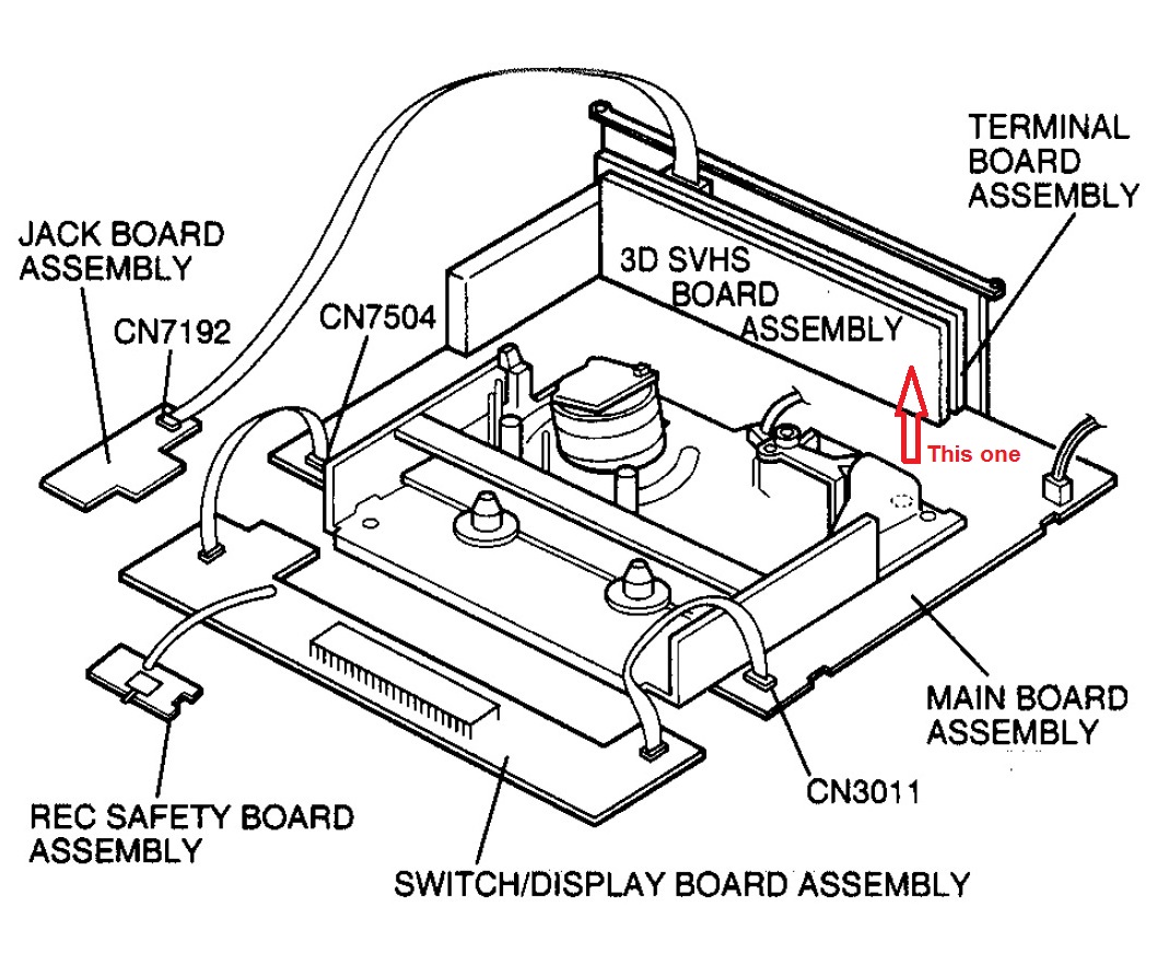

    Question, which part of the player does the TBC? There are 2 circuit boards parallel to each other at the back of the unit.
    The one marked in red, You may as well do a board recap while at it if you have heat issues. Power supply caps do fail too but JVC's switched power modules proven to be reliable.

  19. I thought that was the one. It had some kind of metal shield on it as well.
    Does it plug in/out of a slot on the mainboard, or is it soldered into the mainboard? If its the later.... that makes things a bit more PITA.
  20. Capturing Memories dellsam34's Avatar
    Jan 2016
    Look up your exact model number service manual, it should tel you how it is mounted to the main board.
