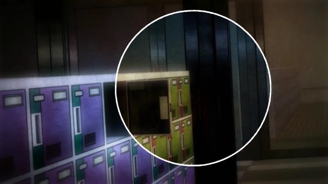

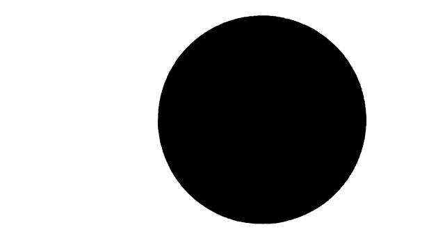

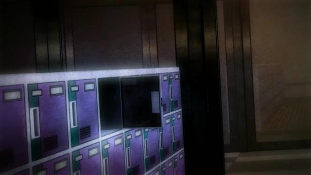

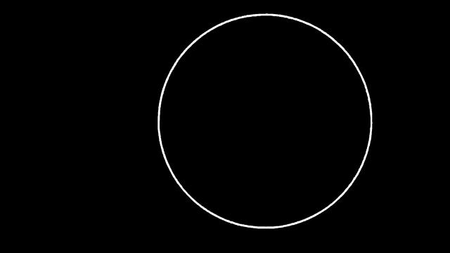

I don't use Vegas but that should be pretty simple to reproduce. Just create tracks with different colors (probably simple Hue rotations) and use an animated circle alpha mask for the transitions.
original:
[Attachment 58508 - Click to enlarge]
alternate colors:
[Attachment 58509 - Click to enlarge]
alpha mask:
[Attachment 58510 - Click to enlarge]
outline:
[Attachment 58511 - Click to enlarge]
final result:
[Attachment 58512 - Click to enlarge]Last edited by jagabo; 20th Apr 2021 at 23:06.
