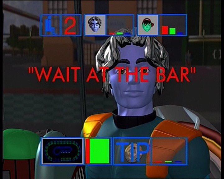

    This episode is affected by some serious dot crawl.
    [Attachment 58490 - Click to enlarge]

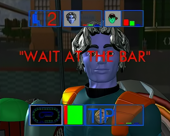

    Using QTGMC's EZDenoise, TComb, and checkmate in combination I managed to get it to look like this:
    [Attachment 58492 - Click to enlarge]
    But is there a more efficient way, or one that might produce a better result?

    SetFilterMTMode("QTGMC", 3)
    QTGMC(FPSDivisor=2,Preset="Slower",EZDenoise=10.5, NoisePreset="Slower")
    SetFilterMTMode("DEFAULT_MT_MODE", 3)
    TComb(mode=0, fthreshL=20, othreshL=255)
    checkmate(thr=12, max=12, tthr2=10)
    That's what I used to clean up as much noise as possible before adding a sharpening filter.

  5. Try this:
    Santiag(nns=4)
    TurnRight().Santiag(nns=4).TurnLeft()
    Santiag(nns=4)
    TemporalDegrain(sigma=4) # or some other 3d NR filter
    [Attachment 58496 - Click to enlarge]
    Follow up with your sharpening and any other cleanup.

    Oh wow that's great, thank you very much!
  7. This is about the same but maybe faster:
    Santiag(strh=2, strv=2, nns=4)
    FlipVertical().Santiag(strh=2, strv=2, nns=4).FlipVertical()
