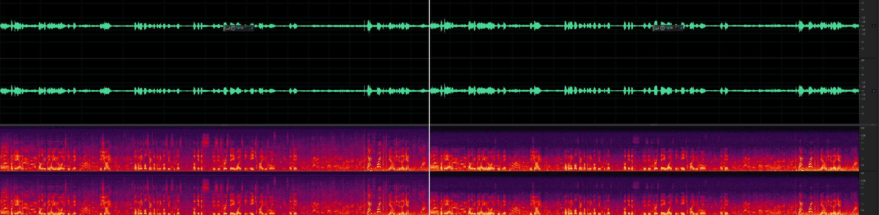

    Is my jvc possibly defaulting to linear audio?
    On certain tapes the jvc sounds fine, on others its muffled. Those same tapes that are muffled sound MUCH better on my vcr/dvd combo, even though the video doesn't match the jvc image quality.
    As for the tapes that sound fine on the jvc, they sound pretty much identical on the combo unit, maybe sliiiiightly brighter.
    Would this be caused by poor hi-fi tracking? I tried norm/mix as well as routing the audio through the combo and going direct, but same results. I also tried manual tracking adjustment but as I expected it only affected the video.

    I've attached an image showing my results of the same tape captured on both vcr's. As you can see, it looks like the jvc mostly cuts off around 4-4.5khz, what looks like a filtered band around 4.5-6khz, some sibilance in the 6-10khz range, and a steep low pass shelf/cut about 14khz+
    I didn't want to have to do so much recapturing with so much else to get to, but it is what it is I guess.

  2. None of the "premium" VCRs recommended for VHS capture are 100% perfect: each brand and model range has flaws, which is why we're often stuck with a shelf of several different VCRs to suit different tapes. One of the known JVC issues is variable audio performance: their HiFi tracking lock isn't very stable on a depressing number of older tapes, if a JVC can't solidly lock on a drifty HiFi signal it will default to the linear sound track on the tape edge. And the aggravation doesn't stop there: some later-model JVCs have noticeably worse than average playback quality of the linear audio track (more muffling, hum and noise than most other VCRs).
    The VHS HiFi audio system is inherently unstable and unreliable: many many VCRs have difficulty keeping a consistent tracking lock on HiFi tapes they did not record themselves, and some brands of VCR have a nominal HiFi tracking alignment that veers way off from others (i.e., JVCs are not too fond of playing HiFi tapes made on Hitachi/RCA and several Panasonics, Panasonic doesn't track JVC HiFi too great, and Hitachi is all over the place as a player). Depending on the specific tape and VCR, the unit may have so much difficulty tracking the HiFi that it won't lock at all, defaulting to the linear audio. In such cases, one then needs to prioritize the JVC video enhancements vs cleaner linear audio performance of another VCR. The more ambitious among us might do two passes: a JVC for the video, another VCR for the audio, then combine and adjust the two in software post-capture.
    It is possible the tapes you're having difficulty with are not HiFi at all, so no HiFi track is available no matter the VCR. All you can do is use whatever VCR in your arsenal has the best linear audio performance. If you're quite certain these tapes do have a HiFi track, you may need to try several HiFi decks before finding one that locks on the HiFi with stability. Some HiFi tapes are very very resistant to stable tracking: they were recorded slightly off to begin with, then 10-20-30 years of aging shifted the physical tape dimensions slightly making it near impossible to get perfect HiFi without deliberately misaligning a VCR mechanism to match them.
    VHS HiFi audio is among the more challenging aspects of capture. Its somewhat of a kludge that doesn't operate in logical expected fashion: its recorded by spinning heads on the video drum, but they are separate heads with their own tracking angle that is typically slightly off from the video head tracks. Very often you'll encounter a tape that has no or minimal video tracking issues (picture plays perfectly on multiple VCRs), but the HiFi audio will be maddeningly resistant to stable tracking lock (frequently needing a tracking setting that disturbs the video). Settling for the mono linear audio is sometimes the only expedient, practical alternative, so it is immensely frustrating that the otherwise well-designed JVCs have such dismal audio performance in linear mode (I'm appalled at how bad my SR-V101 and SR-MV50S sound in mono mode: an ancient Record-A-Call microcassette phone answering machine runs rings around them).

  12. I didn't line these up precisely, but here's about 10 seconds of audio from each machine. The only adjustment I made was I boosted the JVC by about 8db to match the combo/passthrough, the JVC has a much weaker signal on these tapes, but again the hifi is fine so those tapes are still ok.
    If you boost the treble, the JVC audio gets very noisy, and still lacks the nuances, most obvious in the sibilant frequencies, that the combo picks up.
    Let me know what you think. I'm still considering double checking the alignment. I haven't done that before on a vcr, but I'm pretty sure I can handle it, if it would for sure help.
  13. Originally Posted by bbmaster123 View Post
    Your samples are consistent with the differences I hear between the linear audio playback of my own JVCs vs other VCRs. Your tweaked example of your JVC is noticeably better than the unretouched linear audio I get out of either of my JVCs: I've never bothered trying to tweak them because they seemed so muffled and noisy that it wouldn't be worth the trouble. You've got me re-considering that option, although I do have the luxury of owning the Panasonic, Mitsu and Sony alternative VCRs. All four VCRs have comparable TBC/DNR performance, so when the JVC linear audio bites I just switch VCRs. But occasionally the JVC is distinctly preferable for video despite the lousy linear audio, so I might try tweaking it in post as you did.
    I'd recommend against trying to adjust your JVC alignment: you risk more problems for no real potential improvement. The bad linear audio playback is baked into the design, similar across multiple models and mfg dates of JVC beginning some time in the 1990s. The JVCs I used in the mid to late 80s had very good linear audio, so its something JVC changed toward the end of the VHS era. Unfortunately thats when most of the popular JVC TBC/DNR models we rely on for capture were made.

  15. Your samples are consistent with the differences I hear between the linear audio playback of my own JVCs vs other VCRs.
    If that's how they came, right out of production, I honestly can't understand how they would think that is acceptable (besides profit ofc, I'm talking from a technical standpoint)
    that's too bad, but at the same time a bit of a relief. If I don't stand to gain anything I wont bother.
    the jvc sample I uploaded only had the volume boosted, no other tweaking. I did play around tweaking that file, but I didn't save the changes since it was so noisy after raising the treble. Denoising gets rid of the noise, but since the signal is missing the upper frequencies anyway, it becomes even more obvious that there was a steep high-frequency signal roll-off to begin with.

  22. So I did the adjustment and now it sounds great (for linear audio ofc). It now matches the volume of the combo, has no weird filtered bands, and doesn't sound muffled. It doesn't sound as filtered now as the combo, more low end and such.
    there is still a roll off at 14khz but there's nothing useful up there anyway, so I think in this case mission accomplished. here's my result, attached.
    Funny how both jvc's had the same issue and both were fixed with a small adjustment.
    then again I can't believe the 3500u works at all considering my younger brother once stuck a whole pickle in it to hopefully get to see a movie about pickles :P
    Oh and there was absolutely no grease or lubricant anywhere inside the 3500u. No wonder its squeals.

  25. The linear head has 3 screws in a triangular arrangement. The one closest to the head controls its "up-down", the one furthest controls its tilt towards and away from the tape, and the third, closest to the back of the vcr controls its skew.
    I loaded up adobe audition so I could see the spectral view, and selected my xonar line in. I put in a tape with mtv videos, put on my headphones, and hit record. Then I mostly just messed around until the spectral view looked right and I could hear the hihat. If the head is too high or low it will make a high pitch screech around 7400hz. very small adjustments make a difference, but so do larger adjustments, so I took a good hour cycling through songs I knew like sweet home Alabama such trying to perfect it as best as I could. I also tested several other tapes to make sure it still sounded good.
    Of course you have to be careful but it was definitely a simple procedure. I don't think there's anything to lose by trying it as long as you don't let the screwdriver slip.
    14 khz should be above the frequency response possible on the linear audio. I don't remember the exact specs out of hand but vcrs list something like 11-13 khz as the top for SP mode.
  28. I am glad I read this and its not my imagination, because my JVC 7600 seems to record audio muffled and low in quality, at least in comparison to the cheap as chips 2002 era Panasonic VCR I also have here. The JVC murders the Panasonic on image quality, however.
  29. If it wasn't clear the same fix worked for both my jvc's, and now I am starting recapturing these tapes from my collection! The adjustment also did not affect the video or hifi playback.
    Yea anything that requires specialized tools is something I wouldn't want to get into, but slightly turning a few screws is easy enough. IMO, worth it.
    But of course everyone should take my results with salt and decide for themselves if it would be worth it to them, and if the risks outweigh the benefits, in their case.
  30. Capturing Memories dellsam34's Avatar
    Jan 2016
    If it records muffled audio it is defective (bad electronics), dirty/worn heads, or pinch roller and transport problems, This thread is about playing back tapes recorded on other machines. A VCR, any VCR should playback its own recordings perfectly unless it has a problem, First I would clean the heads and go from there.
