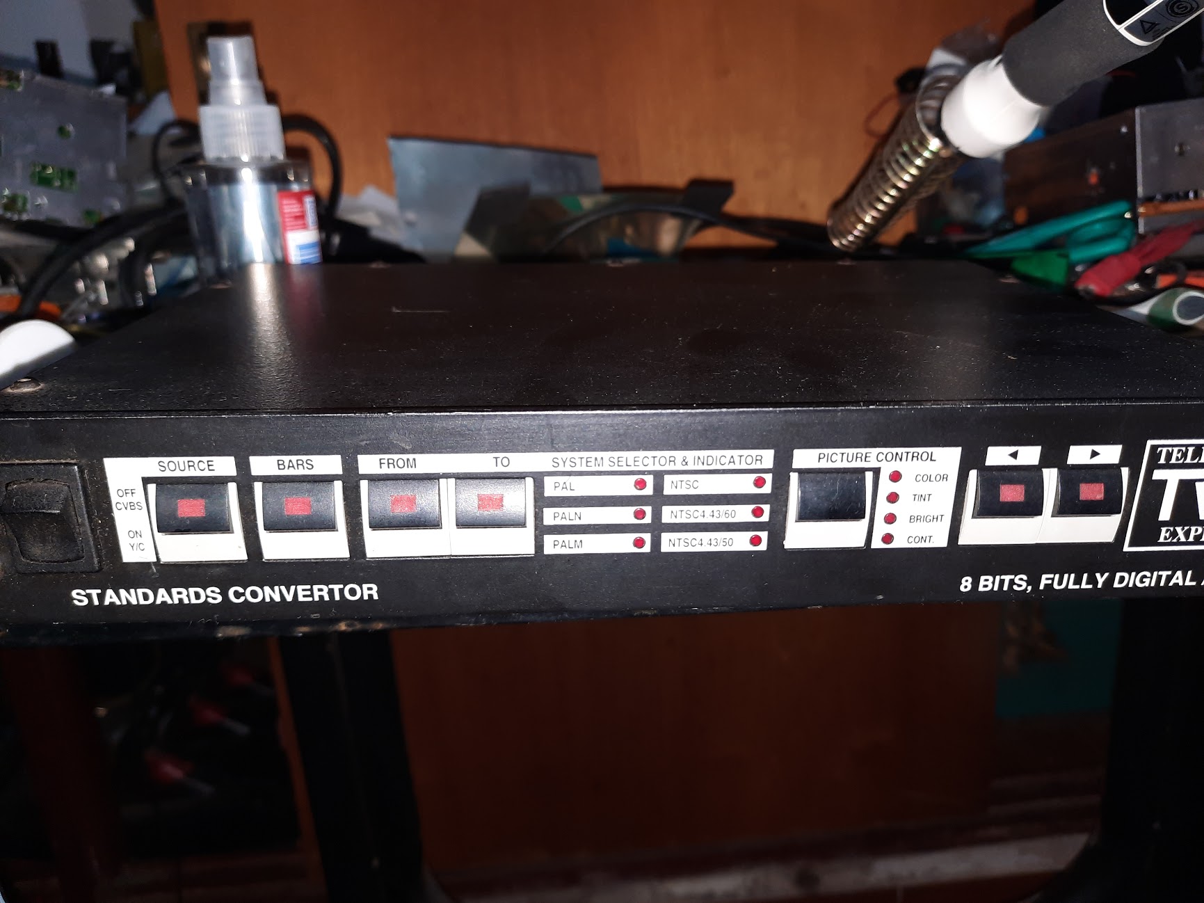

Recently I got this transcoder, got it for 10usd, tested the composite output and works fine.
Brand it's "TVX television Experts" and in the back as a "made in USA" stamp.
If feature bars generator, Svideo in/out, transcode and a procamp.
[Attachment 58387 - Click to enlarge]

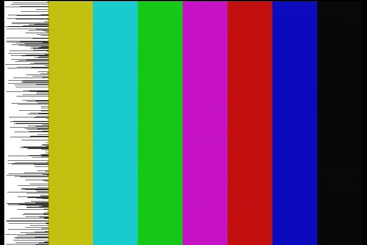

I tested the composite output and it works like a charm, however the Svideo seems to have some issues.
At the beginning I has having issues (noise) in the whites.
[Attachment 58388 - Click to enlarge]
(mostly when using a 25ft svideo cable)
This was solved by increasing a trim pot in the main board, probably gain?
However the issue that remains is in the top some sort of flickering. The same happens on any cable.

I already changed the only electrolitic cap on the main board, didnt have any effect.

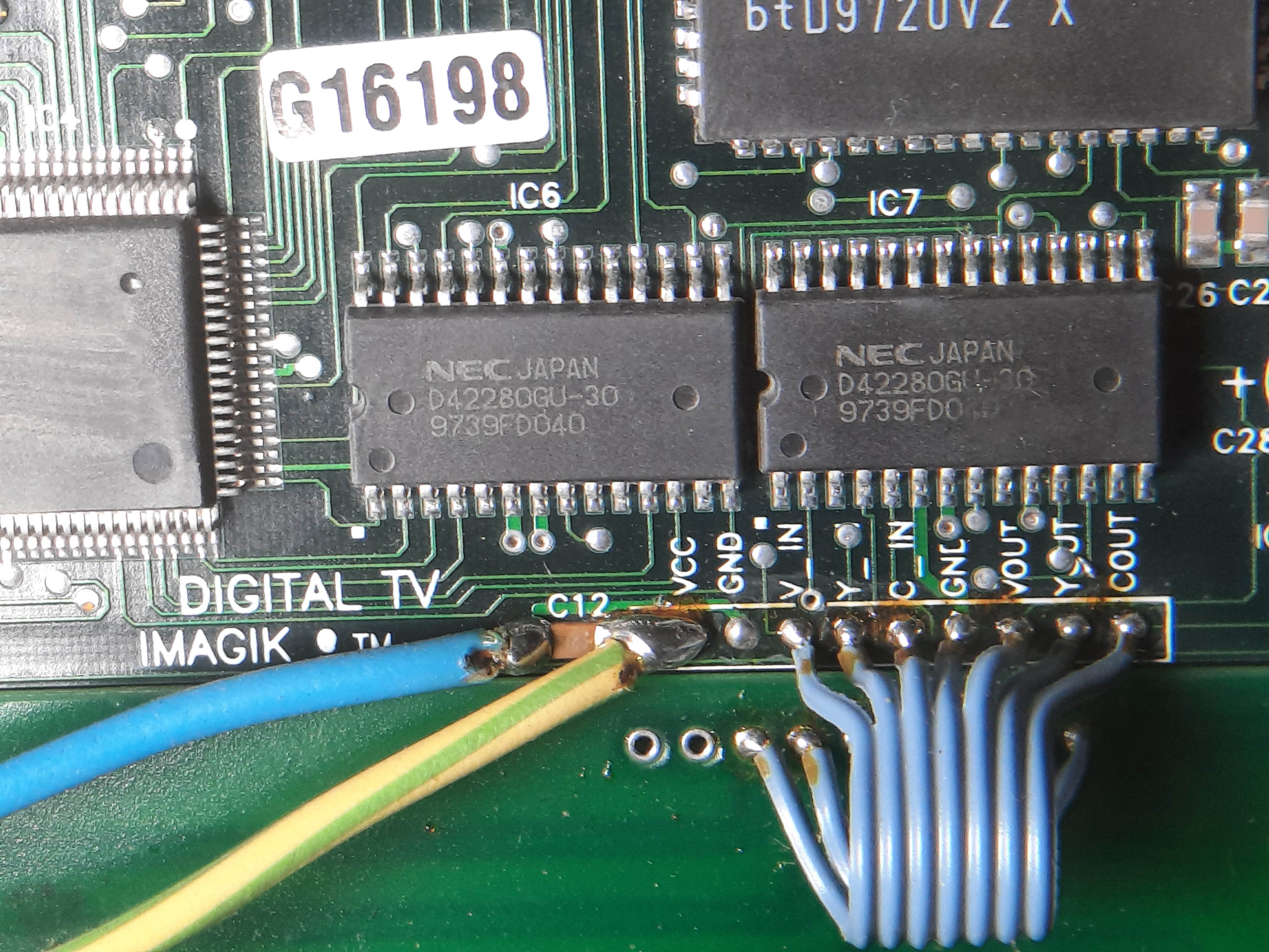

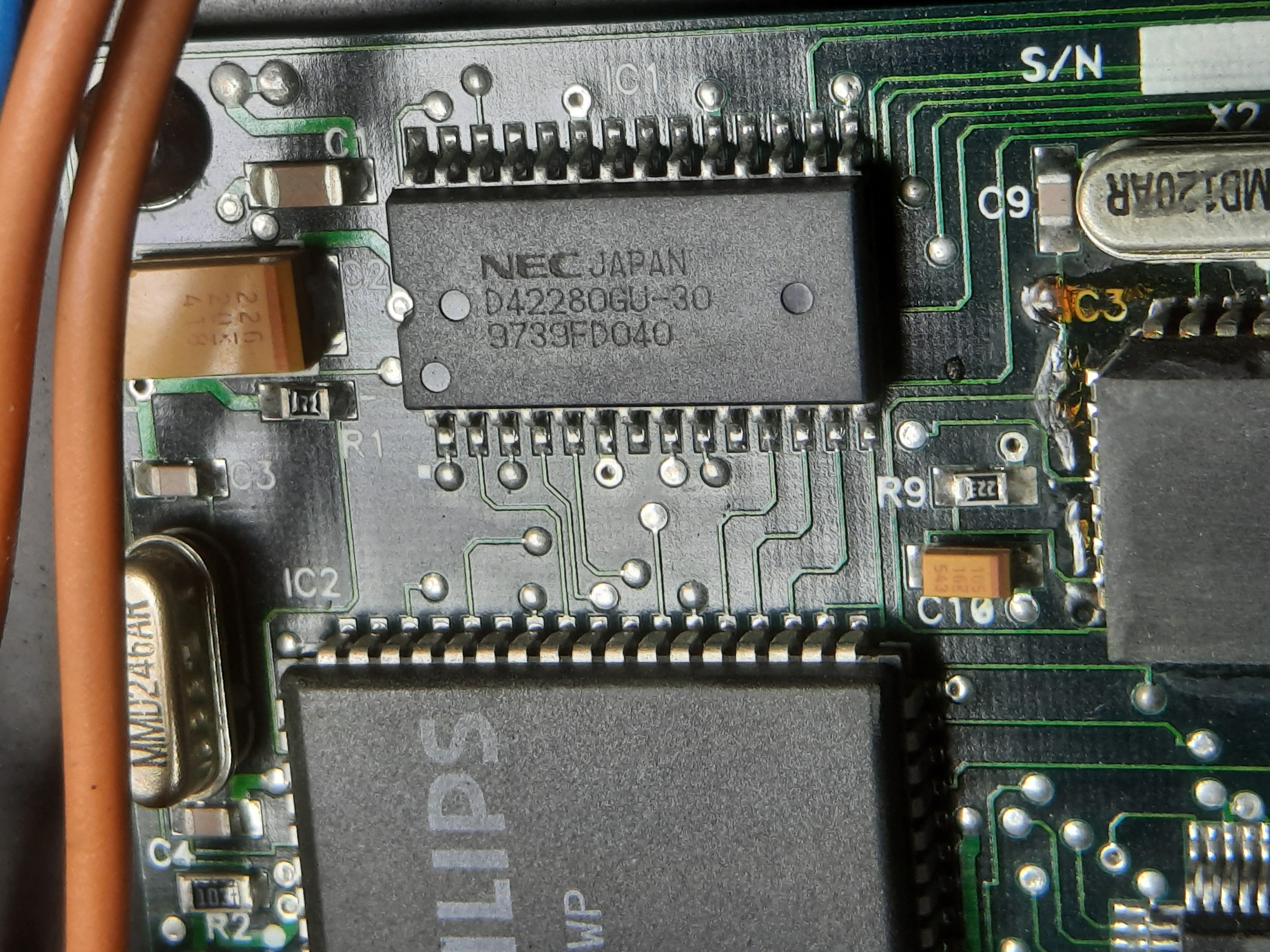

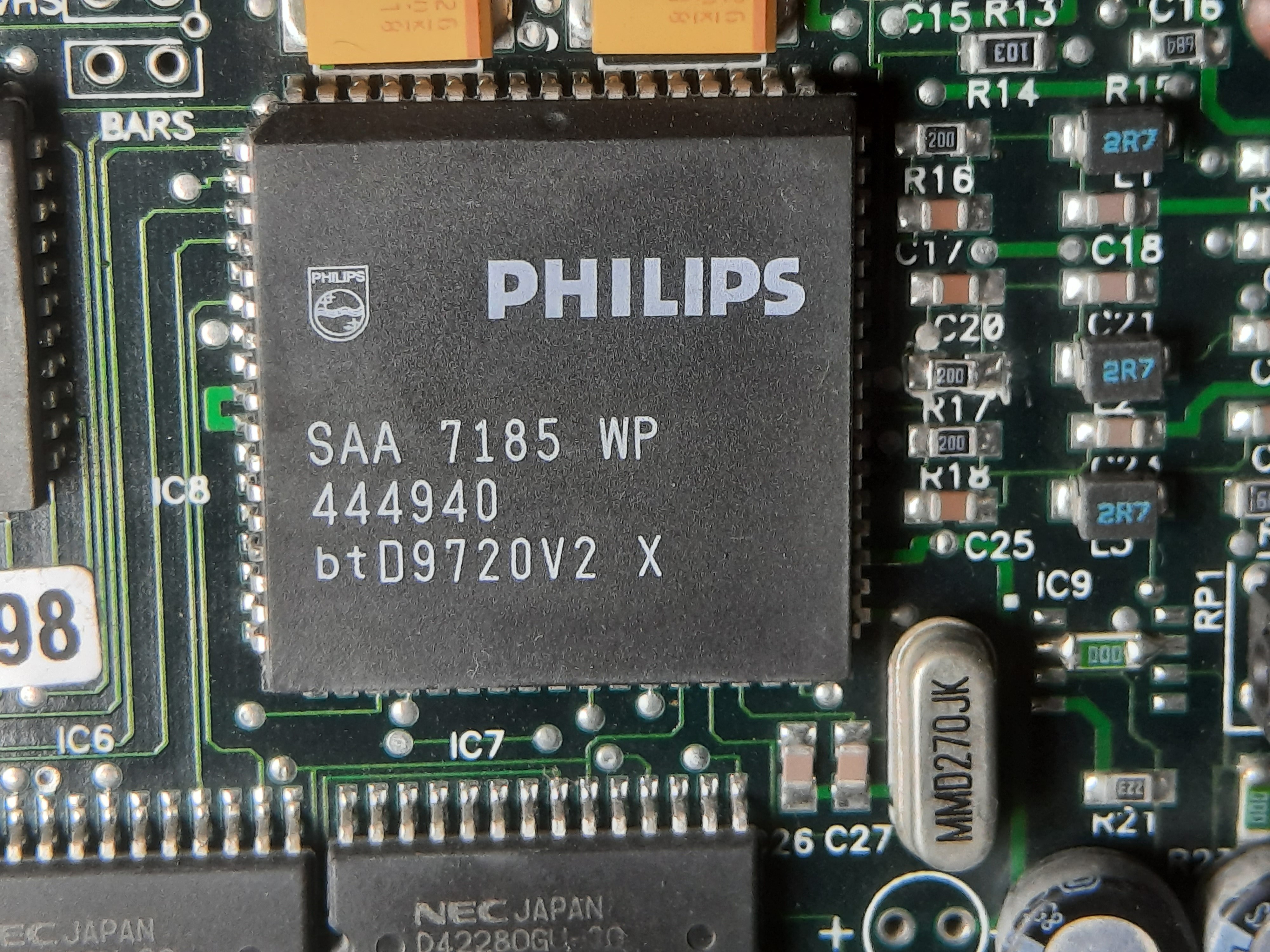

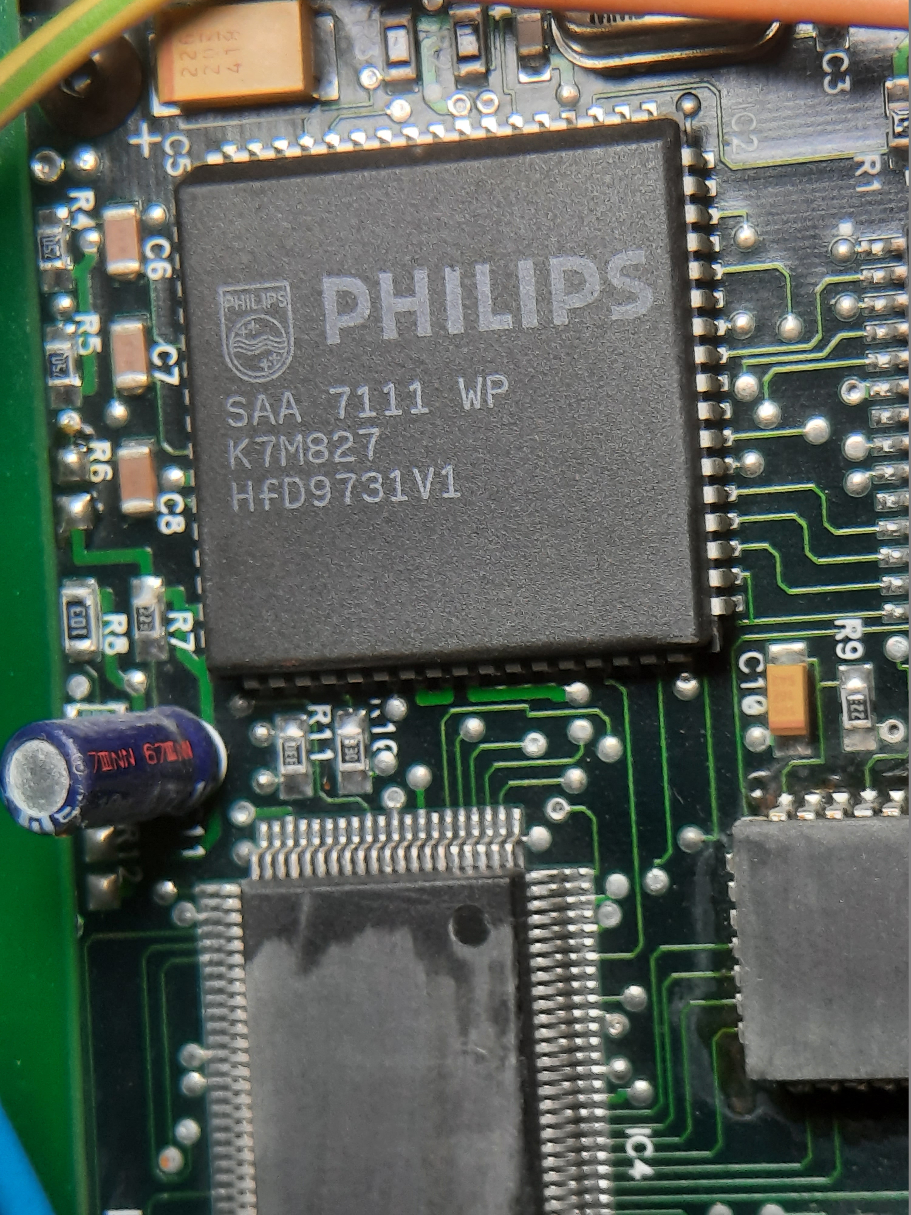

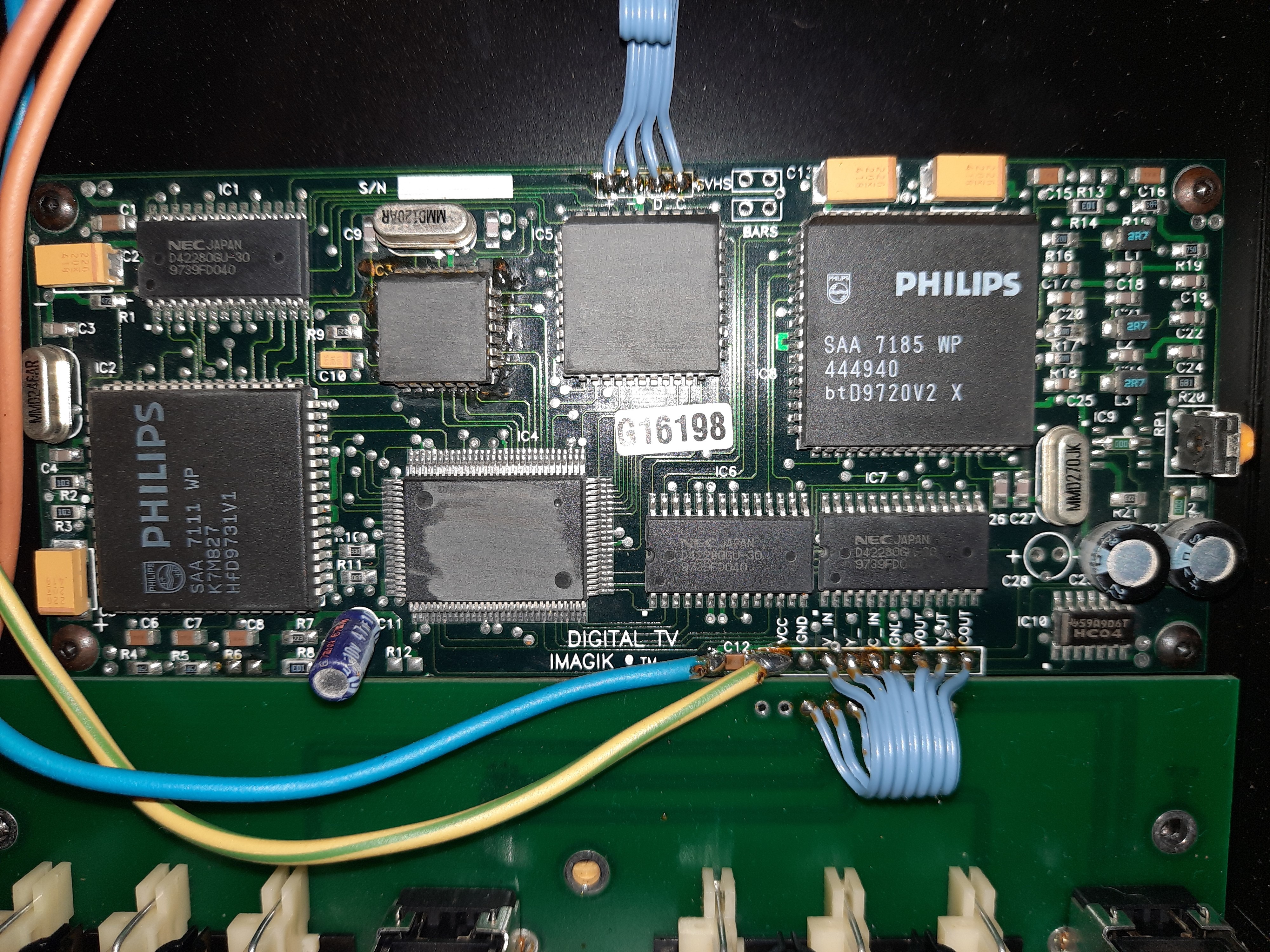

Here some pics to see it:
MAIN BOARD
[Attachment 58389 - Click to enlarge]
FIFO
[Attachment 58390 - Click to enlarge]
[Attachment 58391 - Click to enlarge]
[Attachment 58392 - Click to enlarge]
[Attachment 58393 - Click to enlarge]
BTW some IC's have been sanded. The old practices so you cant know what they are.

Any ideas are welcome!
