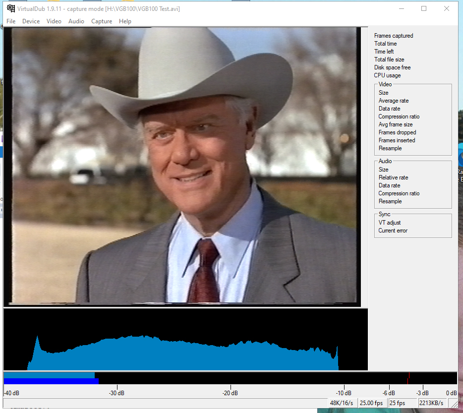

    Here we go. It's running on Win 10 20H2 in Virtual Dub (1.9.11):
    [Attachment 58373 - Click to enlarge]
    I only installed the drivers, not the Honestech DVD software.
    Proc amp and histogram are working fine (thanks again, jagabo! You are THE legend).
    Download VDub from here:
    http://www.digitalfaq.com/forum/video-conversion/1727-virtualdub-filters-pre.html
    Capture guide here:
    http://www.digitalfaq.com/guides/video/capture-avi-virtualdub.htm
    I have a hunch that it is important that, when pulling out your USB stick, that you "safely remove" it from Windows first; in the tray, click the "safely remove hardware" icon and click the "eject USB capture device" line.
    Standby for a report on the Honestech software...

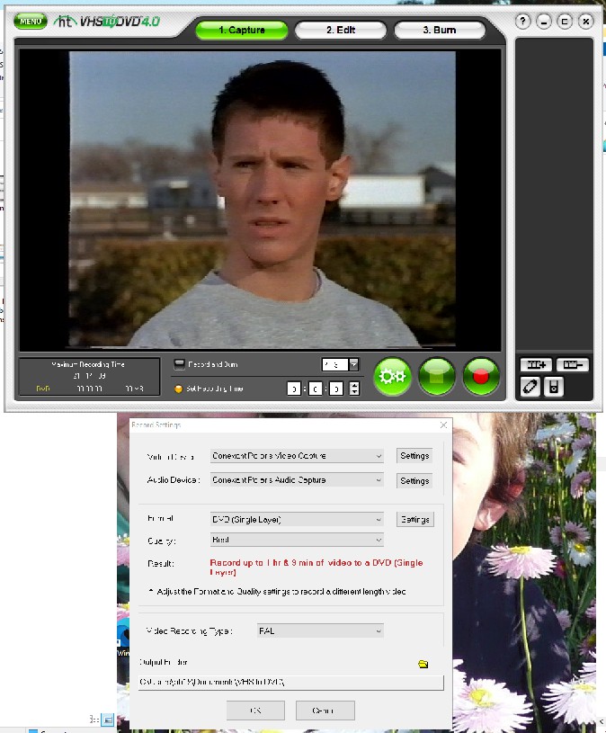

    Honestech working OK too. BUT, it records into MPEG 2, which is not desirable for advanced video processing. That said, it will be simpler putting the video onto a DVD using the Honestech capture fi you don't want to get too deep.
    [Attachment 58374 - Click to enlarge]
    Make sure you've got the settings set correctly . They're self-explanatory, but you have to open the Settings cog first (on the 1. Capture screen); mine wasn't set on the "Conexant Polaris Video Capture Device" (the VGB-100) for video or audio.

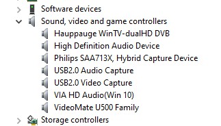

    May 2005
    Australia-PAL Land
    Yes, good call, DB83.
    Here is what my Device Manager looks like:
    [Attachment 58375 - Click to enlarge]
    The VGB100 is the two "USB2.0" entries.
    Do you have those, Darren?
    If not, I'll post the install sequence that I used.
    FYI, in this case, the instructions are to plug in the VGB100 first, then run the installer for the drivers and the Honestech DVD authoring software.

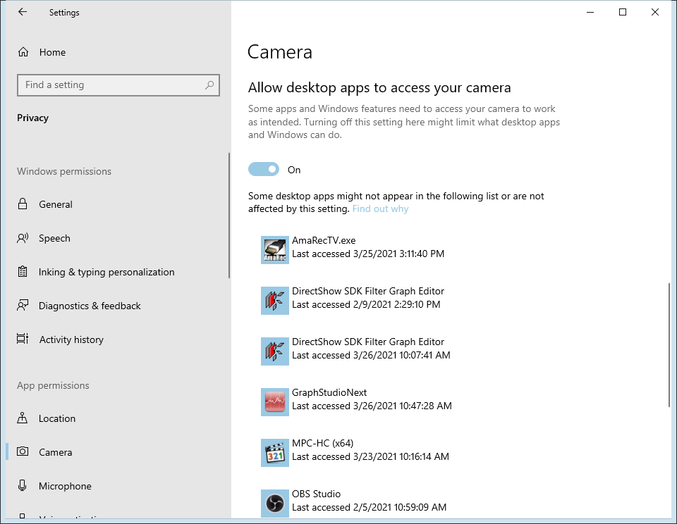

  5. Originally Posted by DB83 View Post
    *Now I did read a topic some days ago that a user had 'solved' his Win10 capture issues. I kinda dismissed the reply as I had not read that before. But, I guess, it is worth checking out just in case an update did do this.
    Yes, this is a common problem -- Windows security blocking access to video input devices. Windows -> Settings -> Privacy -> App Permissions -> Camera. Allow Store Apps and Desktop Apps access to the camera/capture device.
    [Attachment 58376 - Click to enlarge]
    Yes I have those.
    All done and no difference. This is getting ridiculous.

  21. Now I did read a topic some days ago that a user had 'solved' his Win10 capture issues.
    That was me. A Win10 update had turned-off my camera permissions. This had disabled my capture drivers. Turning permissions back on solved the problem.
    Go to Settings->Privacy->Camera. Turn on "Allow apps to access camera". See if this helps. For some reason, Win10 sees video capture devices as cameras.
