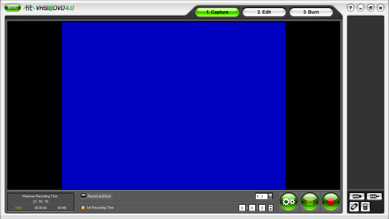

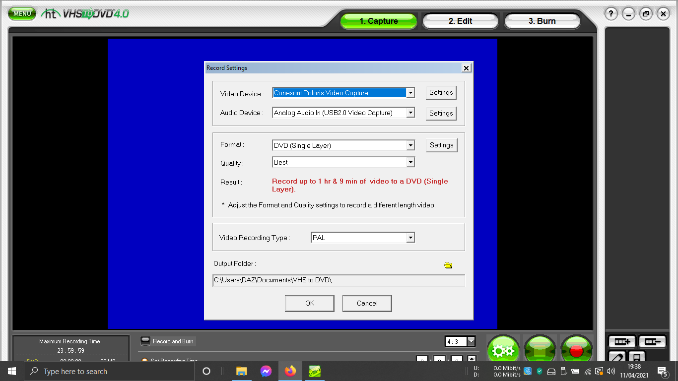

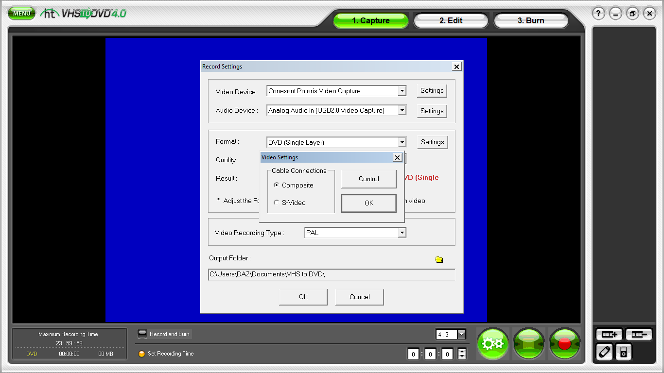

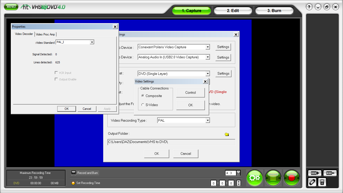

    This is one of the software's I am using as it came with the capture device.

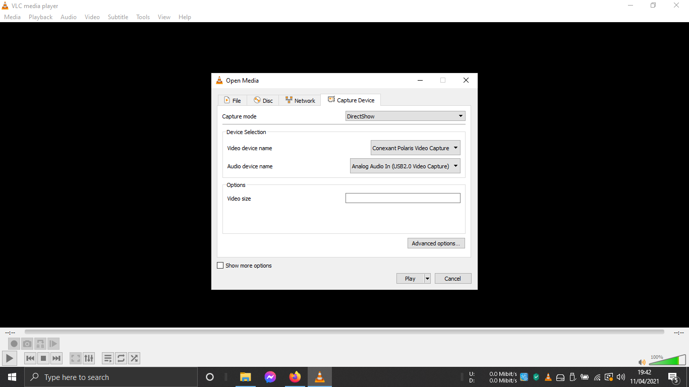

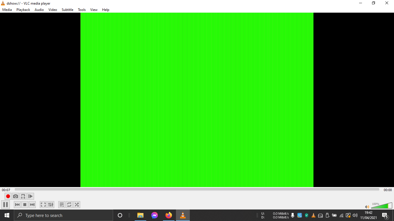

    This is the results with VLC.
    go to properties - compatibility then select reduced color mode then select 8bit

    Do you have any other options in the 'Video Device' drop down ?
    Crazy as it may appear, you do have the typically yellow composite plug in to the yellow socket in the device (and the adapter) (and not a white one)

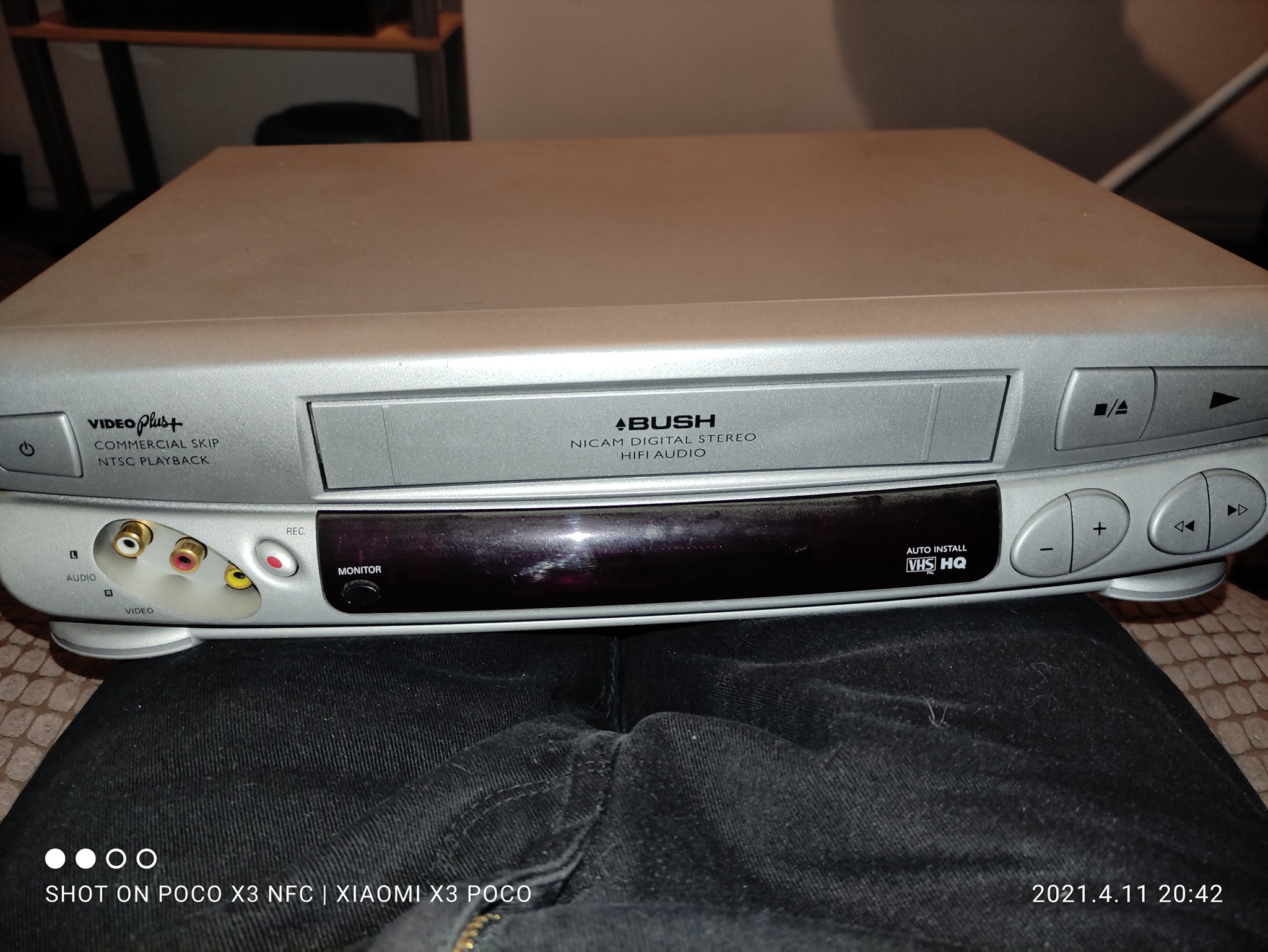

    One of my VCR's has composites on the front as well as the back. I don't get picture or sound when plugged into the front ones and wonder if maybe the front ones are INPUT only. Unfortunaltely I can't find a manual online for it. Bush VCR923.

    Feb 2006
    [Attachment 58369 - Click to enlarge]
    the connections on the front are input only, so you have to use the rear outputs (video out)
    and use the remote or channel buttons to select L2 for rear outputs

    That sample indicates to me that something is getting through the VGB to the computer as it is not totally blue; there are flashes of video signal. I'd try a couple of different tapes.
    I have the VGB-100 and the quality is quite good, on a par with my Phillips PCI card, and my GV-USB2 and USB-710.
    I did have problems at one stage with it working properly with VDub, but uninstalled the software, rebooted and then re-installed and all was well.
    I used the software off the August website, not the CD.
    I'll reinstall it with my current W10 (20H2) and see what happens. Standby.
