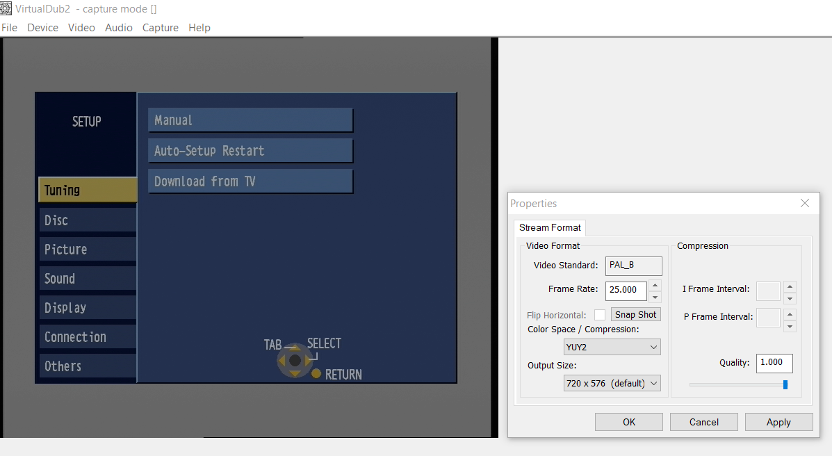

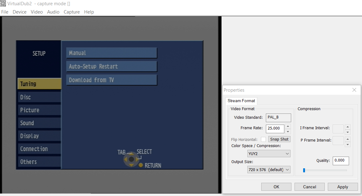

    Thanks for checking them. im getting close to accepting this is the best im going to get with the equipment i have. One last question if i may? The 'Capture Pin' settings has a Compression slider which is default to 1, when i change this to 0 i do see a difference in quality. What exactly is this doing? as i notice a difference even before capturing.
    Many thanks.
    [Attachment 61160 - Click to enlarge]
    [Attachment 61161 - Click to enlarge]
  7. I have no idea. The Capture pin ..... menu item is greyed out here in VDub2. May be it depends on the driver of your capture device.
    (and I am normally using AmarecTV for capturing, btw.)
  8. Member DB83's Avatar
    Jul 2007
    Same here.
    I noticed you have source set as PAL-B. Mine is set at PAL-I. Whether or not that makes any difference*. And I'm on Win7
    *No difference
    Ok no problem, I use amarectv when I get issues with vdub, but it seems to be behaving now I have changed the way I capture audio. I was using the dazzle usb audio, but now I use the line in Jack, and all seems fine now.
    Jan 2021
    UK
    Same here.
    *No difference
    Yeah, for some reason it keeps jumping back to PAL-B!
    I think I will keep it set as default 1 as it does make It look cleaner.
