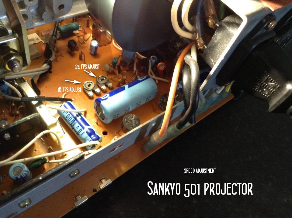

I am looking for some advice on how best to proceed modifying my Sankyo 500 cine projector for telecine work.
I am very capable with a soldering iron and I have good electrical awareness in terms of safety and common sense, I lack mathematical skills, essential for electronic component identification.
The Sankyo has two pots, one to adjust 18fps and one to adjust 24fps. There is a selector switch on the front panel to choose fps.
My idea is to take the 24fps pot, remove it from the board and place a regular pot mounted on the case, so I can vary the frame rate to reduce strobing without having to have the case open.
Seems simple enough, I have no problem in doing the wiring and mod, I need advice as follows please.
will this work?
what pot should I buy to use in place of the 'preset' pot on the board?
would it need to be a log or linear type of pot?
How would I determine the value of this pot, I have no circuit diagram but I am capable with a meter.
Should I remove the pot from the board to measure it's value? which pins would I put the meter across, and what settings should I have the meter on?
If you have any advice or tips, I would be most grateful.
I realise this may not get me the accuracy of 16.6fps which I need to achieve, but it is the only idea I have at the moment.
(caption on my photo is wrong, it is a Sankyo 500)
[Attachment 58348 - Click to enlarge]
