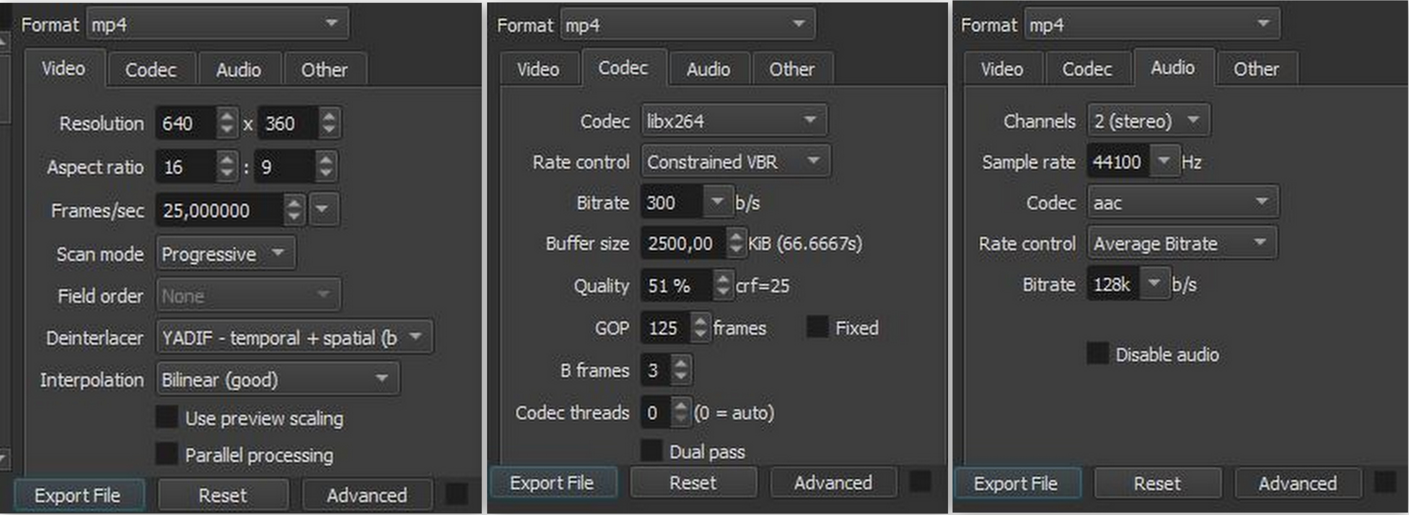

  1. Hello I'm trying to merge to videoes with different resolution (1.280x720 vs 640x360 pixels), CRF (constant rate factor: 20 vs 25) and bitrates (average and maximum). I succedeed using Shotcut as converting tool for the first video and MKVToolNix to join the two videoes (the first converted and the second 'original'). I was wondering why using ffmpeg + MKVToolNix the second part of the video (the one not converted) comes pixelated.
    I used the exact commands I used for Shotcut to convert the first video:
    ffmpeg -threads 0 -i input.mp4 -vf scale=640:360 -sws_flags bilinear -c:v libx264 -b:v 300k -bufsize 2500k -crf 25 -g 125 -bf 3 -c:a aac -ar 44100 -b:a 128k output.mp4
    This video comes well, but when I join it to the other video the output is pixalated.
    Here are ShotCut commands that succedeed.
    [Attachment 58347 - Click to enlarge]
    I attach the parameters of the first video (the one to be converted) and the second video.

  4. Thank you Jagabo, thanks Cu Selur, you were right, I had to add a parameter:
    -preset fast
    which correspons to:
    --rc-lookahead 30 --ref 2 --subme 6
    ffmpeg -i input.mp4 -vf scale=640:360 -c:v libx264 -preset fast -crf 25 -ar 44100 output.mp4
    Optional: -movflags +faststart
    Now there is no problem joining the videoes.
    MKVToolNix didn't help me with this generic warning:
    The codec's private data does not match. Both have the same length (50) but different content. Please make sure that the resulting file plays correctly the whole time. The author of this program will probably not give support for playback issues with the resulting file.
