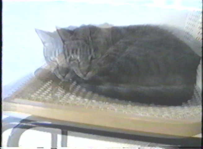

  4. Thank you very much for the reply and info.I captured the analog vhs-c with honest tech vid box 5.0(as I used it to capture other old vhs footage).Here is a screen shot of how it looks.Image
    [Attachment 58325 - Click to enlarge]
    I have never used AviSynth or scripted anything so i am trying to understandhow to separate the left/right.I will look into the plugin and hope it may do it automatically.In order to play what I captured in SSP I need to download ffdshow but when installing it asks me what components/plug ins and not sure what to check.
  5. Your cap has already been deinterlaced. There's no way to turn that into a 3d video. You need to go back capture interlaced.

  9. The captured video has the two fields blended together so there's no way to separate the left and right images. If you can't get another program capture the video from that device in its original interlaced form you'll have to get a capture device that supports that. Look through the forums for current standard definition capture devices that support "uncompressed YUV 4:2:2" format.
  10. Thank you all again for the info as I'm learning something new.I downloaded Vdub2 and it seems when I open it that it does recognize my Honest Tech capture device(did not know it could do this).I was able to capture but at uncompressed a 22 sec clip was 344mb.What is a good compression setting to use so I can upload a short clip to see if it is captured interlaced(or does Vdub do this automatically?) here is a screen shot so it does look different than my 1st screenshot.Do the horizontal lines in the "shadow" area mean its captured as interlaced? (versus my 1st ss doesnt show the horiz lines)

  11. Although you resized the video screwing up the interlacing I can see that you are now getting interlaced video. Assuming NTSC video in North America, you should capture at 720x480 29.97 fps as YUY2 (or other YUV 4:2:2 format) and compress with a lossless coded like Lagarith or UT Video Codec. You should then have interlaced video that can be convert from field sequential to side/side 3d. Don't worry too much about the large file size. When you convert to SbS you can compress with good codec like x264 or x264 to get a much smaller file.
