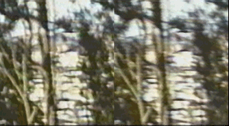

    I'm trying to capture some old (analog, 8mm camcorder) video tapes - and although it's technically working, the quality is terrible. Please help.
    Years ago, when I last did analog video capture, I had a dedicated capture card ... but that stopped working when I got my current machine, so for this job I just purchased a Pinnacle Dazzle box. I'm already regretting it, but that's what I have for now.
    The first attempt (using Pinnacle Studio) was a disaster, so then I switched to using VirtualDub - and that's is what's essentially working.
    However, the resulting quality of the video image is really pore, with lots of interlaced lines not lined up. I'm attaching a screen shot that shows what I mean.
    In virtualdub, I have tried to adjust the capture pin, but the only settings that seem to stick are NTSC_M, 29.97, YUY2, and a size of 720x416. (I see 720x480 in the pulldown, but even if I select that it resets back to 720x416).
    Can anyone suggest what I might be able to do, to try to improve the quality of this image? I understand it's analog, and will never be HD quality ... but I've done analog capture before, and this is worse than I'm used to. Is the problem the Pinnacle Dazzle, or can anyone suggest anything else to try?
    Thanks in advance.
    [Attachment 58278 - Click to enlarge]

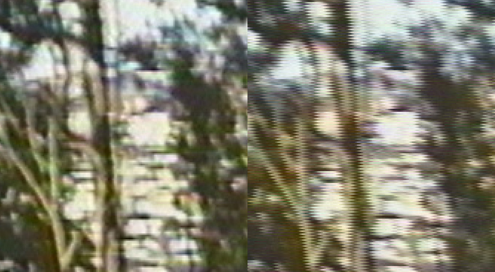

    I also have a question about the interlacing problem. Here are two images of the same frame of video, captured with two different devices. The left image was captured with a Dazzle USB, and the right was captured with a Hauppauge USB 610 ("Live2"). These image portions have been enlarged 3x, to highlight the differences. Note how the Hauppauge has really bad interlacing, even though it is supposedly a better unit:
    [Attachment 58287 - Click to enlarge]
    I am wondering if this might be a Line TBC issue. I have picked up a used Panasonic ES-15, to see if it cures this problem.

  5. Obviously, the original video was interlaced, and the Dazzle deinterlaces it on the fly during capturing, while the Hauppauge captured the source as interlaced and leaves it as interlaced. Of course the Hauupauge variant looks combed when you watch it on the progressive PC monitor without deinterlacing. This is as expected and not inferior. Upscaling interlaced video without prior deinterlacing gives a wrong impression anyway and damages the picture.
    I prefer interlaced lossless capturing (like with Hauppauge, using Huffyuv or a similar lossless codec), and make the deinterlacing afterwards using a good deinterlacer like QTGMC which will normally give a better final quality.
  6. Actually, it was not upscaled. Both were captured lossless, at the standard 720x480. I merely zoomed the screen image to 300%, to better show the combing (using screen capture).
    I don't think that the Dazzle is deinterlacing. I can apply a deinterlace filter to the Dazzle copy, converting to 60fps (59.94), and see discreet steps in each of the new frames. So, both fields are being captured by the Dazzle.

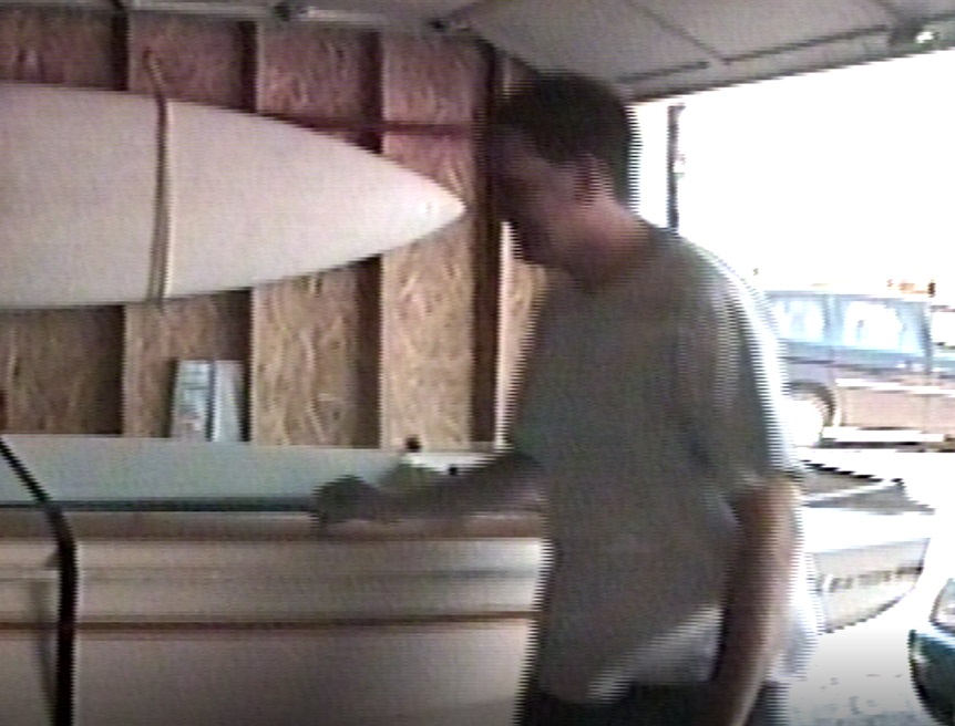

  8. Interlaced video contains two (half) pictures per frame. Deinterlaced video contains only one, unless it's deinterlaced properly.
    [Attachment 58297 - Click to enlarge]
