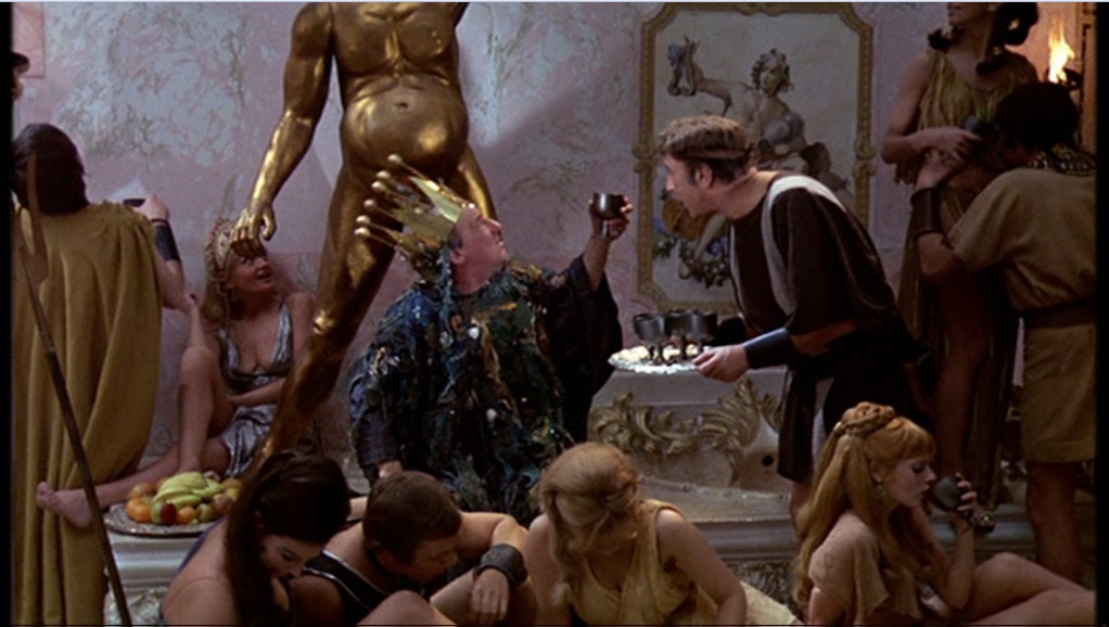

  1. Hi. I've attached a frame from the the 1971 movie Up Pompeii. One is from a 16:9 DVD and the other from a 4:3 DVD. The 4:3 DVD was a giveaway with a newspaper, in case you were thinking that it was a copy of the film made for ye olde tellys.
    I always assumed that 'films for TV' were the cinema versions with cropped sides but examining these stills has made me think. The 4:3 can't be a cropped version of the 16:9 because the 4:3 extends higher and lower than the 16:9. Similarly, the 16:9 can't have been 'made' from the 4:3 because the 16:9 has more to the left and right.
    The movie was filmed just the once so all I can think is that the original is as wide as the 16:9 and as high as the 4:3. Is that possible? If so, would such a version ever have been shown anywhere?

    If the imdb specs are correct, then neither image is totally accurate.
    I own both dvd's - the 4:3 from a double release and the later 16:9. The two attached images barr a pixel or two reflect how they are displayed in vlc - note the slight side bars to create the true 4:3 (768*576) and 16:9 (1024*576).
    The 16:9 was distributed at 1.77:1. Yet even removing the side bars you do not get back to 1.66:1
    So both have undergone some cropping. But the 4:3 is probably more accurate in the height.

    I also think that the two versions were created by different methods - telecine for one, scanning for the other.
    Mathematically, removing the side bars from the 16:9 version one is left with 996 pixels. If 1.66:1 is accurate (or is it an approximation ?) one would find 600 vertical pixels. Or 24 more than we currently have. But I do believe there are more than 24 pixels difference. For me hard to determine since there, to my eyes, appears a slight vertical 'squashing' in the bottom image when compared with the top image which itself could be down to the transfer method.
    Oh. And the 16:9 version runs for 17 seconds longer than the 4:3

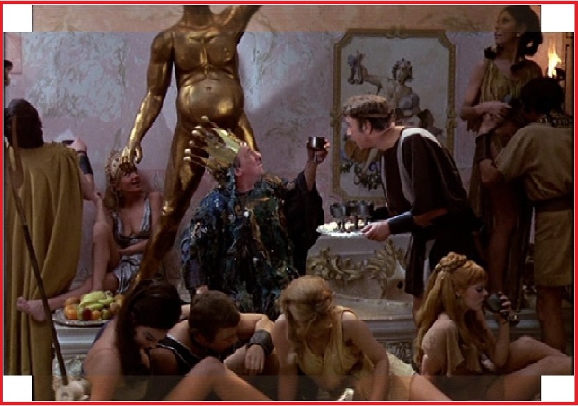

  9. Capturing Memories dellsam34's Avatar
    Jan 2016
    Fusing the two frames together with minimal adjustment, this is what the original aspect ratio might have looked like:
