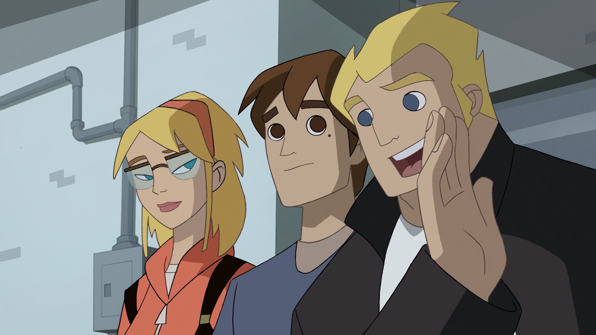

  1. This Blu-Ray I'm working on has a weird halo issue where it looks like multiple lines of halo's side by side. I have tried a combination of dehalo filters and had no luck in fixing it.
    Here are some screenshots.
    https://forum.videohelp.com/images/imgfiles/k0U8uja.png (It seems to be visible everywhere in this image)
    https://forum.videohelp.com/images/imgfiles/CIm68bY.png (Very visible on the Blue and Grays)
    https://forum.videohelp.com/images/imgfiles/Tl5XEEM.png (Orange on her shirt has it easily visible)
    https://forum.videohelp.com/images/imgfiles/H78lKkU.png (All of the red areas have it easily visible)
    What would you suggest as a fix if this can be fixed?

  2. What would you suggest as a fix if this can be fixed?
    as long as it's for simple anime/cartoon: MiniDeen
    (try 5x5 radius)
  3. While that does appear to be helping, it also appears to be smearing lines and other things from DNR. It's also making banding worse. I tried regular deen as well, and it also helps, but the DNR is smudging things just the same.

  4. Originally Posted by killerteengohan View Post
    Anything that "denoises" will cause banding on this type of cartoon in certain areas. On the 1st pic, on the dark areas of the jacket - notice a dither or grain pattern in the original. If you denoise and remove that - that will usually become "splotches" and a form of banding
    If you want to reduce the halos, but minimize softening of the picture, you can use waifu2x with mild denoising settings and line preservation. Line preservation is a major aspect in what it was trained for.
    Model 1, Noise 1 works ok. I ran it twice with bicubic . waifu2xcaffe works well in vapoursynth if you have a nvidia card. There are other methods, other GUI's that can use waifu2x too, some with vulcan . I'm not up to date on all the waifu2x variations, but there are dozens (outside of vapoursynth too) . The only thing you should avoid is waifu2x with avisynth. It's not optimized at all , about 100x slower . If you choose to go this route, you'd generally want to dither or add grain or fix the areas that were denoised that left banding
    [Attachment 58219 - Click to enlarge]

  5. I know how to fix the banding, and I know that's a side effect of DNR, that's not really a problem. The problem is the DNR is destroying the image in certain scenes or spaces.
    Look what it's doing to the image when looking out the cars back window.
    https://slow.pics/c/ntz5fjuS (Flip through images with keyboard arrows or mouse click)
    Entire lines are disappearing off buildings, and the DNR is too strong. I like how it cleans the halo lines I wanted cleaned, but it's being too destructive.

  8. Try this:
    #ImageSource("k0U8uja.png", start=0, end=23, fps=23.976)
    ImageSource("unknown_27069.png", start=0, end=23, fps=23.976)
    ConvertToYV12()
    lmask1 = mt_edge(thy1=10, thy2=10, mode="0 0 0   -4 8 -4  0 0 0") # vertical edges
    lmask2 = lmask1.mt_edge(mode="0 0 0 1 1 1 0 0 0") # expand horizontally
    lmask2 = lmask2.mt_edge(mode="0 0 0 1 1 1 0 0 0") # expand horizontally
    lmask2 = lmask2.mt_inpand().mt_expand().mt_expand().mt_expand() # inpand to remove lone dots, expand some more
    lmask = Overlay(lmask2, lmask1, mode="Subtract").Blur(1.0).Blur(1.0).Blur(1.0).GreyScale() # protect original lines
    Overlay(last, MiniDeen(2), mask=lmask)
