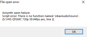

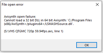

    I have tried LWlibavVideoSource, but I'm getting errors when trying to open in VirtualDub 32 & 64.
    Pic on left is when using VirtualDub 32, right is 64
    Image Attached Images
  26. On the left: The function is LWlibavAudioSource(), not LibavAudioSource(). On the right: you are trying to load the 32 bit dll into the 64 bit version of AviSynth.

    Thank you everyone. Sorry jagabo I was burnt out last night and didn't catch the typo in the audio portion of the script. Once corrected the script opened and is working!
