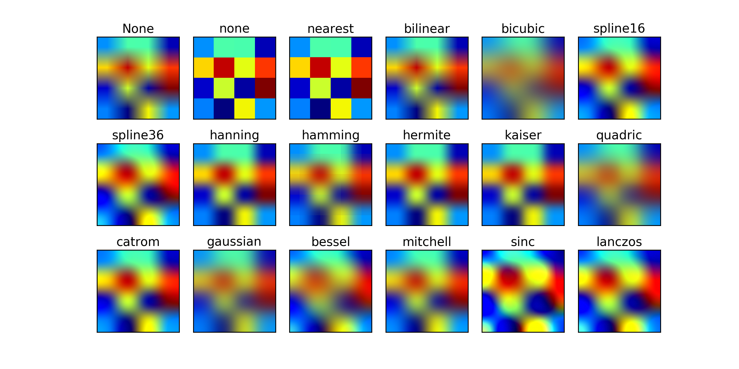

    Software upscaling uses different algorithms, some are better than others with things like interpolation and thats what causes details to be lost to things like fuzziness or blur when upscaling. Here is a small example of what some of the different methods look like.
    [Attachment 58160 - Click to enlarge]
    Neither hardware or software is better than the other persay because internally they all use the same math, how ever things like A.I. are a game changer when it comes to upscaling because it can predict what an image should look like when upscaled.
    How are images being upscaled usually?
    Image upscaling algorithms solve the task of filling missing pixels that contain information during the image enlargement process. The most common is a bicubic interpolation.
    This method doesn't draw any details. It just simulates new pixels from the values of the surrounding ones using a formula. It works fast enough and looks more or less appealing to the human eye comparing with big chunky "pixels" created by more straightforward nearest neighbor or bilinear interpolations.
    Images upscaled this way do not contain any "new" detail and appear blurry because of the formula which tries to find a tradeoff between pixelization artifacts and smoothing. There are several different bicubic kernels that may have different results for different kinds of images. But in general, they act the same.
    There are more advanced algorithmic methods.
    E.g. widely used Lanczos interpolation or even more complicated fractal interpolation methods. They try to make out and preserve edges with borders on the image but all of them lack generality. In their focus is to find universal mathematical formulae to deal with different content and texture, and not to add much meaningful detail to the upscaled image to make it look realistic.
    Moreover, bicubic and any other algorithmic interpolation do not help with the image compression artifacts like JPEG blocks, even worse - it enlarges them and makes more visible.
