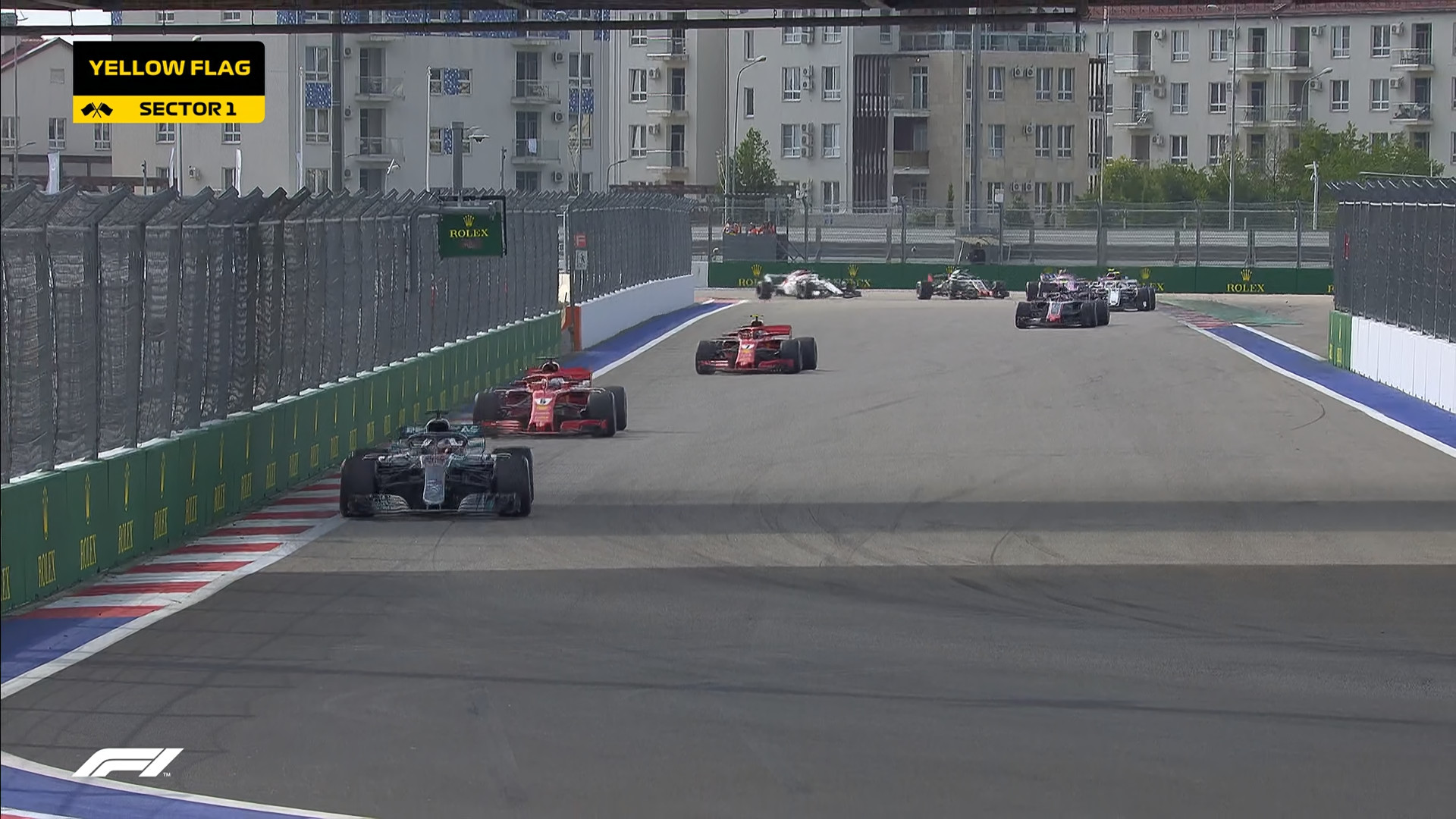

    OK, here is one minute source sample as attachment. First stutter is around 5 seconds when Ferraris drive towards the camera and there's more to come whenever camera stops moving. I tried to encode this with slow QTGMC and x265 presets at crf20, but that doesn't seem to affect the stutters although encoding runs only at 2 fps then instead 3 fps of medium preset. I also checked that one stutter frame by frame in mpv and almost all frames look fine but in wrong order with cars moving backwards four times within short interval and also skipping frames forwards. However, I found a couple frames with messed up car detail and attached screenshot of one, so maybe QTGMC assumes that's some still frame when camera stops panning and enters some wrong mode to cause stutter. Hopefully this sample helps someone know why such stutters happen and how to fix it because otherwise I'm quite happy with the quality. My settings may still need some refining, though, but this is my first attempt with x265 and some help with settings would be great.

    Actually, my earlier encode with QTGMC medium doesn't have that messed up car detail in the attached screenshot from slow encode although frame order is similarly faulty. So likely the problem happens before some extra processing in QTGMC slow messes up the car detail.

    I used the default FFVideoSource and no extra parameters anywhere because this is my first attempt. I just had to move ConvertToYUV420() in the script after QTGMC to fix chroma issues. Anyway, I attached my log file from slow test encode with sample and screenshot I posted here. After some more comparison of single frames I couldn't really see any improvement from slow QTGMC except somewhat sharper detail and messed up car detail during stutter that both I don't really like. Maybe QTGMC medium is better for me then because fine detail disappears anyway in motion and I don't want to sharpen imperfections of onboard footage. However, I noticed some glitches in crf20 encode compared to crf18, so maybe I should just use crf18 with higher bitrate because source has so high quality (up to 27 Mbps first generation encode for some seasons) and I'm trying to compete with quality of later 4K races. Hopefully I can somehow fix those stutters and maybe improve deinterlacing of thin almost horizontal lines because otherwise result looks nice already.
