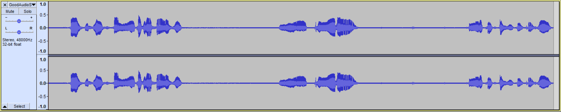

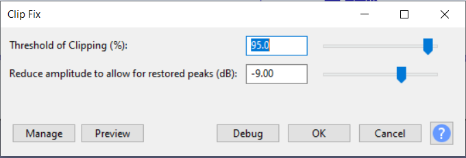

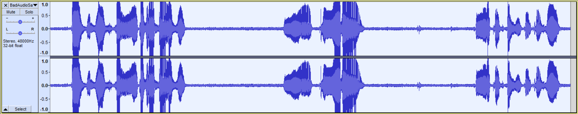

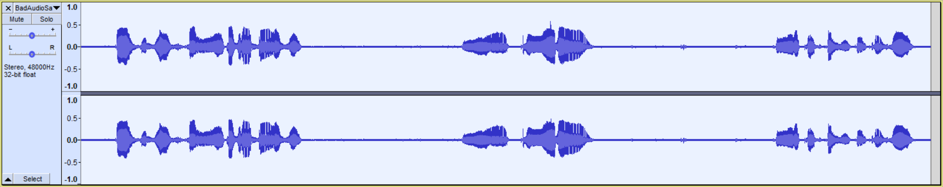

Just for curiosity, I extracted the audio from VideoWithBadAudio.avi and VideoWithGoodAudio.avi - refer to the attached files BadAudio.wav and GoodAudio.wav. Using Audacity, I applied a Clip Fix Filter (see Figure 4) to the BadAudio.wav, resulting in the attached file BadAudioRepaired.wav, which does not have any buzzing. Figures 1, 2 and 3 below show the waveforms for BadAudio.wav, GoodAudio.wav, and BadAudioRepaired.wav, respectively. Of course, this is a process I would do just as a last resort.

Figure 1: BadAudio.wav waveform
[Attachment 58112 - Click to enlarge]
Figure 2: GoodAudio.wav waveform
[Attachment 58113 - Click to enlarge]
Figure 3: BadAudioRepaired.wav waveform
[Attachment 58114 - Click to enlarge]
Figure 4: Clip Fix Filter in Audacity
[Attachment 58115 - Click to enlarge]
That's what's called audio level clipping, When your source level is higher than the input is capable of, This can be fixed by lowering the audio level in the capture card's audio properties.

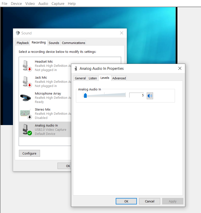

I tried to reduce the levels for the capture device (Diamond VC500 card) using VDub>Audio>AudioMixer. It was originally set to 54 and I made various captures reducing the levels to 45, 40, 30, 20, 10, and (finally) 5 but all of them still had the clipping problem. I also tried my Hauppauge 610 capture card but did not get any options to set the level of that device.
Is this what you recommended me to do? I wonder if I am doing something wrong.
Below I attach a picture of the Property page where I set the Levels for the device.
[Attachment 58145 - Click to enlarge]
Thank you
