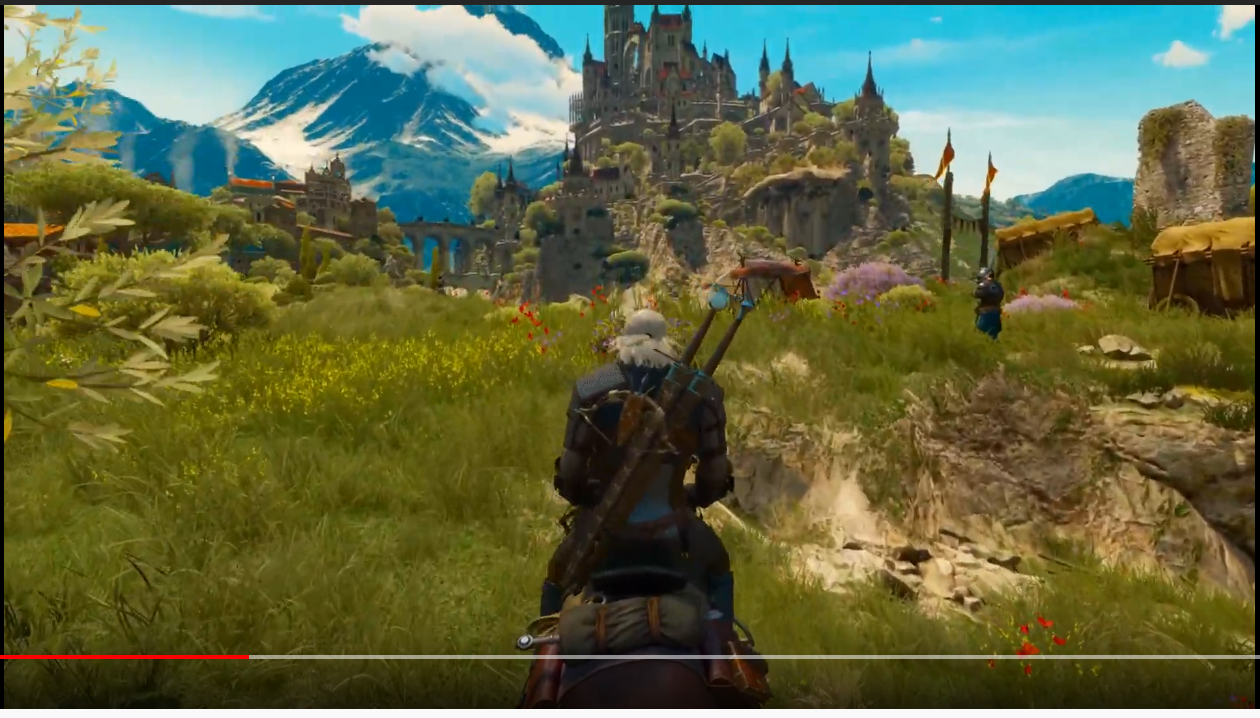

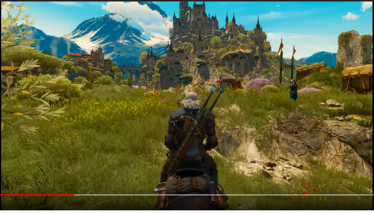

    Here is the screenshot of the video on youtube
    https://imgur.com/a/uZTK2KM#VrPUVG9
    Here is the screen of the rendered and ready to upload file
    https://imgur.com/a/qbNP6f4#VQPPm6f

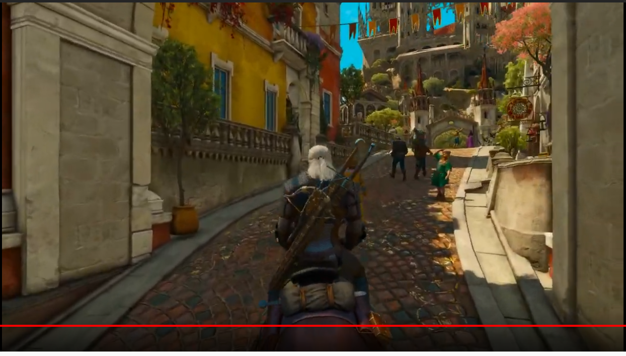

  9. I took a 1280x720 starting video. I upscaled one to 1920x1080, one to 3840x2160, both scaled using spline36resize, all 3 used libx264 crf 18.
    These screenshots were viewed in the cinema mode on a 1080p display, which scales it to smaller viewing area. I cropped roughly to the active image area for the screenshots, It ends up being close to 1280x720 active image area (a bit smaller)
    The first is the 720p version with the 720p version selected for playback; the 2nd is the 1080p with 1080p selected, the 3rd is the UHD selected version
    There is no added detail . I started with 720p. The 1080p and UHD versions look soft before I uploaded them. There is nothing special going on with the upscaling algorithm. It's all in how youtube allocates more bitrate to the higher resolutions and how it's downscaled for the display by the YT player
    There is a large difference in detail retention and artifacts. The UHD version looks almost like the original local 720p version
