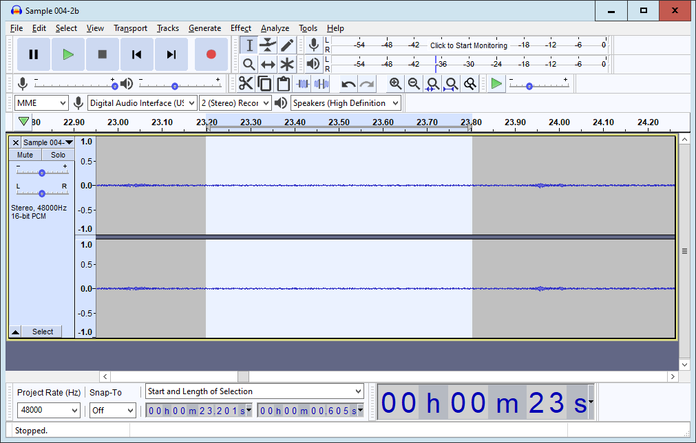

    1) I found a silent (other than the whine) section at 23.2 to 23.8 seconds and highlighted it:
    [Attachment 58030 - Click to enlarge]

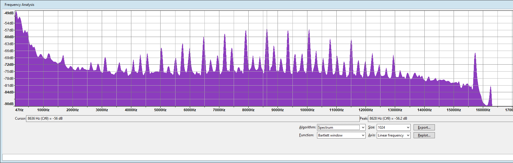

    I then selected Analyze -> Plot Spectrum:
    [Attachment 58031 - Click to enlarge]
    You can see there are many big, evenly spaced, frequency peaks from about 4000 to 13000 Hz., and another one at 15750 (and many smaller ones which I ignored). When you move the mouse cursor over the plot the program shows you the frequency of the nearest peak. In the image you can see that the frequency of the biggest peak in the middle is 8628 Hz. I used that feature to generate a list of those peak frequencies.
