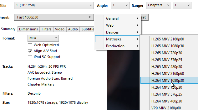

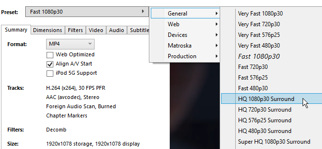

    Is this correct?
    [Attachment 58000 - Click to enlarge]
Name:	SnagIt-24032021 155652.png
  4. You're source is 1080p50. So 1080p50 h.264 would be better if your player can handle it. Some old players cannot in which case 1080p25 or 720p50 should work. That preset will work but you'll have to go to the Video tab and force the frame rate to 50 or 25 or "saem as source". I also recommend selecting Constant Frame Rate there.

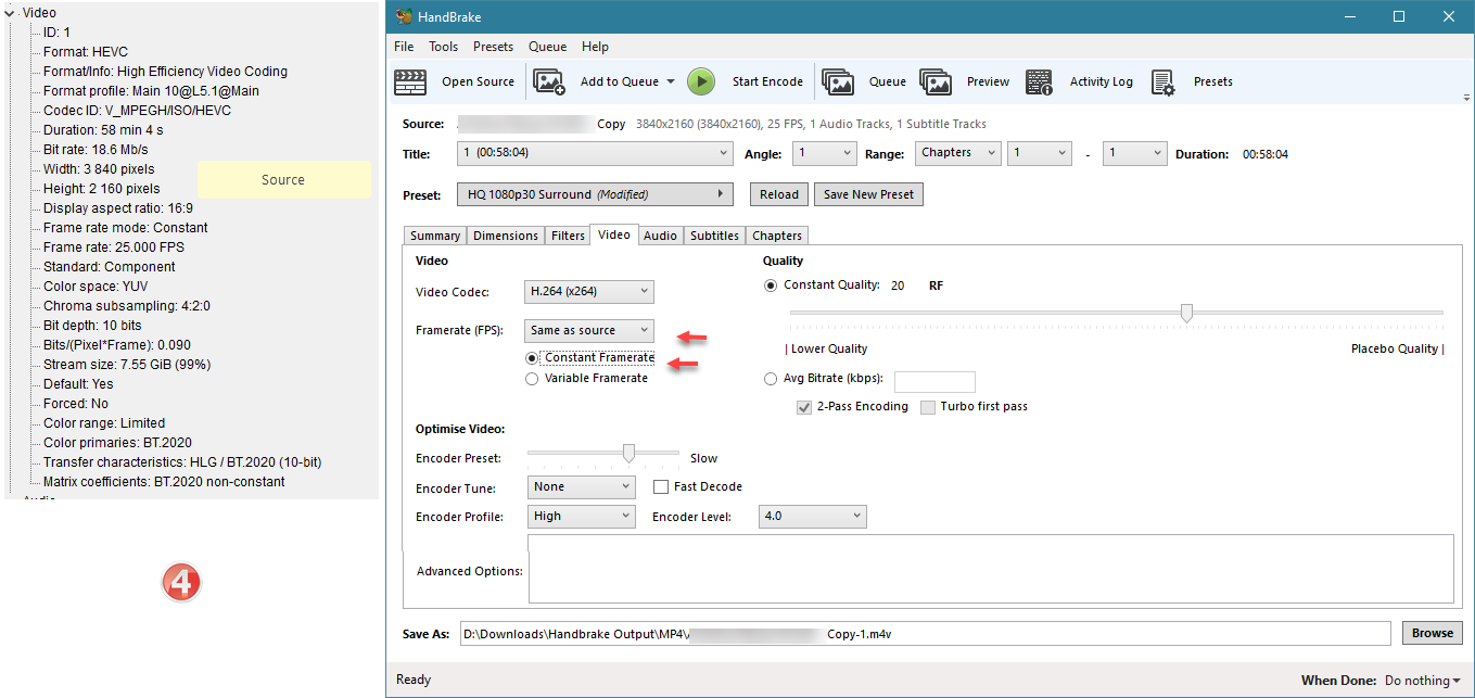

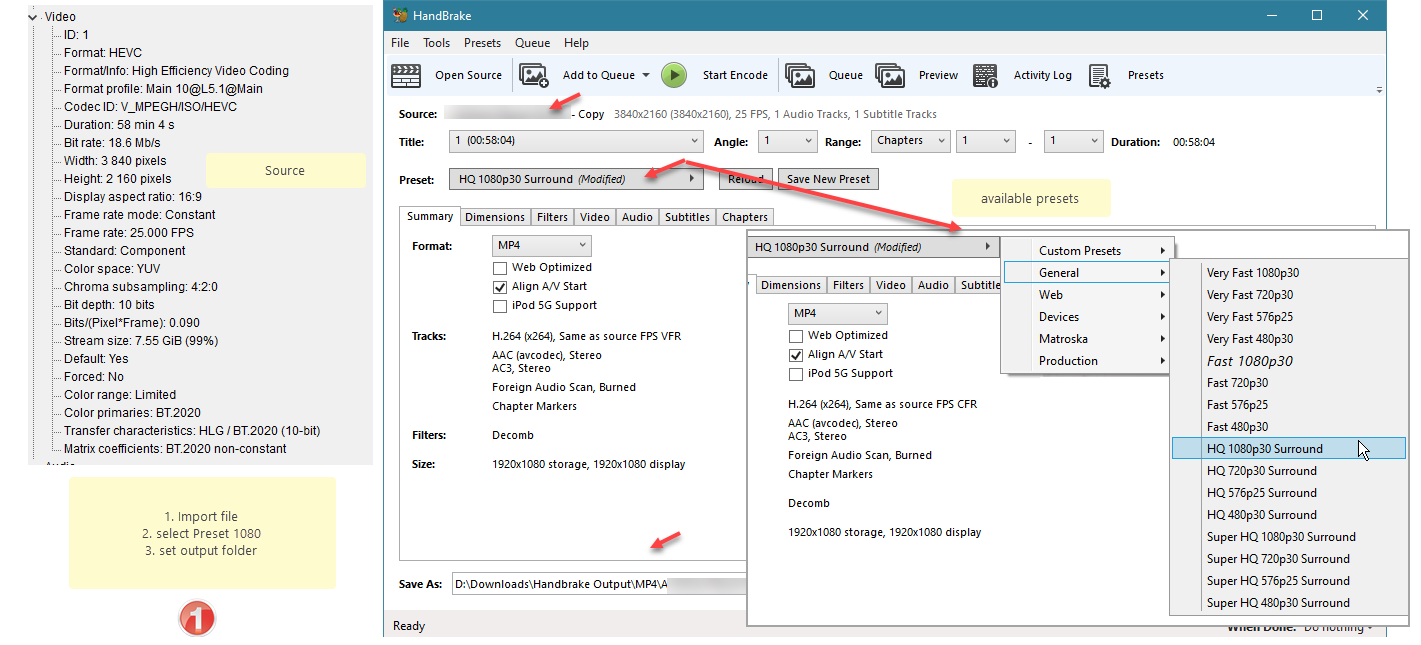

  6. Handbrake - I want to convert H265 to H264 (MP4)
    I believe the below settings are correct?
    If not, any suggestions to improve it.
    Note, all settings within Handbrake remained unchanged.
    I wonder why extension .m4v is selected instead of .mp4 ?
    Thanks.
    [Attachment 58981 - Click to enlarge]
    [Attachment 58982 - Click to enlarge]
  7. Those settings should be fine. You can set RF higher (smaller files, lower quality) or lower (bigger files, higher quality). And the slower you set the Encoder preset the better the quality/size (going beyond slow (slower, veryslow, placebo) might gives some devices (some Blu-ray players, for example) trouble as the number of reference frames and consecutive b-frames may exceed their ability. Set Encoder Tune for the type of video may help a little too. Film, Animation, and Grain (retention) are the ones you care about.

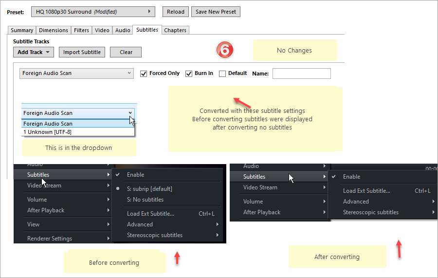

  9. Sadly, I still have one question... subtitles disappeared after converting
    1. before converting, dutch subtitles are displayed by default
    2. after converting no subtitles
    What am I doing wrong?? Should I 'tag' Default?
    [Attachment 58990 - Click to enlarge]
  10. Turn off "forced only". Have you verified that "foreign audio scan" actually has subtitles?
  11. Unfortunately, Handbrake has an annoying enforced default of creating .m4v files when the source file is .mkv (despite selecting .mp4 as the output format). There is nothing you can do to over-ride this, aside from manually re-naming the file extension as you have done.
    The .mp4/.m4v formats do not support soft subtitles (that you can turn on or off at will). So Handbrake and other similar utilities will usually default to omitting most or all subtitles contained in the original HEVC .mkv file when creating the .mp4/.m4v. You have two options for subtitles with .mp4/.m4v: tell Handbrake to encode them permanently in the video (always visible), or use a utility to pull the subtitles out of the .mkv and create a separate .srt subtitle file. If you want them always-visible, you need to choose which subtitles: HEVC files often contain multiple sub languages (as many as thirty). Depending on the video, some of these might be "forced " (i.e. required for a few scenes spoken in alternate languages). It can be difficult to figure out which is "forced" and which is "standard" unless the file has them named correctly internally. You can only choose ONE subtitle set to be permanently visible in the .mp4, so choose carefully.
    If you prefer the subs to be switchable, or need more than one language for different people, you'll need to extract each subtitle you want from the HEVC .mkv to coordinate with your 264 .mp4. Name the extracted subtitle file EXACTLY the same as the video file, and keep it in the same folder as the video file. Most software and hardware video players will recognize the subtitle file and automatically play it with the video. You will also be able to turn the subtitles on or off this way with the player controls, also you can select different languages if you have multiple .srt files for this video. If you don't want the extra effort of extracting subtitles from the original .mkv, you can look for ready-made .srt files for your videos on several subtitle enthusiast websites and download them. Note you would need to choose the version that matches the exact name of your original .mkv file.
    Converting HEVC to more-compatible 264 is a time-consuming nonsense task for most of us. Wasting a couple hours tying up your computer to convert a file, only to get mediocre results that lose quality, is not the best way to go. It would perhaps be better to buy a newer media player (or BluRay player with HEVC file playback feature) and stay with the original HEVC files. While I personally loathe the HEVC format precisely because it breaks broad compatibility, more and more of the wirehead geeky tech-obsessed people who create video files are moving to HEVC. Often you can still find 264 alternate versions along with the HEVC, but this option will slowly disappear and HEVC will take the field over completely within a couple years (just as they switched en masse from mp4 264 to mkv 264 format overnight a few years ago). Sooner or later you will be forced to get a newer HEVC-compatible player (or TV).
  12. mp4/m4v do support soft subs. But they must be in the right format, Apple's Timed Text format. ffmpeg will convert SRT to TT on the fly when remuxing. I don't know about handbrake. And any SRT formatting will be lost.

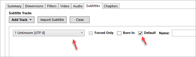

  13. Thank you both!
    I gave it another try and succeeeded this way ...
    [Attachment 59014 - Click to enlarge]
    Subtitles showed up nicely.
