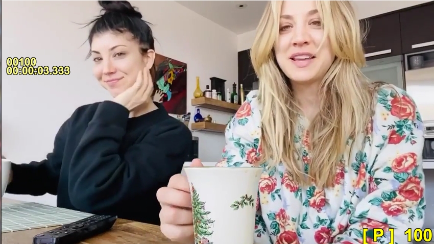

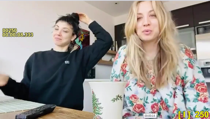

    @Jagabo... What level FFMpeg are you using? When I try your script on a 250 GOP, it freeze frames with image from frame 250, until the next I frame of original at frame 250. I have found this to be the normal action of every FFMpeg version I have used. Am I doing something wrong?
    Frame 100 from original:
    [Attachment 57986 - Click to enlarge]
    Frame 0 from the cut video:
    [Attachment 57987 - Click to enlarge]
    Frame 250 from original:
    [Attachment 57988 - Click to enlarge]
  6. Originally Posted by Budman1 View Post
    Yes, you're doing something wrong: you're using the batch process on an inter-frame codec. To do that you will have to reencode (you can't use (-c copy"). The OP is using an intra-frame codec, all i-frames, so that's not a problem for him.
    It should work fine for UT Video Codec and other all-i-frame codecs.
  7. Member Budman1's Avatar
    Jul 2012
    NORTHWEST ILLINOIS, USA
    Ahhhh. Very clear explanation as your usual . It
    make perfect sense now. Great explanation. Thanks.
