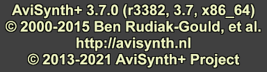

Start with a simple script like:
Open it with VirtualDub. That will show you something like this:Code:Version()
[Attachment 57966 - Click to enlarge]
If you see that you know that AviSynth and VirtualDub are working. Then go on to more complex scripts and come back when you have specific questions.
