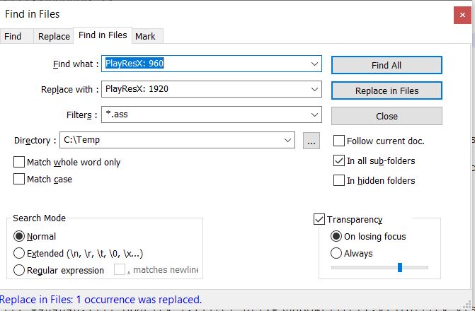

  2. Perhaps not quite a batch job but you could do it with 5 Search in Notepad++ provided the subtitles are in the same directory.
    First you use Search -> Find in Files to "Replaces in Files" to replace PlayResX and PlayResY as shown below.

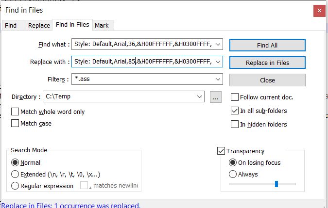

    Next you replace the Style definition from the original file with the definition in one of the 5 you have resampled, eg below.

  3. Originally Posted by videobruger View Post

    Thank yo so much for the help. Although yes it might not be quite a batch job like you mentioned, it still did the work. I edited one set of the subs and styles with Aegisub and made it the way I wanted it to be. From there I did as you said and used Find & Replace for each line of style I wanted to edit separately and also changed the resolution and all. I've only checked a few of the subs with Aegisub and they seem to be fine. Will update if I run into any issues, but I highly doubt it. If find and replace returned less number of successful replaced texts eg 130 of 147, I would then check the unedited by sorting by modified date and replacing the text in those files since not all of them had matching styles formats for the styles I wanted to edit.
    Honestly again thank you and take care
    UPDATE: 23/03/2021 @12:05PM
    So it worked sort off but then because the adjustments made when you resample the resolution the correct way were not pplied meaning that the other unedited styles eg for signs still remained in their position for 540p meaning they were out of place for the 1080p video so I am back to manually resampling the resolution for each sub file.
