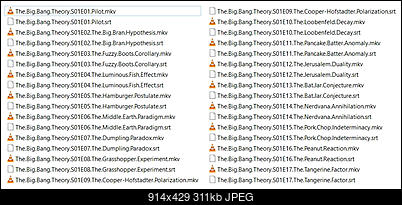

  1. Does anyone have a batch script for windows that will use ffmgeg to find the matching subtitles of multiple video files in one directory then remux the matching .srt files into the corresponding video files.
    As you can see in the image below I simply need a batch script that will remux all the matching .srt file into the same video into a separate sub-folder.
    Thanks for any help!!
