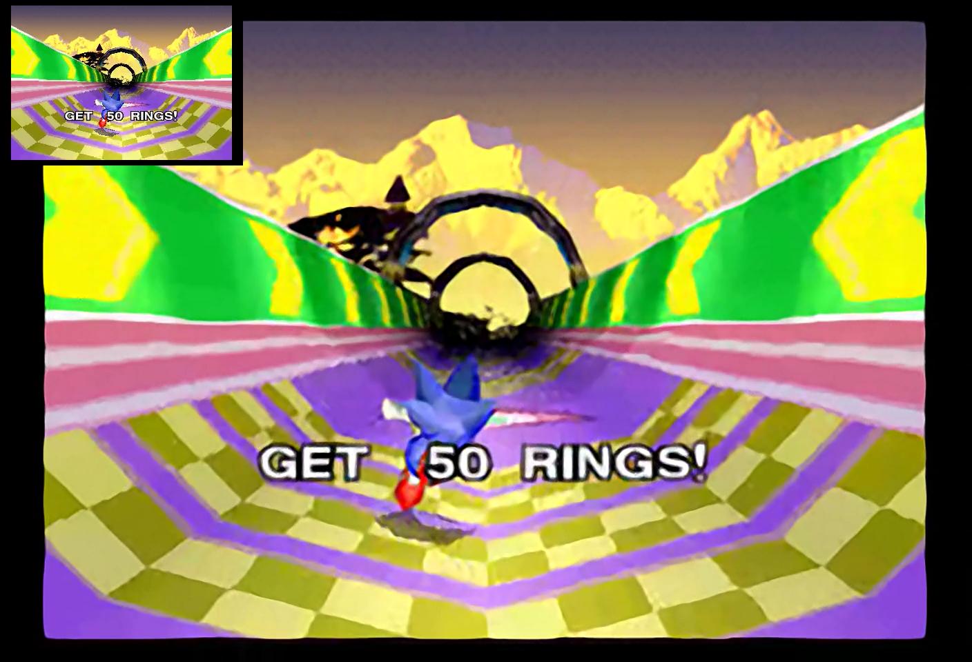

  2. That bitrate looks rather low for a capture master. Use a high a bitrate as you can stand if you're going to use x264, crf 12 or less, crf 0 (lossless) if you can. At least you used 4:4:4 chroma. I would avoid resizing while capturing. It's best to avoid multiple resizings.
    Can you post a sample?
    May 2016
    Lithopolis, OH United States
    Here is the sample.
  4. As I suspected that video has lots of compression and resizing artifacts. If you can, avoid resizing and use better quality compression. A better source would give smoother edges and an overall cleaner picture.

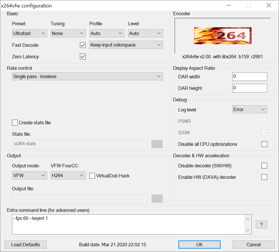

  6. Since you're already using x264 -- set it to crf=0 -- that will give you lossless encoding. And disable the resize filters -- capture the emulator frame pixel-for-pixel.
  7. Lone soldier Cauptain's Avatar
    Jan 2006
    Brazil
    Hi Guernsey
    All current emulators have a video capture engine (I use Retroarch for 95% my captures).
    As Jagabo said, use the X264. My configuration is above:
    [Attachment 57945 - Click to enlarge]
    For resize you have 2 options:
    1 - Use some editor like Virtualdub + Avisynth filters
    2 - Use upscale from emulator Retroarch using shaders like xbr, xbrz (recommended) or nnedi3 and already record in upscaled mode.
    Claudio
    May 2016
    Originally Posted by Cauptain View Post
    Hi Guernsey
    Claudio
    Can this configuration apply to most x264 codecs? Or just the new ones?
  9. Originally Posted by Guernsey View Post
    That dialog is specific to x264vfw, but all x264 encoders have those settings.
