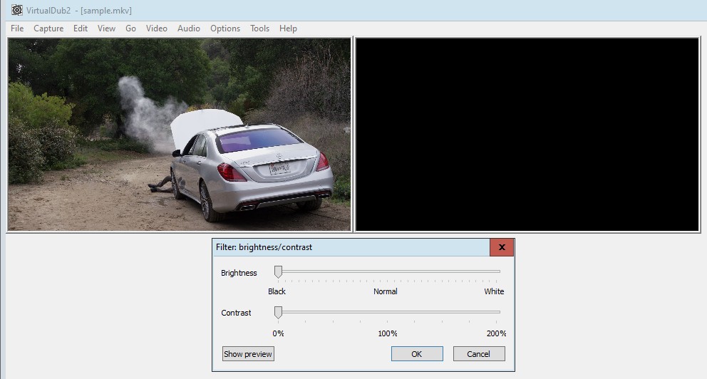

To create a black video add the Brightness/Contrast filter and set both sliders all the way to the left.
[Attachment 57961 - Click to enlarge]

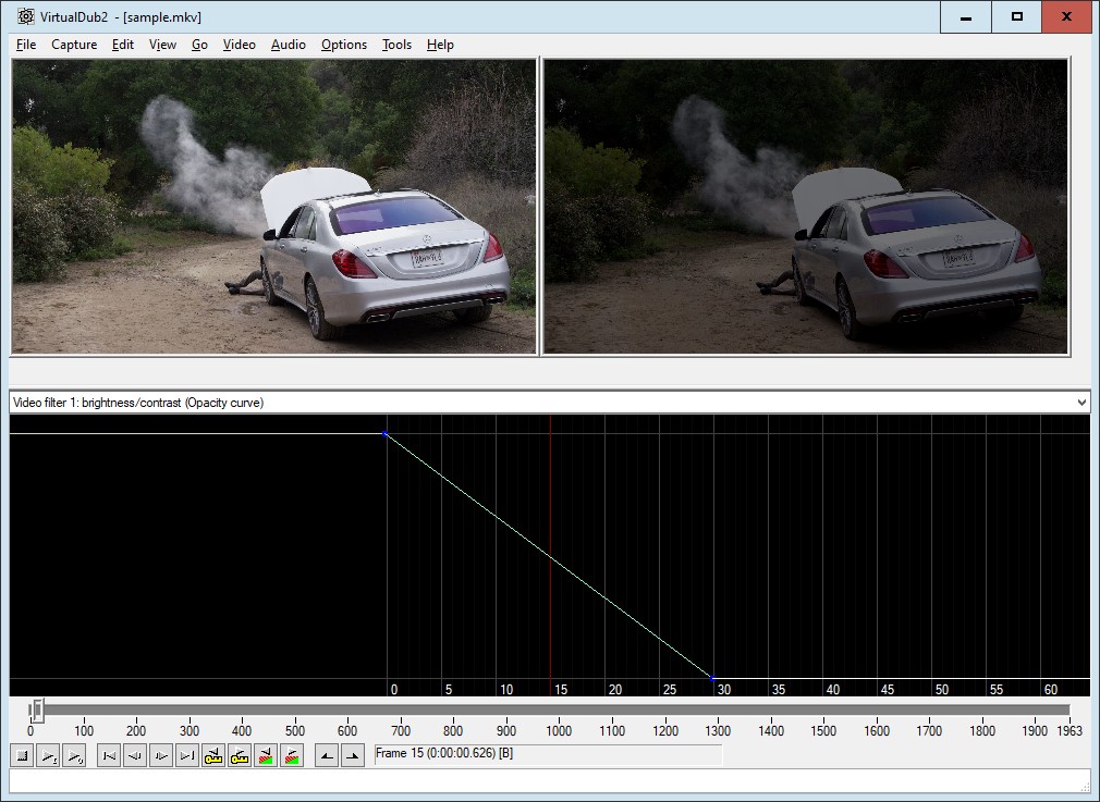

Enable blending on the Brightness/Contrast filter on the main video -> Filters... dialog. Set the mode to Apply Opacity Curve. Back at the main VirtualDub interface select View ->Curve Editor. Make a curve (follow the on-screen hints) that starts at 100 percent and ends at 0 percent over the numbe of frames you want to fade in. Here's a portion of a curve that goes from 100 percent a frame 0 to 0 percent at frame 30:
[Attachment 57962 - Click to enlarge]
You can see that at frame 15 the Brightness/Contrast filter is only applied 50 percent.
