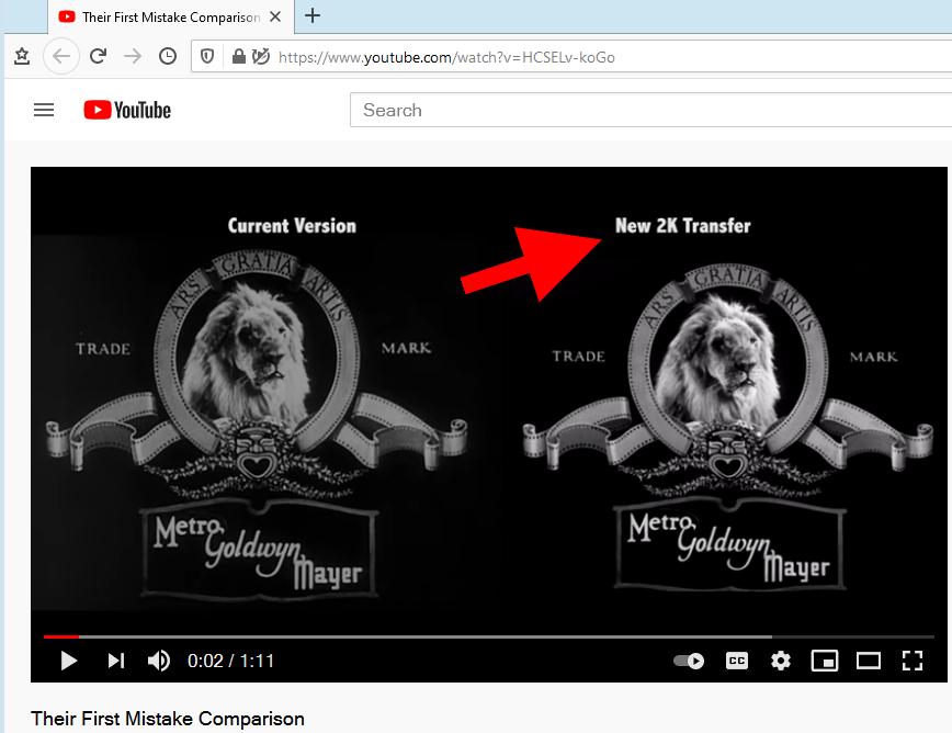

    Hey all, sorry if this has been asked before. I was wondering if it was possible to restore old Laurel and Hardy films? Specifically, I wanted to remove the flickering, cue marks, black spots, etc.
    Here's an example of the output I'm looking for: https://www.youtube.com/watch?v=HCSELv-koGo&ab_channel=jeffsabu. Image
    [Attachment 57892 - Click to enlarge]
    Does anyone know how I could do this? Thanks in advance.

  3. Originally Posted by spiyer99 View Post
    Why reinvent the wheel? The work has already been done and you already know that since your picture and YouTube link point to the restored version. Is this some sort of a troll post?
    https://www.amazon.com/Laurel-Hardy-Definitive-Restorations-Blu-ray/dp/B084P3S7NJ

    Thanks for sharing this. The output of your video looks incredible.
    But I'm using mac not windows. Could you upload your code to Github or Google drive or something like that?
    Not all the laurel and hardy films have been restored unfortunately (AFAIK)

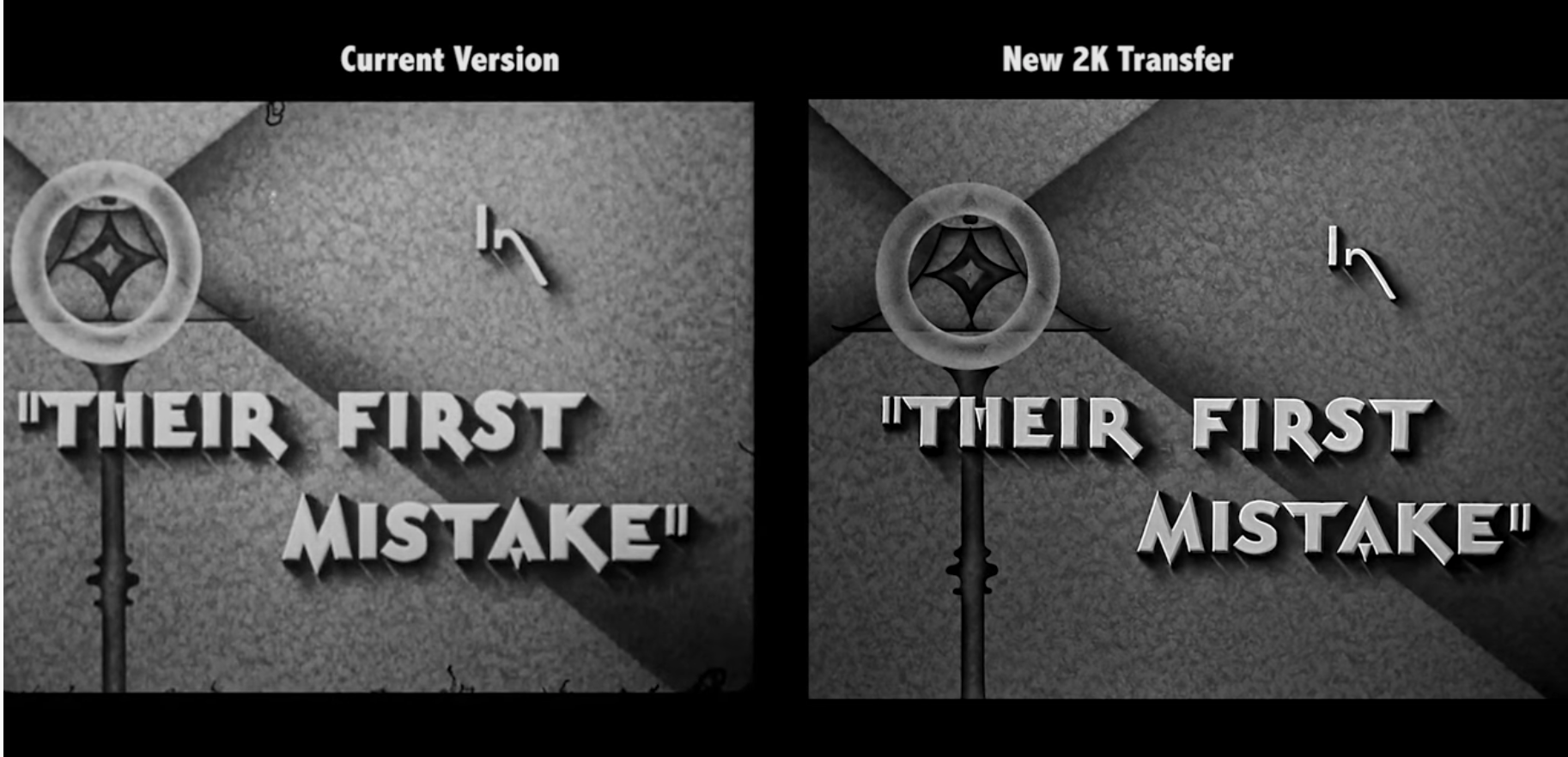

  7. Originally Posted by spiyer99 View Post
    Start by scanning the original film.
    [Attachment 57922 - Click to enlarge]
  8. My work is on AVISynth and my scripts are at doom9.org, as I already posted. I don't think you can run any of it natively on a Mac, but if you can load and run Windows (e.g., using Bootcamp) I think you can proceed.
