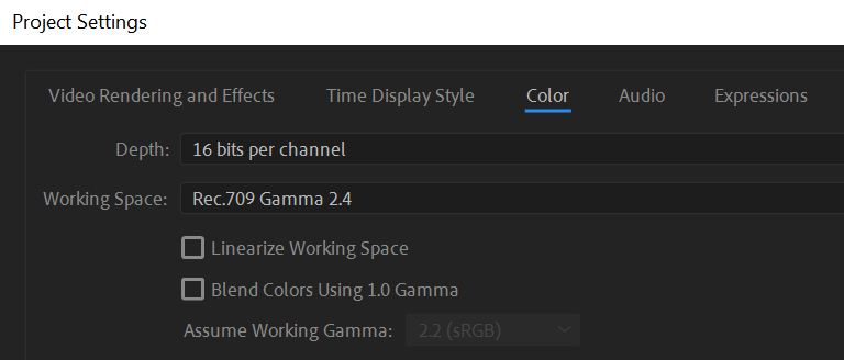

I'm exporting a ProRes 422 HQ video from After Effects with the Rec 709 Gamma 2.4 color space:
[Attachment 57887 - Click to enlarge]

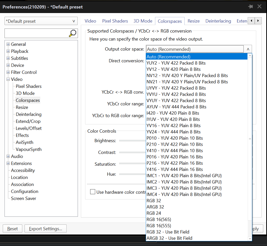

I checked the Output Color Space dropdown but could not find Rec 709 Gamma 2.4 as an option.
[Attachment 57886 - Click to enlarge]
Any idea on how I can get PotPlayer to display my content correctly? Thanks!

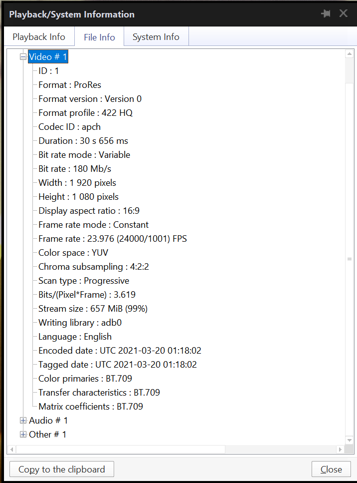

So, I did a little research and it looks like all versions of ProRes export YUV (ProRes 4444 can do RGB as well), so I do think Potplayer has to do a YUV to RGB conversion for my video.
Here's how Potplayer reads my export's color space.
Color Space: YUV
Color Primaries: BT.709
[Attachment 57948 - Click to enlarge]

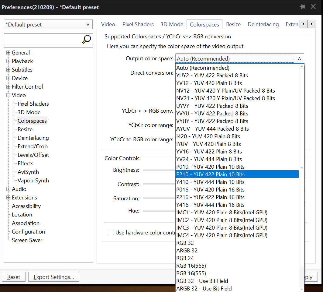

YUV 422 Plain 10 Bit sounds like the correct color space I should have Potplayer set to for viewing ProRes 422HQ material but that didn't make a difference. In fact, I couldn't get Potplayer to display my video differently no matter what Output Color Space I had it set to (it always looked the same, slightly too bright).
[Attachment 57949 - Click to enlarge]
Is this the same for everyone else? Does changing the Output Color Space actually make a difference for you?
Thanks!Last edited by ObjectNull85; 22nd Mar 2021 at 13:34.

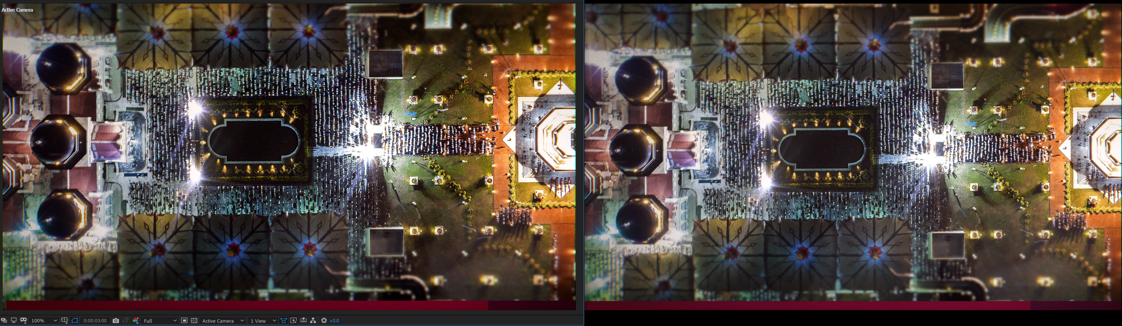

Here's an example of the brightening:
[Attachment 57953 - Click to enlarge]
After Effects is on the left, Potplayer on the right.
To me it looks like just a brightness change, not color, but it's hard to tell.

No, different programs may use different methods to get video to the display. For example, look in PotPlayer's Preferences -> Video -> Video Renderer. You'll see about a dozen different choices. Mine is set to auto and it picks "EVR Custom Present" when a video is played.
It's a little hard to tell because the two images are a different size and not the same frame. But I'm pretty sure it's not a rec.601 vs rec.709 problem. Potplayer's black level is elevated but the white level is the same -- so it's not a full range vs. limited range problem. What does Preferences -> Video -> Levels/Offset show? I have this:

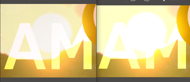

Here's an example of what VLC is doing:
[Attachment 57976 - Click to enlarge]
After Effects on the left, VLC on the right.
You can see the letters disappearing into the sun in the VLC version where in After Effects their outlines are still visible. -

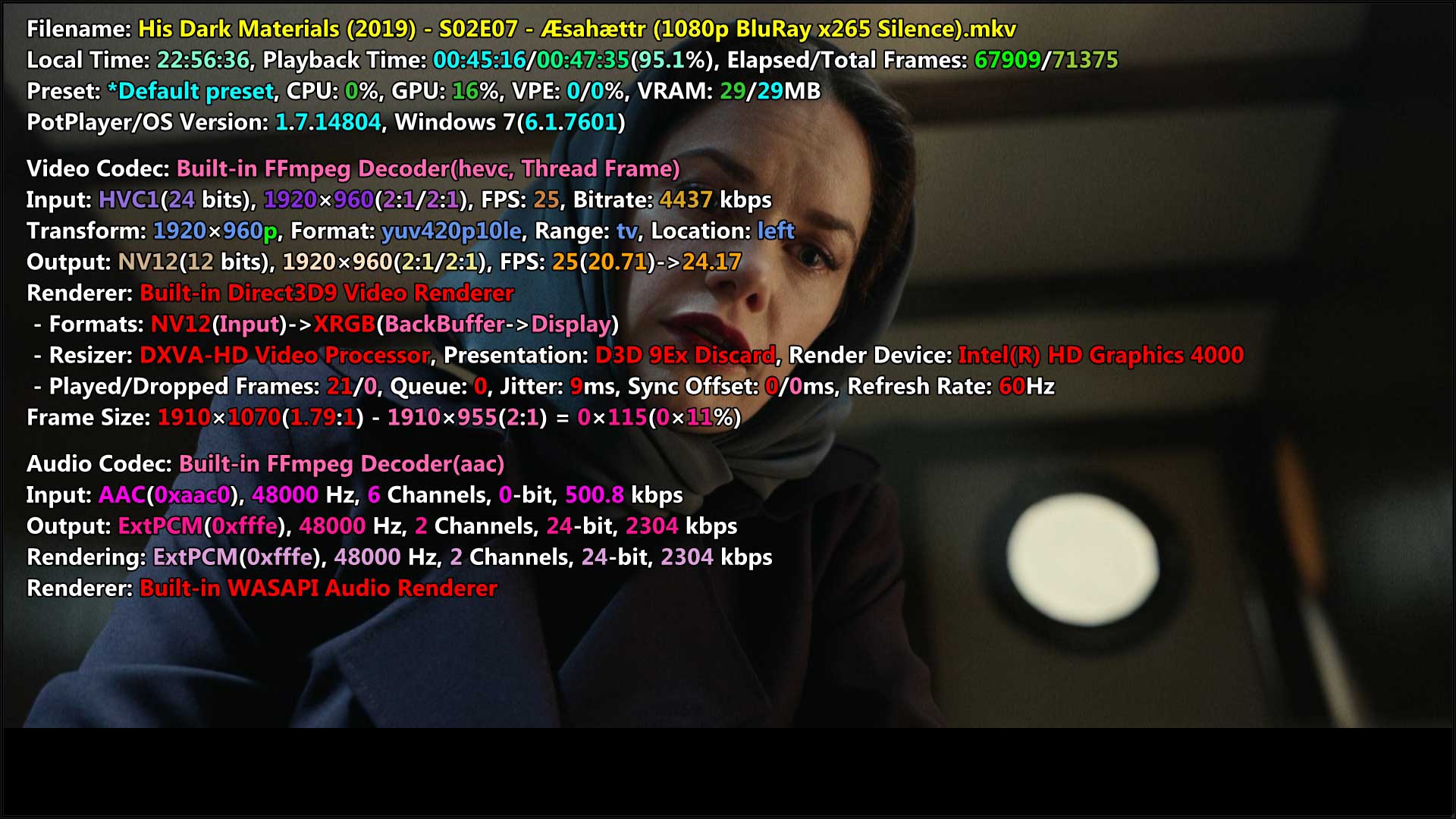

I had the same problem of PotPlayer displaying video as brightened. What fixed it for me was to:
1) Preferences > Video > Video Renderer to Direct3D 9.
2) Preferences > Video > Colorspaces > Output color space to NV12 (for 4:2:0 videos) or YUY2 (for 4:2:2 videos) or RGB32 (if the previous two dont work). (I have read the NV12 colorspace is often favored by video cards). (For some of my videos, I required RGB32 though).
https://learn.microsoft.com/en-us/windows/win32/medfound/recommended-8-bit-yuv-formats...ideo-rendering
NV12 is the preferred 4:2:0 pixel format for DirectX VA. It is expected to be an intermediate-term requirement for DirectX VA accelerators supporting 4:2:0 video.Any color space under the Video Renderer set to Auto used the EVR Custom Present renderer showed video as brightened.YUY2 is the preferred 4:2:2 pixel format for Microsoft DirectX Video Acceleration (DirectX VA). It is expected to be an intermediate-term requirement for DirectX VA accelerators supporting 4:2:2 video.

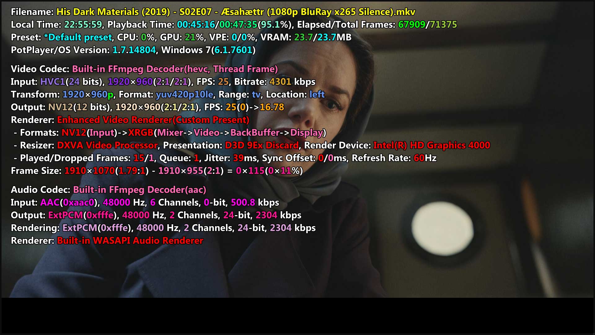

When you push Tab on the keyboard while playing video - it shows the renderer used. It also shows all the color spaces used in the render chain, showing it doesnt always obey what you have it set in Preferences.
EVR - too bright:

Direct3D9 with NV12 - correct colors:
[Attachment 83096 - Click to enlarge]Last edited by robertcollier4; 28th Oct 2024 at 01:39.
