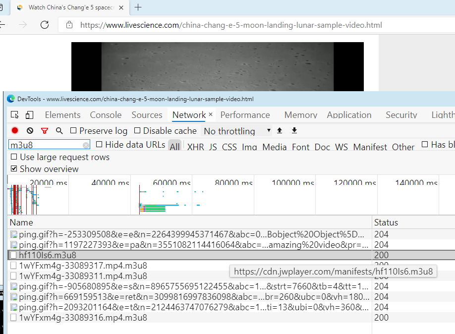

  6. If the video is already playing when you open Developer Tools it's too late -- reload the page with DT open. Or open DT before navigating to the page with the video.
    Here's MS Edge playing the video with DT in the foreground. You can see the m3u8 filter is applied and the m3u8 link in the list.
    [Attachment 57855 - Click to enlarge]

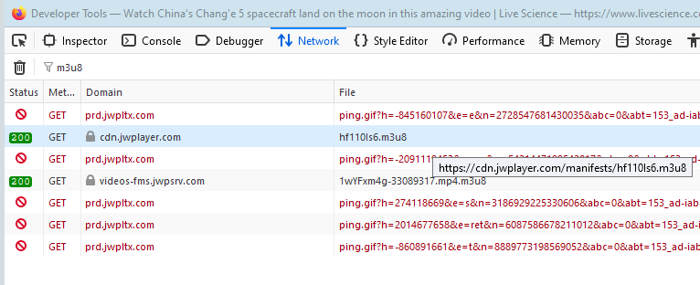

    And DT in Firefox:
    [Attachment 57856 - Click to enlarge]
    The m3u8 URL in those images might be permanent.
