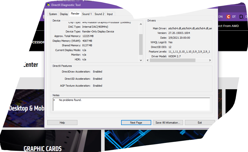

  12. 1. Yes. It was tried with both displays. That is just the screenshot I took. I am not sure what my monitor supports. I did notice that my tv would not recognize HDR sometimes (off YTube), that just involved restarting the TV to fix. However regardless of whether it was saying HDR, it still looked the same.
    What does AMD reading N/A for HDR verses Intel saying 'Not Supported" tell you? In video card properties.
    The video card properties confirm what I could find out using a search engine. An AMD Radeon R5 M335 doesn't even seem to support hardware-accelerated HEVC decoding. If that's true, it is very doubtful that it supports HDR10 passthrough. Although Skylake's Intel HD Graphics 520 supports hardware-accelerated HEVC decoding, it doesn't support HDR. Intel processor GPU support for HDR10 started with Kaby Lake's UHD Graphics 620 and UHD Graphics 630.
    [Edit]Neither of your computer's GPUs are adequate for playing UHD content with HDR10 passthrough. The Intel processor's HEVC decoding combined with a player that supports tone-mapping to simulate HDR might provide OK results.

    OK I am just going by what Dell told me. Don't you think that n/a is different than "not supported though?
    So do you recommend a new GPU? Do I only need one replaced? Or did Windows break this connection with the update so it does not matter? I am going to contact AMD, and I am at the moment dling updates for my gpu, so we shall see.
    Not in a meaningful way. HDR10 is tied to HEVC, which is very resource-intensive to decode using software, especially at UHD resolution. Without the ability to use hardware-assisted decoding for HEVC, HDR10 passthrough becomes N/A (not applicable) for the AMD Radeon R5 M335.

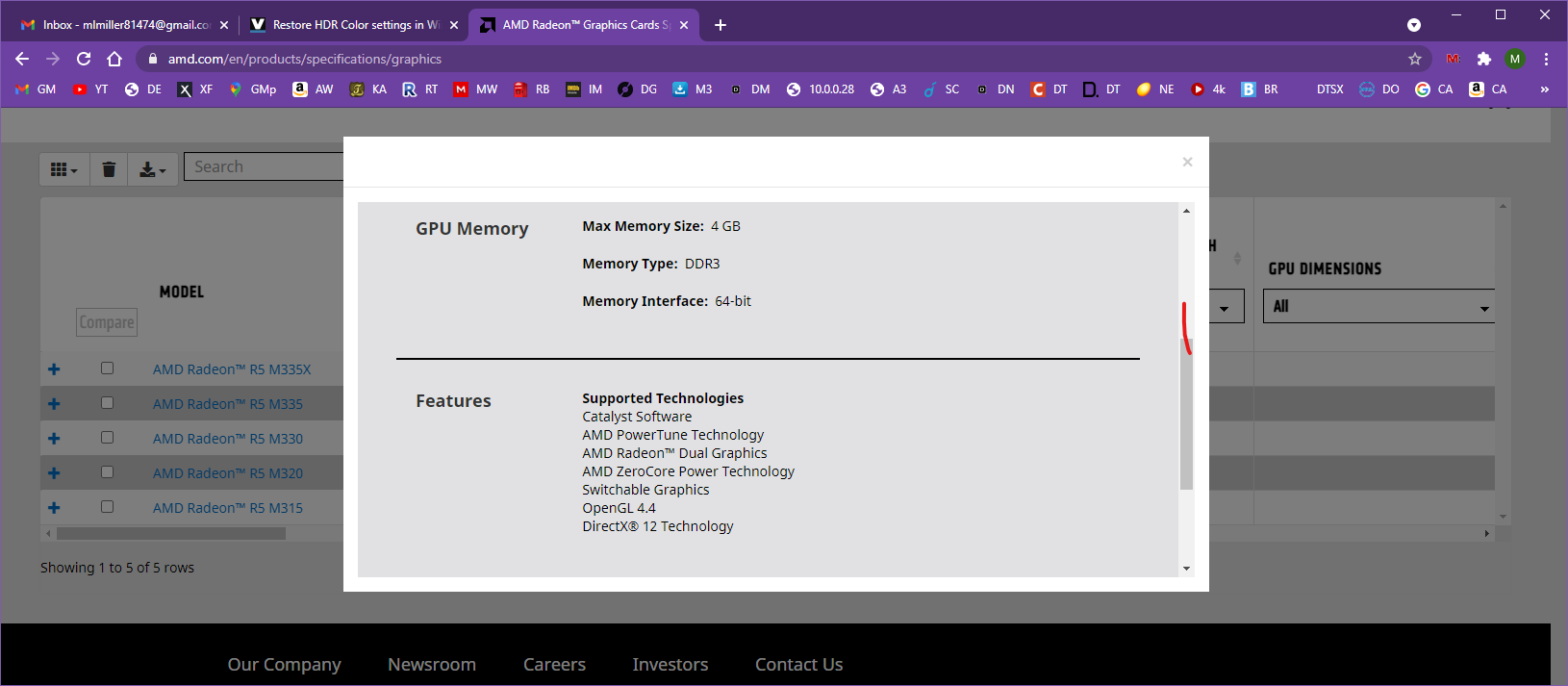

  21. Well according to AMD Please be informed that AMD does not manufacture RADEON R5M335 ,Radeon HD and Radeon RX series graphics cards. AMD is the manufacturer of the graphics chip and vendor’s such as Sapphire, Asus, Gigabyte, XFX, HIS, MSI, Power color etc. manufacture graphics card using AMD graphics technologies and customize the graphic cards as per their need and requirements.
    The specifications and features are decided by the GPU manufacturer and will vary from manufacturer to manufacturer .so I would suggest you to please get in touch with GPU manufacturer regarding your query as they can assist you better .
    So how do I find that out? Everywhere I look it says AMD manufacturers the card.
    what version of windows 10 do you have ?? - https://support.microsoft.com/en-us/windows/hdr-and-wcg-color-settings-in-windows-10-2...7-bbc6c5ef24e6
    Windows 10 Pro, other than that I don't know. Are you actually reading this thread, we are way past Windows versions and location of settings
    Google is your friend. There is information about the AMD Radeon R5 M335 posted on the Internet.
    There are specs at https://www.notebookcheck.net/AMD-Radeon-R5-M335.144861.0.html. It is described as a dedicated low-end mobile GPU, which indicates it is likely to be a chip soldered onto the motherboard.
    The specs say this:
    Features of the R5 M335 include video decoding for MPEG-4 AVC/H.264, VC-1, MPEG-2, and Flash directly by the AMD GPU. Multi-View Codec (MVC) and MPEG-4 part 2 (DivX, xVid) HD videos are compatible as well.
    The R5 series also supports automatic graphics switching between the integrated GPU and discrete GPU.
    The AMD Radeon R5 M335 doesn't support H.265 hardware-accelerated decoding or output at UHD resolution but users can switch to the Intel processor graphics. However, your Intel processor graphics won't provide HDR passthrough either.
    Intel HD Graphics 520 (Skylake processors) have support for HEVC hardware-accelerated decoding and output at UHD resolution. See: https://www.notebookcheck.net/Intel-HD-Graphics-520.149940.0.html However, Intel HD Graphics 520 don't support HDR pass-through. Support for HDR-passthrough wasn't added until the next generation of Intel processors, Kaby Lake, with Intel UHD 620 and 630 Graphics. Unfortunately, Kaby Lake uses a different socket and is incompatible with your motherboard, so you can't install one. I was wrong. They do use the same socket. However, I need to check chipset compatibility. Also, some mobile processors are soldered to the motherboard and can't be replaced, so I'd need the exact processor model number to find out if that is the case.
    Last edited by usually_quiet; 29th Mar 2021 at 16:54. Reason: punctuation, correction
