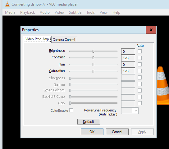

On adjusting the capture device's proc amp, how do I access those settings? -

It varies depending on the program and device you're using. In VirtualDub try the Video -> Capture Filter or Video -> Capture Pin. Maybe one of the Video Crossbar options. In VLC, after selecting the capture device, select the Advanced Options button. Tick the Device Properties option. When you press Start to start capturing you will then get the dialogs that let you configure the device. One of them will be the proc amp settings. The exact options vary but here's an example:
[Attachment 57831 - Click to enlarge]
Another way is to use GraphStudio. Insert the capture device filters (video capture, crossbar, etc.). Right click on the filters and select properties until you find the one with the proc amp. You can usually adjust the proc amp while previewing or capturing in another program -- for realtime playback. -
