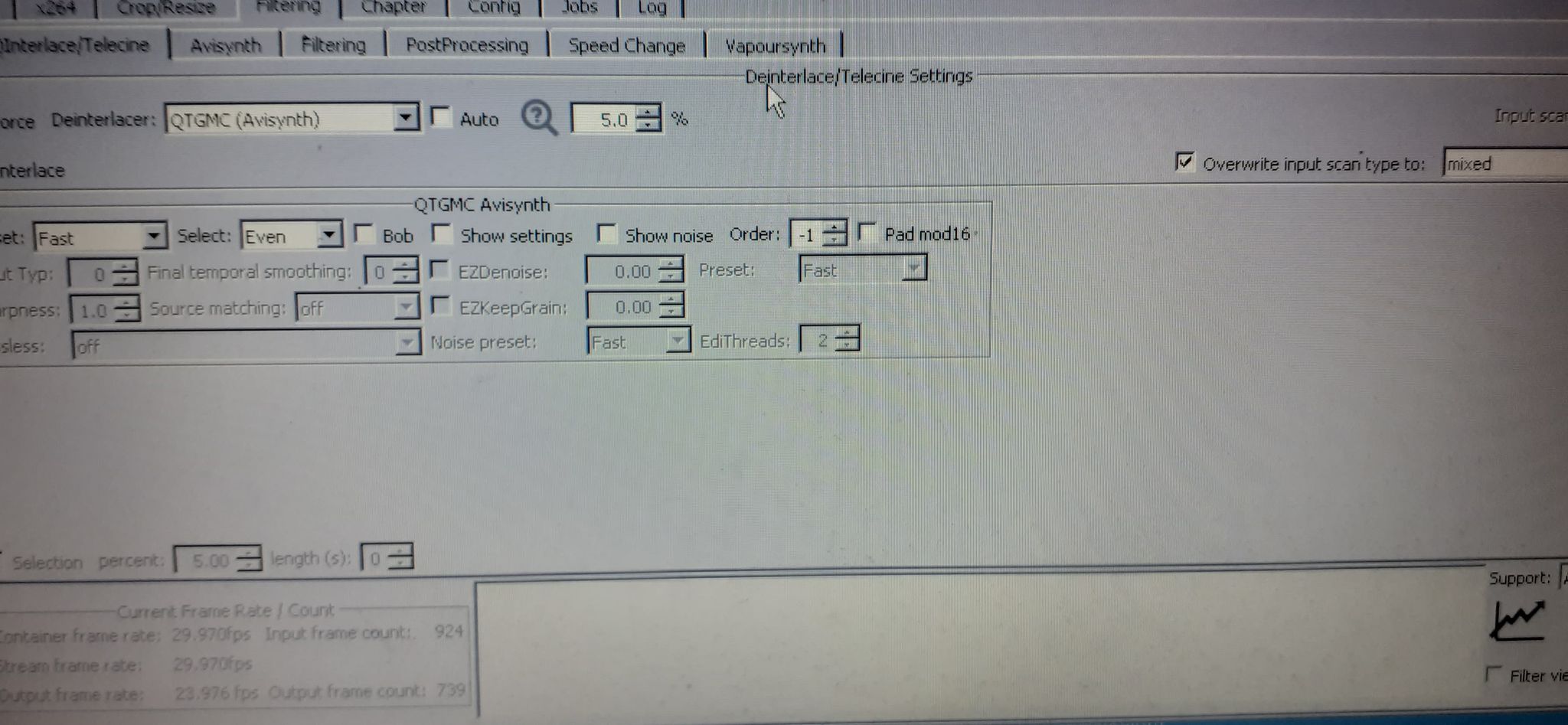

No, simple don't bob in QTGMC use it as same-frame-rate-deinterlacer and then use srestore after it.
users currently on my ignore list: deadrats, Stears555, marcorocchini -
You mean first QTGMC at 29.97 and then reload the output clip in hybrid and Srestore or this is order of filters , this is i don't understand...
So it's just the settings but i tried and the result it's not as good as with bob , i don't know if i do something wrong ,[ATTACH]
57907[/ATTACH]
[Attachment 57909 - Click to enlarge] i tested again QTGMC bob off . -
The "bob off" version is terrible, color smear and some frame rate stutter.

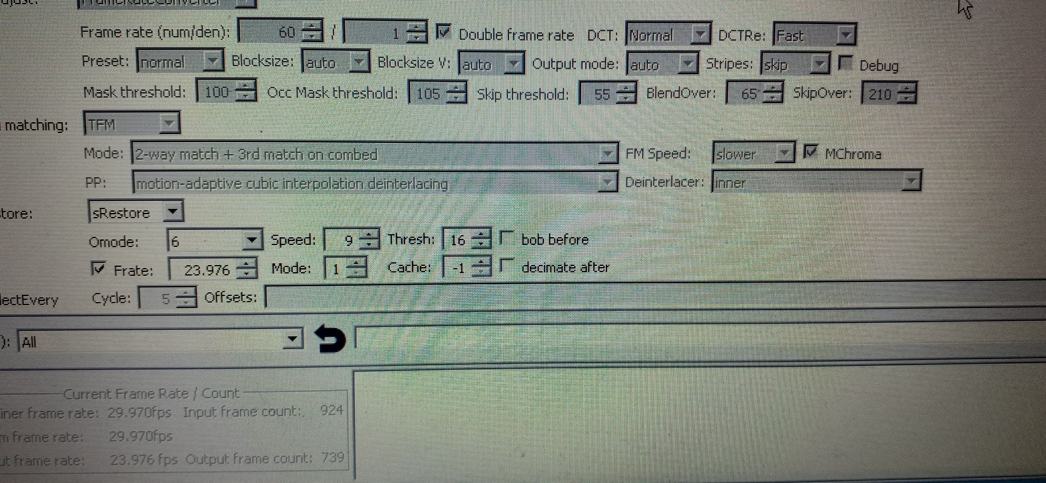

I wonder why with QFGMC and bob off result a 29.97 video shorter than original ( original video is 29.97 )with 6s and why Srestore don't work well when i try 23.976 but works when video is bob at 59.94 ? It's because have variable frame rate ?
Hybrid have a frame rate function similar with '' same as source '' ? -
a. If your source is from a DVD it's not vfr.
b. when sRestore is used Hybrid will decode to cfr
Don't mess with the frame rate and Hybrid doesn't change.Hybrid have a frame rate function similar with '' same as source '' ?
If the source if vfr by default Hybrid passes through the time codes unless a. a filter is used which only makes sense without them b. Hybrid is told to decode to cfr or c. Hybrid is told to drop the time codes.
Doesn't happen here.I wonder why with QFGMC and bob off result a 29.97 video shorter than original ( original video is 29.97 )with 6s
Input sample is 30s, reencode with QTGMC+sRestore also plays 30s here.
Wild guess is that you are doing something wrong.
Since you didn't share the calls, scripts etc. that were used or a proper debug output or describe in details what you are doing and this does not really have anything to do with a bug/error in Hybrid I'll leave this thread since everything meaningful seems to have already been said.
-> Wish you luck with processing your files into something that seems fine to you.
