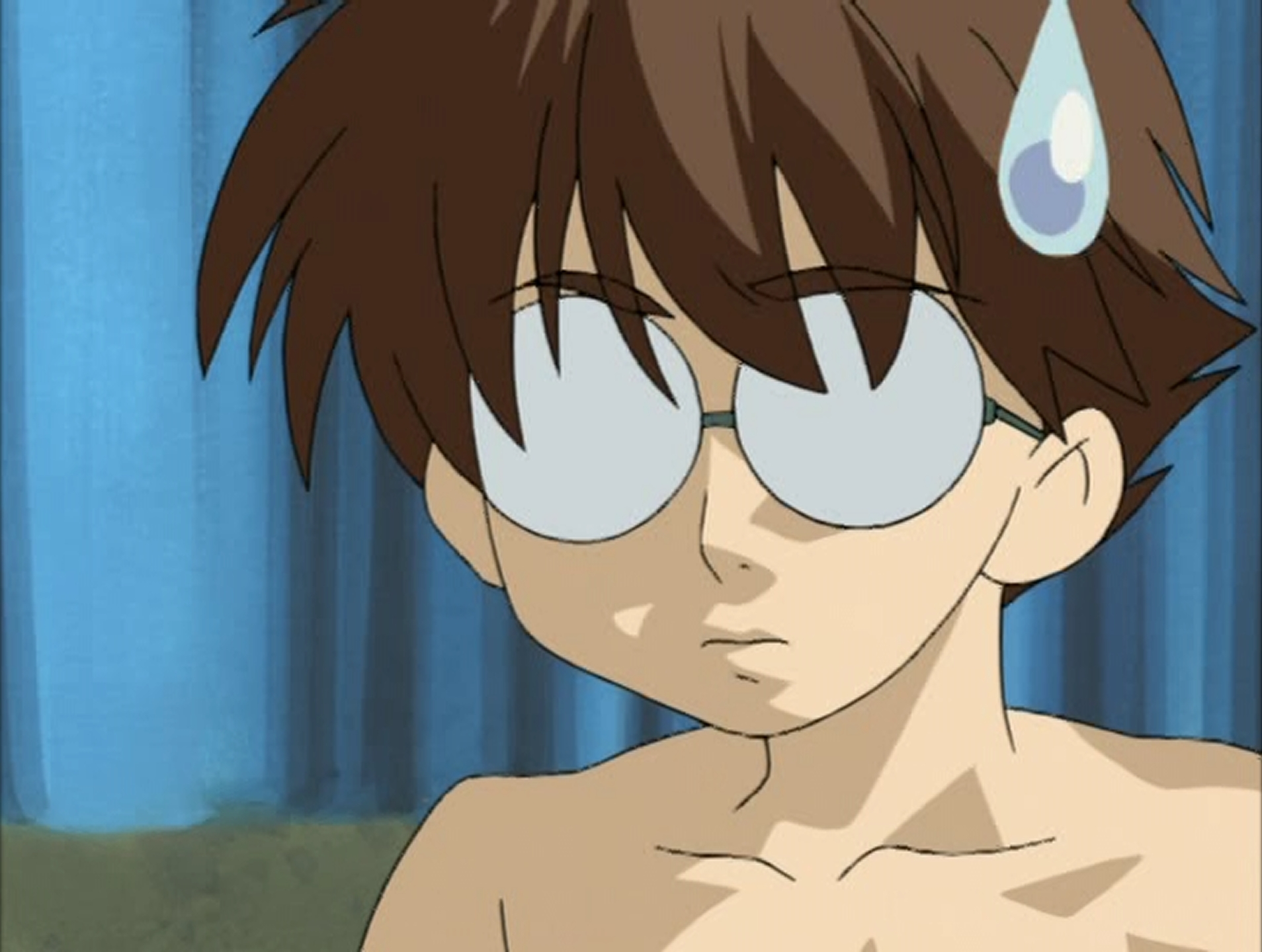

  1. I'm currently attempting to upscale my collection of old anime DVDs into 1080p using VapourSynth. It's going well, except I have the issue of very noticeable combing of originally non-combed lines post-deinterlacing. My process is to first use MeGUI to deinterlace before upscaling with Waifu2x-caffe. What I'm having trouble with is finding a code block for MeGUI that will decomb the lines that need it and leave the non-combed lines and non-ghosted frames untouched.
    RAW:
    [Attachment 57817 - Click to enlarge]
    Deinterlaced:
    [Attachment 57818 - Click to enlarge]
    Current MeGUI Code (Using QTGMC):
  2. Normally a cartoon or anime DVD should be IVTCed, not deinterlaced
    If you use QTGMC and SelectEven, the framerate will be wrong, playback jerky
    Did you try TFM and TDecimate ?
    If you have a tricky source, post a cut sample of the source
