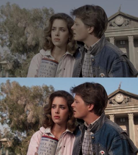

  6. HDR can look very bad if not converted to SDR for display on an SDR system. Here's an example of a bad conversion on the top, a good conversion on the bottom (originally 4K video):
    [Attachment 57908 - Click to enlarge]

  8. Member Seeker47's Avatar
    Jul 2005
    Yup, that effect definitely looks familiar.

  11. Originally Posted by Seeker47 View Post
    This might not be a good example...
    [Attachment 57959 - Click to enlarge]
    That sample is normal 10 bit SDR.
